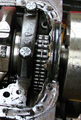

Does the timing chain look like this? as I believe this is a standard Duplex chain. /ubbthreads/images/graemlins/confused.gif
If you replace the timing chain and gearset. Be sure to save the old gearset for comparison to the new. The larger gear has to match exactly on the 351 or you will have rubbing problems and destroy your motor. This was not a problem on the 289 or 302s. This looks like the stock double roller chain.
