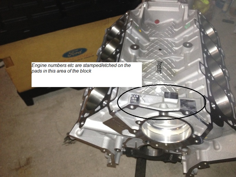

HERE!

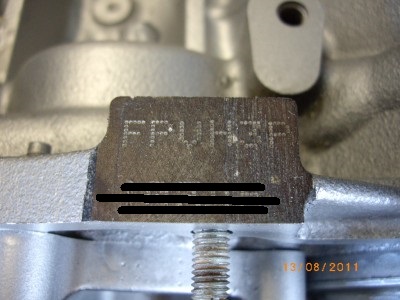

I'm not so sure as that looks like a date and time. 01 07 10 10:54 XX:XX
There is a number on the side of the crank case under the engine near the pan. it is XXX/XX/XXX in format. Any one have any ideas whether the "date" one is correct on top?
The pic I posted is a new bare block, presumably it had not been stamped with a vin type number, here is another XR8 block with what appears to be a FPV # from a cobra builders site, you might also check out post #'s 215 & 229 of your build thread as your pic has another partially obscured number in the centre of the valley also.
