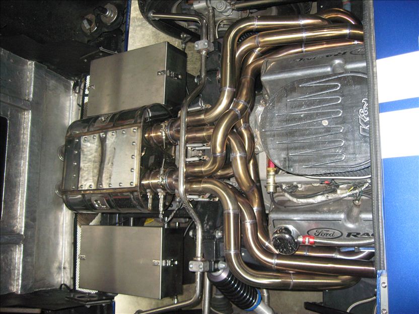

We have been checking both the plugs and the primary pipes for accessability and fit. The plugs on the original system were not easy to get at, it's no better but still possible. We did find that it was possible to tack up a pipe that could not be removed or fitted even if you are good at those infernal Chinese Puzzles

The system is now finished. The megaphone pipes and some extra quiet inserts are the next job.
I have had the chance to try the car on the road, the engine note has lost the flat beat I wanted to eliminate with much improved running especialy below 3000 rpm. The engine just feels more responsive and free reving with improved throttle response.
I think the conclusion is that it is well worthwhile ensuring that the primary pipes are equalised in length when laying out a new system and why not, if you can, include features like rotating collector pulses, anti-reversion features and smooth flowing collector construction.
It's not been cheap to do:- but worthwhile
Steve
