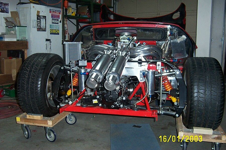

Howard Jones
Here's how it came out on my GTD.

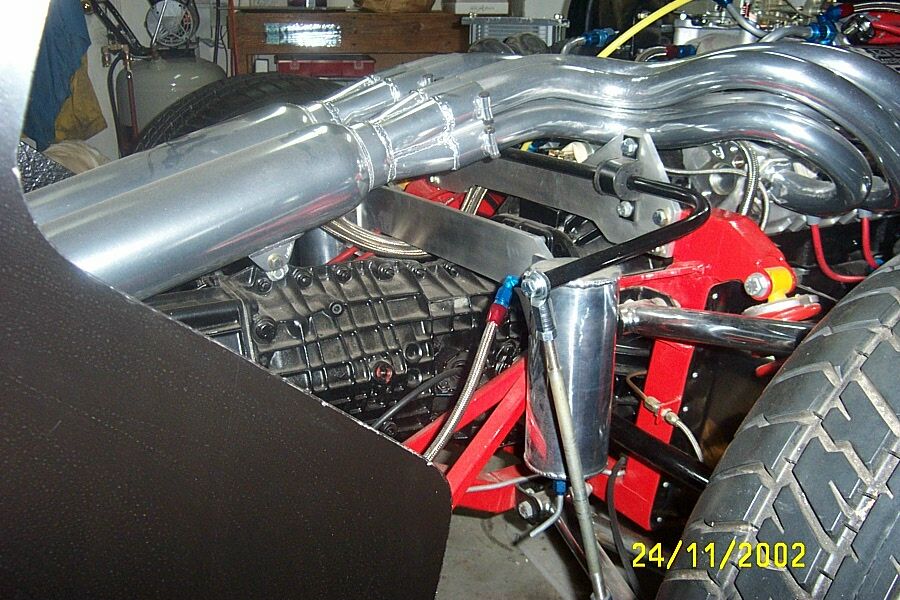

Brian Magee
Frank
Here are a couple of pictures of my Tony Law custom made system. I had to take the car to him. My car has a ZF and the engine has a 6 1/2" sump that sits flush with the bottom of the car. you can see how close it sits to the top of the gearbox.
Brian.

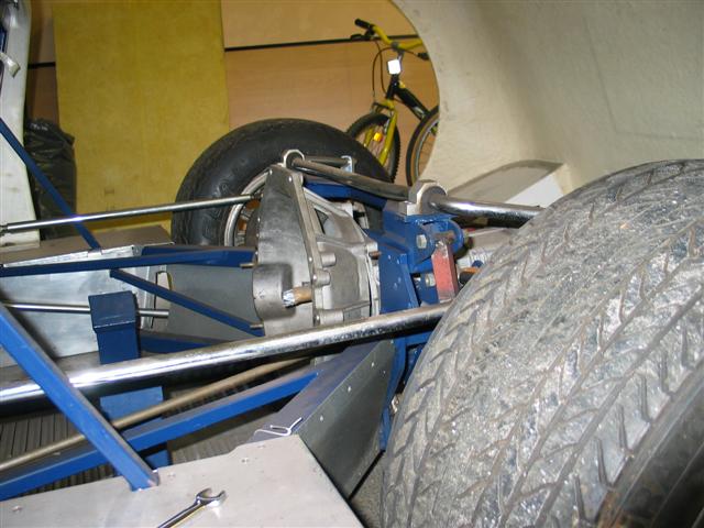

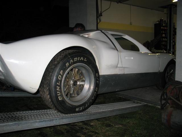

Sorry for the late reply
But I've got the car !!!
I picked it up yesterday
We drove all day to denmark and back again (total 24 hours ,could be on le mans )
So i did have a better look now and....
The exhaust is the least off my worries.
First i have to work on the fittings off the bodyshell
Some parts are to short at one side (they did cutt to much off ) /ubbthreads/images/graemlins/frown.gif
and otherparts does'nt seem to fitt to ,so thats the first thing to do and the exhaust come's later
Smashing foto's by the way i'll hope that mine will look as asome as your's
i'll try to putt some pics now
