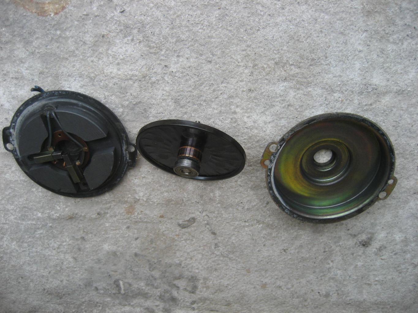

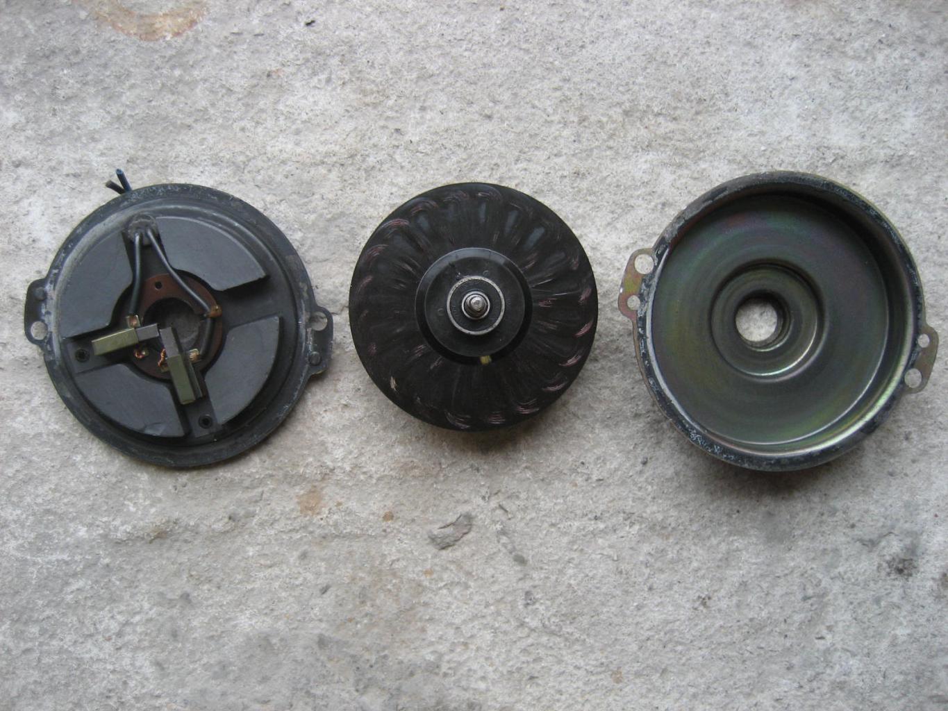

On the way back from the Oulton Park Gold Cup one of my radiator fans died. It was subjected to the usual English post mortem examination. It seems that a combo of a lot of carbon dust from the commutator brushes and a few scratches on the armature disc had allowed some unwanted shorts in the motor case which then blew 30 amp fuses in short order.

Anyway here are some pics of the inside of the old Spal fan which died after many years of hard use. The cause of the failure was the carbon dust from the brushes rubbing against the armature and then shorting the current to the metal case causing the fuse to blow and the fan to no go.
Anyway here are a couple of pics of the motor interior showing the 4 ceramic magnets, the disc shaped armature and commutator. When pulling one apart note that the steel case acts to complete the magnetic circuit and this holds the case together pretty strongly even when the screws have been removed. The new fans may be somewhat different inside but I am not dismantling them yet!
