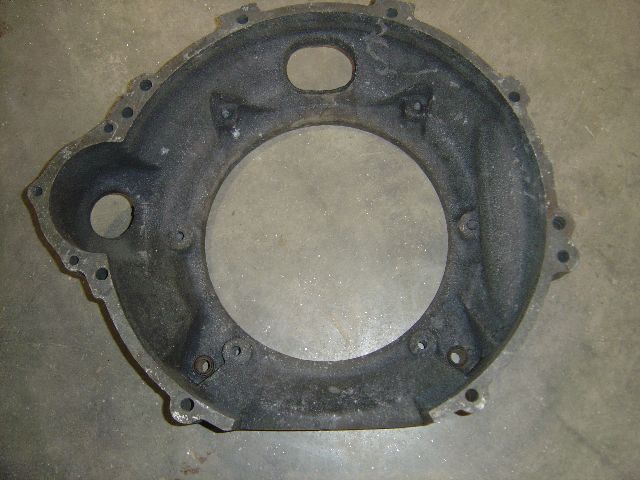

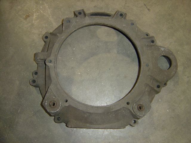

Think you will find that your bellhousing would be supplied with the T44 when you purchase it as they were only used behind FE. ( Neither the manual or auto Production Ford Factory items will fit. Surely at the $$$ I have read about it wouldnt be an optional extra! :) ).

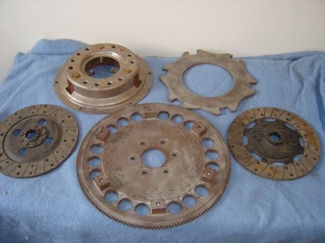

Once again here are some pics of my original T-44 bellhousing, clutch and flywheel and they are all GT40 specific. I know of an original T-44 that just sold for over 50k and it did not include a bellhousing. I do have a few spares of this stuff but no T-44s at this time.
