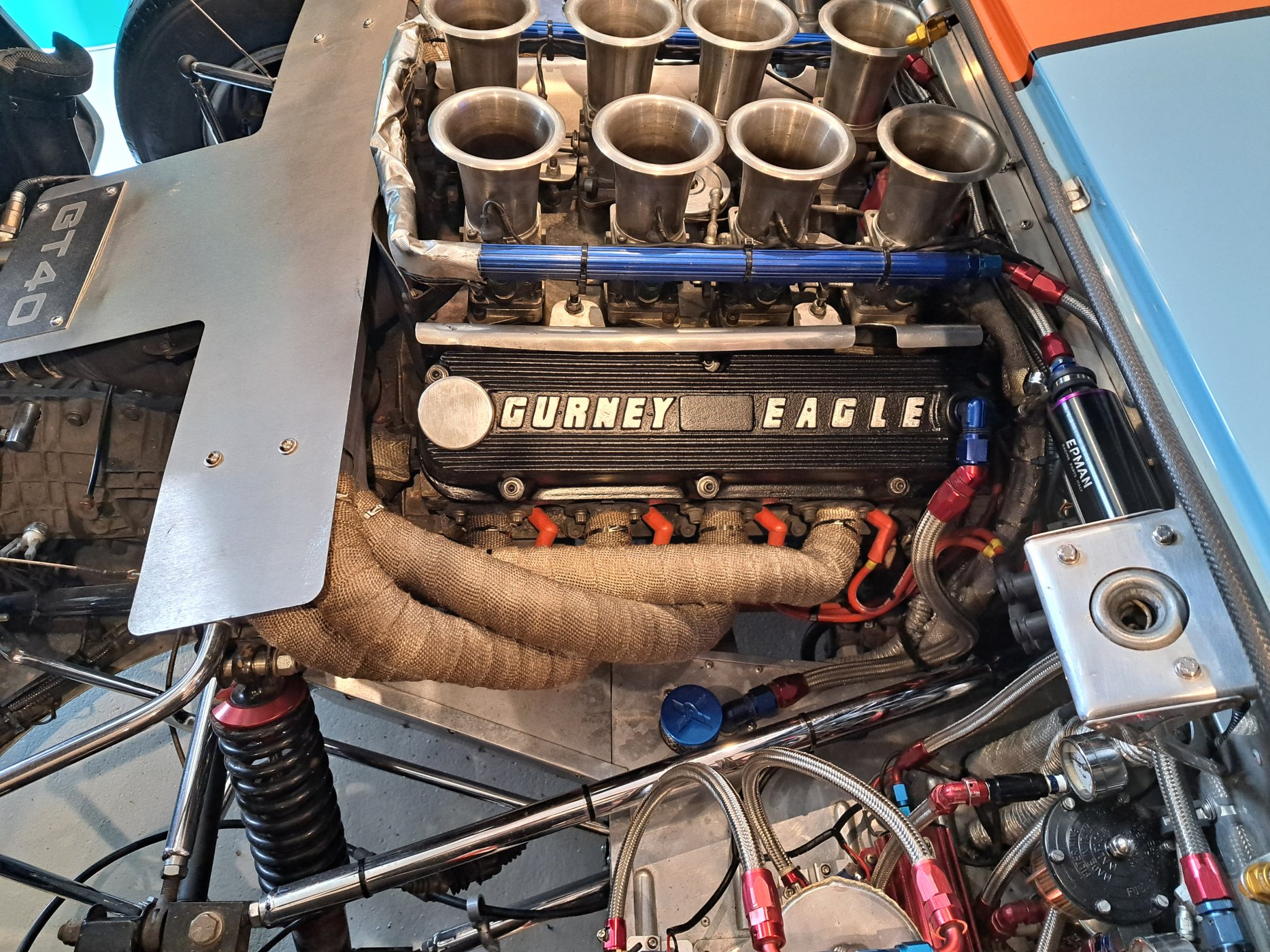

I have bought a pair of Gurney Eagle rocker covers from Andy at Tornado, but am having some issues fitting them. I would have thought this is something that others have come across and solved so asking here.
The car has basic Edelbrock aluminium heads (standards valves) and 1.6 rocker arms. The original rocker covers on the engine were polished aluminium standard Ford Racing covers which fit fine without interference with the rockers. I went to fit the Gurney Eagle covers but cannot get the bolt holes to line up with the head without the covers touching the rocker arms. It’s not a height issue and the inner width of the Gurney Eagle covers is exactly the same as the Ford Racing covers, so it is not as if they are narrower. On looking closer it’s the relative location of the bolt holes compared to the side walls on the cover that is slightly different such that if the bolt holes were aligned with the head holes, the cover walls are a couple of millimeters displaced to the outside of the block compared to the Ford Racing covers and contacts the rockers.
The relative hole spacing is all fine and the same as the Ford Racing covers. As it’s not a height thing adding another gasket made no difference and I can see inside through the oil breather hole that the problem is the side wall relative location.
Obviously I could drill the holes in the covers out to move the relative location of the cover, but I’m not sure that’s a great idea given it’s 1.5-2 millimetres we’d need to move, but maybe that’s what others do? Similarly I could ease the wall on the inside with a grinder, but it seems a lot to take off and I think the wall would get perilously thin.
What’s the trick to get over this?

Thanks all for the responses. So essentially I'm going to mill off some of the side wall to get the clearance. I should have tried the fit before painting them up, but the internal dimensions widthwise were identical to the Ford Racing covers I had, so wasn't expecting a problem. I'll just need to watch the wall thickness as I go.
Craig

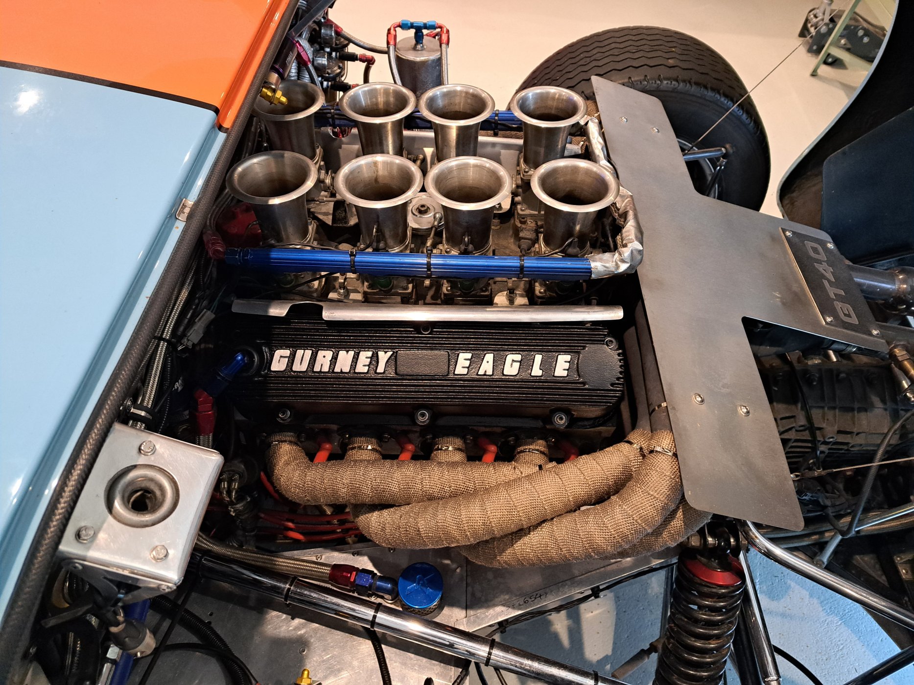

Just an update on this. The Gurney Eagle rocker covers are now painted up and fitted. I used a 12mm tungsten carbide burr on an air die grinder to take about 3-4mm thickness out of the inner side wall (nearest the inlet manifold) and to trim back the bolt hole bosses on that side. The wall is about 8mm thick, so plenty of material left afterwards.
I coated the roller rockers with engineering blue and checked for static clearance. When I was confident it was enough, I loosely bolted the covers on, (leaving them to move if I had got the clearance wrong), and spun the engine over without firing just to check for contact when the rockers were in motion.
Height clearance was not an issue at all.
I did also open out the bolt holes by 0.5mm just to improve the alignment with the head bolt holes, and cut 30mm holes in for the breather fittings and oil filler cap.
It was a fair amount of work, but they are on now and do look good.
Thanks for the various hints and tips.
