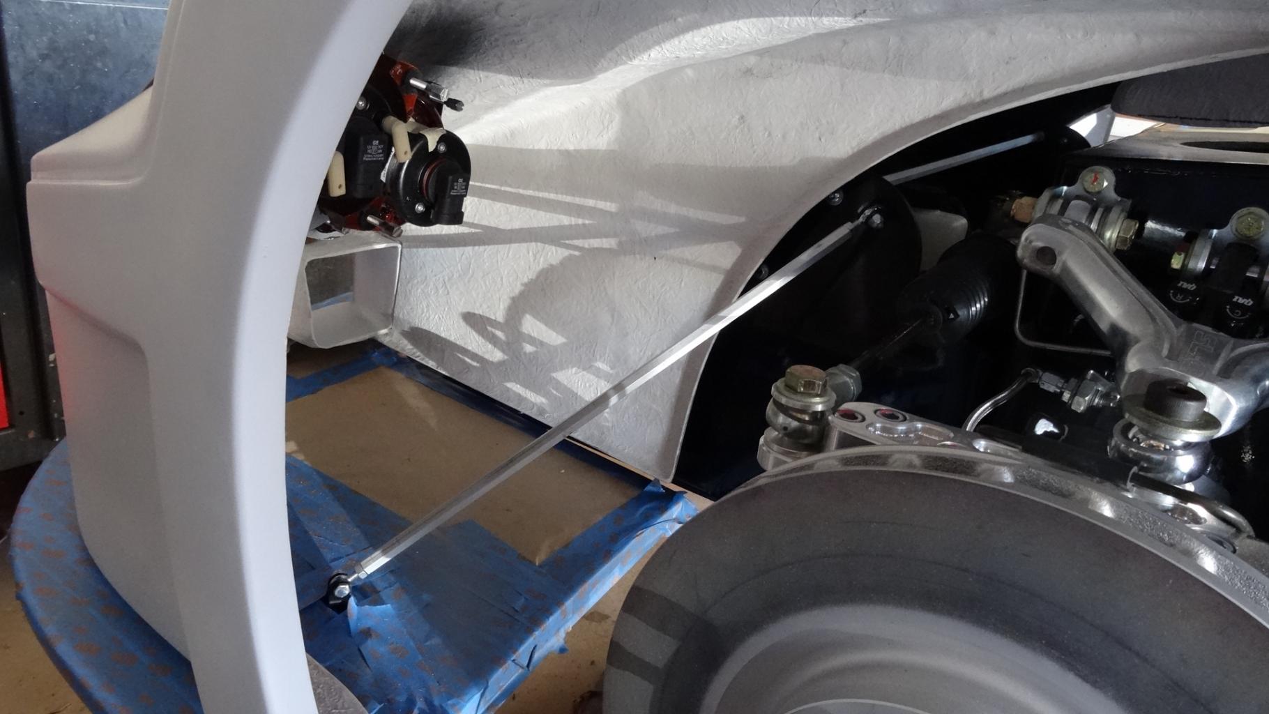

I started to install the RCR provided front inner fender wells. Ran into a small problem. The brace to hold up the splitter is in the way.
Before cutting/moding, what am I seeing wrong? Is the brace located in the right place? How do the brace and the inner liner install together?

Gents
Move the brace that connects to the splitter as close to the edge of the splitter as possible then the fender well will fit in behind it. Just make sure that the brace doesn't hit the tire while turning.
