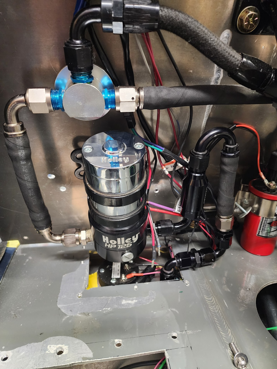

This worked very well for me. 430 hp SBF with a 4150 holley on it. Mechanical fuel pump. No need for a regulator.

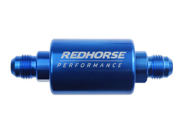

AN fuel filter for my 363CID 950cfm Holley.

The kind that use a wire screen disk are pretty much useless IMHO. It takes very little to plug it up. You won't want to constantly take it apart and clean it. first one
The second kind uses the same style housing but a better filter. It has a lot more filter area and takes quite a lot of debris to plug it up. ok for tight fit.
I like the last type if you have the room. They will last years without getting pluged up unless something unusal happens like dirt in the gas station tank or something.
40 microns is probably fine for carbs. I would use 10 micron filters on FI systems. Nothing less that AN-6 size hoses and AN-8 above 400 HP, The filter will need to have the same size in/out as the pump and regulator you are using as well as the hose size.
