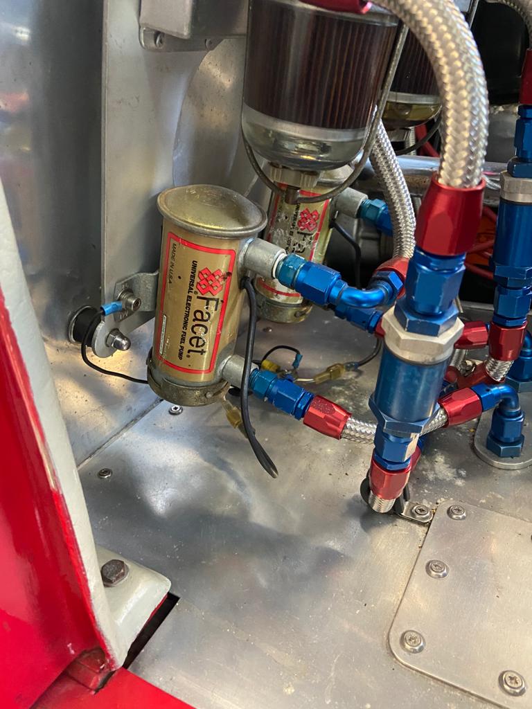

Looks like a good old standard Facet Red Top pump.
Google search that and you'll find virtually every UK motorsport supplier will be able to supply you a replacement.
Be careful of the e-bay ones as they aren't always made in the USA!

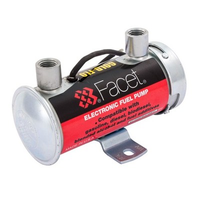

This latest variant now has solid state technology to provide superior reliability over the older points triggered types. The end cap of the pump is removable to reveal a filter which can be cleaned and replaced.
