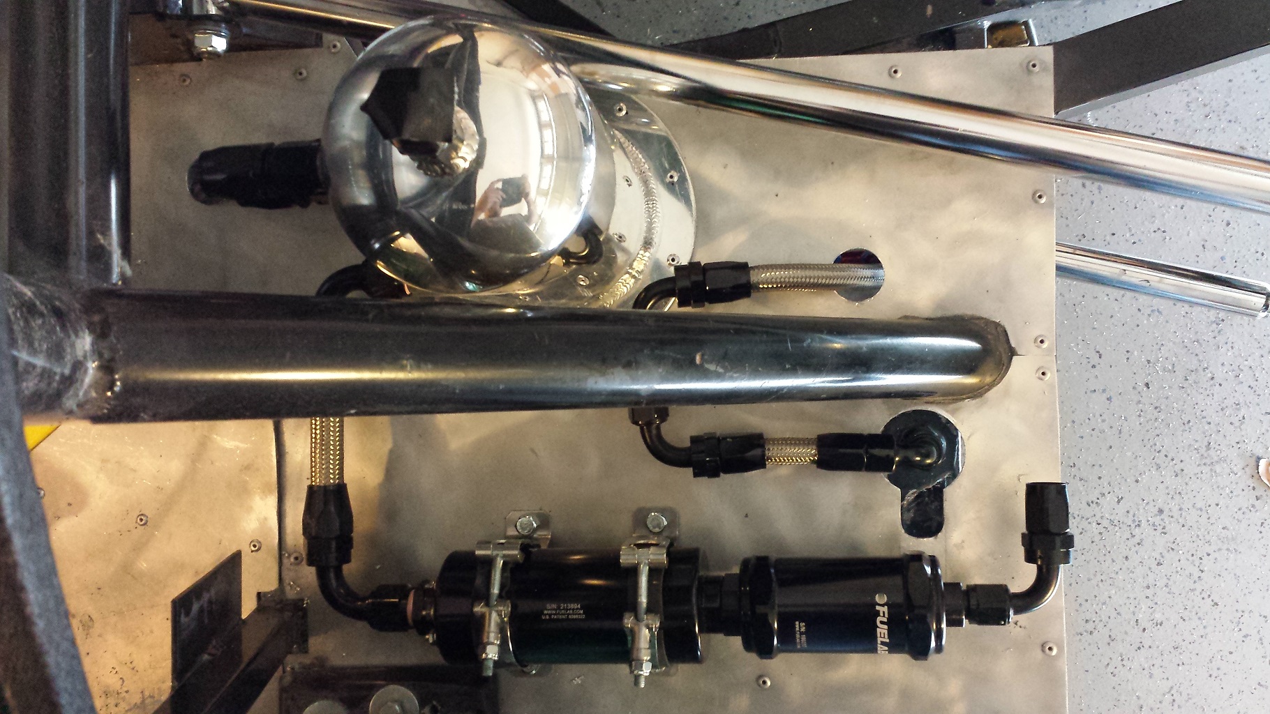

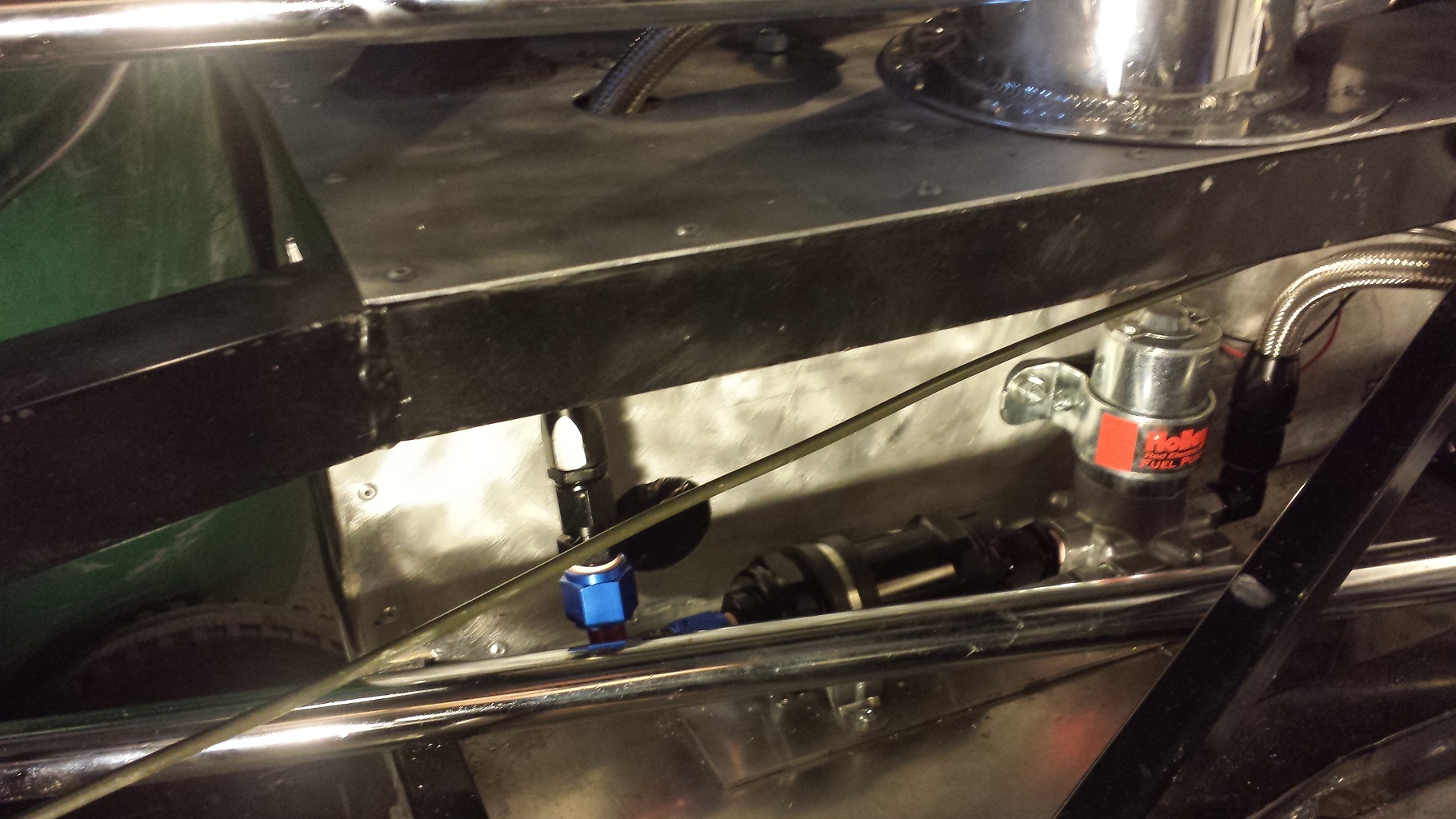

I have no knowledge of this particular setup so keep that in mind, but several of us hashed out something similar a while back. What I ended up doing is contacting a reputable fuel pump manufacturer (actually, I talked to a couple) and got their suggestion. What it came down to was connecting the tanks with a one way valve, adding a low pressure Holley that sits low and feeds a swirl pot (most of your starvation issues are now gone with that BTW), which feeds a high pressure pump.
Setup looks like this:

After reading your post, I'm wondering if the problem lies with the fuel regulator. After the Facet pumps, the fuel line passes through a Malpassi non adjustable regulator, I think this acts as a one way valve (these are restrictive and will be changed to 3/8 one way valves. then to a swirl pot to a high pressure pump, and to to a fuel regulator (Mallory) to the fuel rails.. I researched the Fuel reg, and found the adjustment range is 3-12 psi. I am now thinking my problem is with the regulator not providing enough psi. I will take a fuel pressure test and find out what it is. Appreciate the help!
