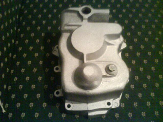

If someone is about to shorten his G50 (5 speed) nose cone I have one already shortened that I will trade with an unmodified at no charge (direct trade).Nose cone has shortened professionaly in a milling machine and has a brass shrink fit ring to secure the shift rod seal nicely.It is from a 1993 G50/03.I will post pics hopefully tomorrow.

As promised some pics.And a correction : the shrink fit seal adapter is T6 alloy.Also if someone has an unmodified nose cone for outright sale I might be interested too.

Why do you need to shorten?
Red - according to his statistics, Jim's not been online since he posted that message back in 2008.
I can answer your question though and direct you to my website (below) for more information in regard to the shortening and reasons.
Basically if you don't shorten it, the transaxle will not work in a MK1 GT40 without hanging out the rear bodywork.

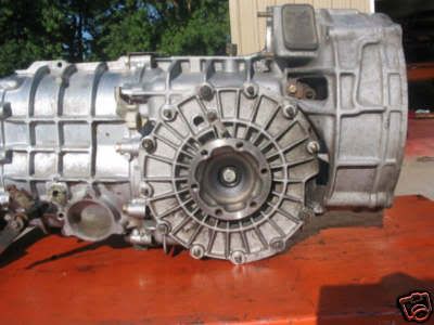

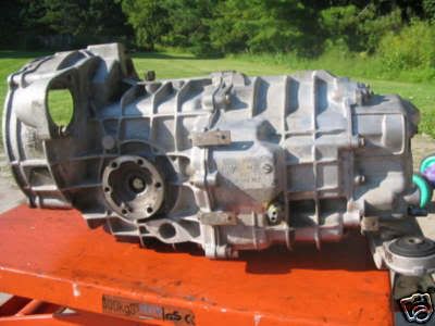

Here are the pics of the gearbox i bought once and never received.
G50/50. 34000km LSD overhauled with warranty
I bought it from you via ebay on christmas eve 2008
I won the bid at 1000 EURO.
Total amount was that plus 1000 EURO core charge and 400 EURO Transport fee.
You probably expected more than that for that gearbox, but that´s ebay and everyone selling there should be aware.
Transferred that 2400 EURO on 28.12.2008.
You failed to send me that gearbox for over 6 month.
Emails where exchanged forth and back and we finaly agreed to a deal to send me a good G50/03 and one G50 in parts. You sent me the bespoke above G50/03 with the shortened bellhousing but never the one in parts. Due to that we had another email traffic going along with the result that instead of the G50 parts you send me a 915 and finally a VW Kübel gearbox. Non of this ever arrived here at my place.

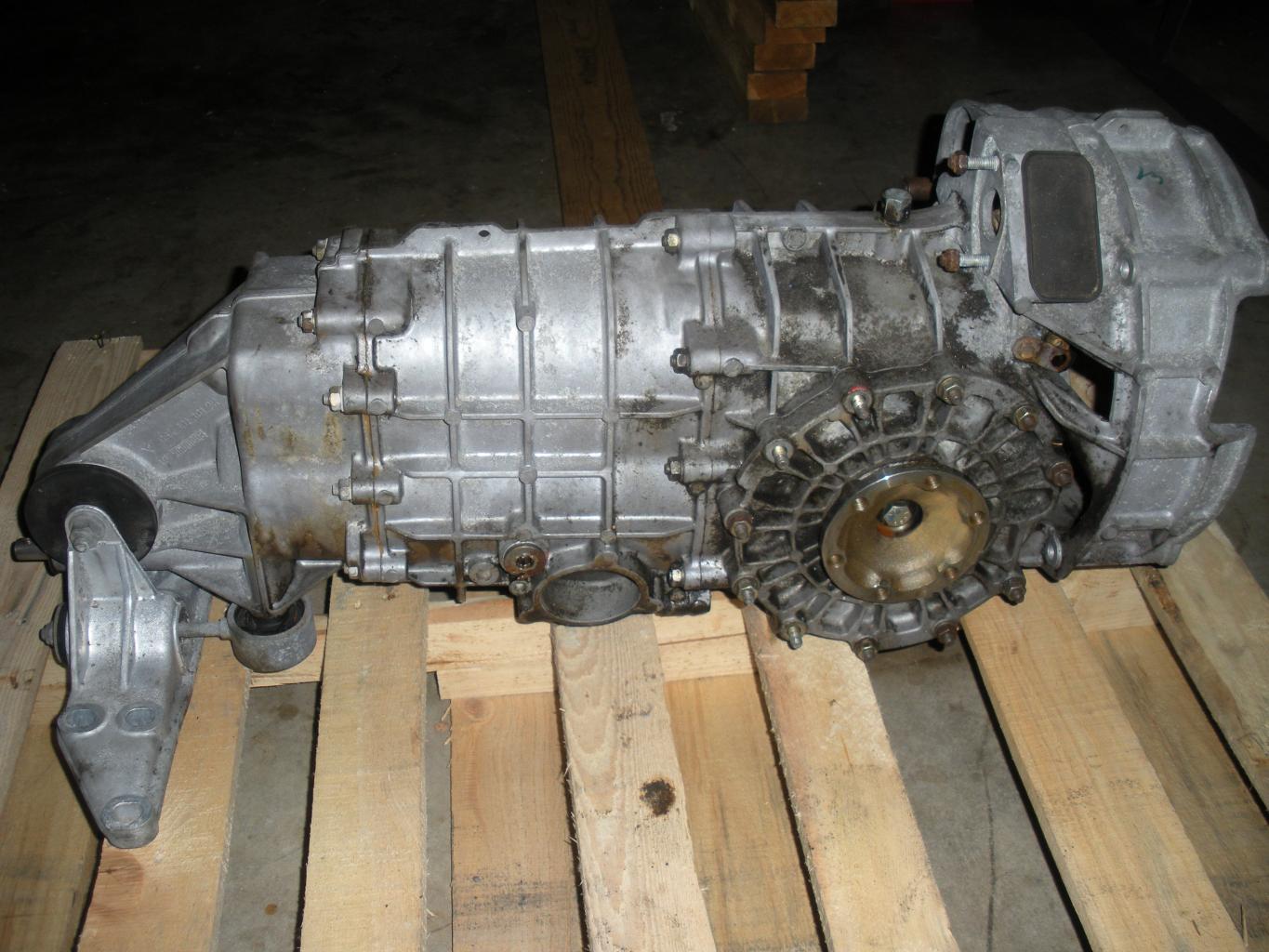

I am in the process of building a Mk1. I have a G50 box for use with a 302. However, it is not a short tail box; will this work acceptably? Anyone using the long version? Thanks.

Will work just fine if your engine is mounted forward enough and you are shortening the endcap, Check out my build log "TOMS TRACKRACER" there is a section inside with how i did it.
TOM
Tom, Thanks went there last night and checked it out. I take it you did shorten the rod shift shaft, and simply cut off the rear donut and tidy up the case? That looks cool, is the elimination of the donut mount a problem for the weight of the transmission (stress on the front of the case), or do you support the case elsewhere? Was it a simple task to shorten the shift rod - no seals or anything to deal with? Thanks,
