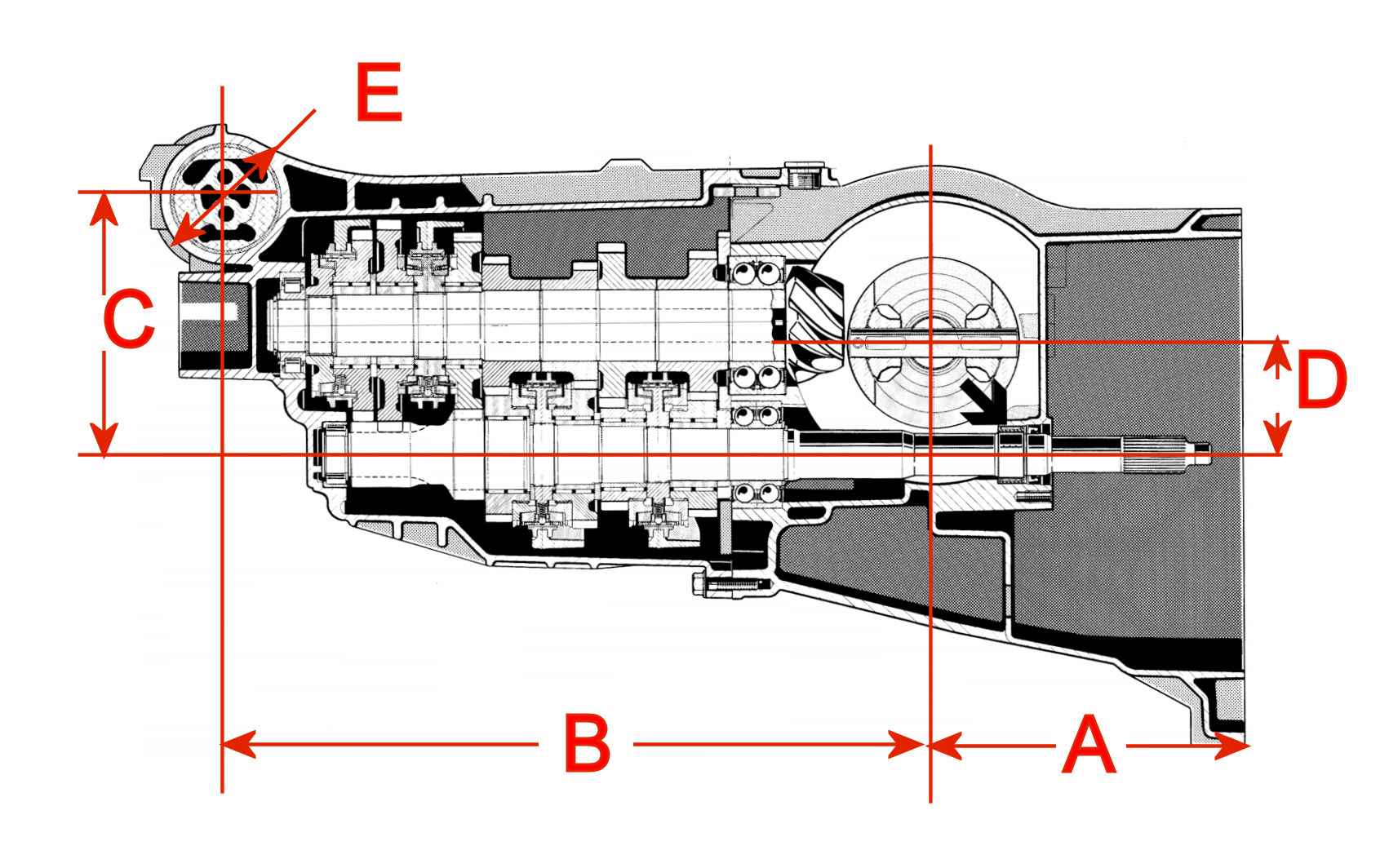

I am trying to do some layout work for my build. I am awaiting delivery of a transaxle so don't have a piece of hardware to measure.
Does anyone have any dimensions or drawings of the Porsche G96 transaxle? I have scoured the internet and keep drawing blanks. I can find pictures but no drawings and little if any reference to using them in our GT40's.
Most specifically, I am looking for these dimensions
A) Bellhousing face to centerline of axles​
B) Axle centerline to centerline of rear support bushing.​
C) Centerline of input to center of rear support bushing​
D) Center of input to center of axles​
E) Outer diameter of bushing hub​

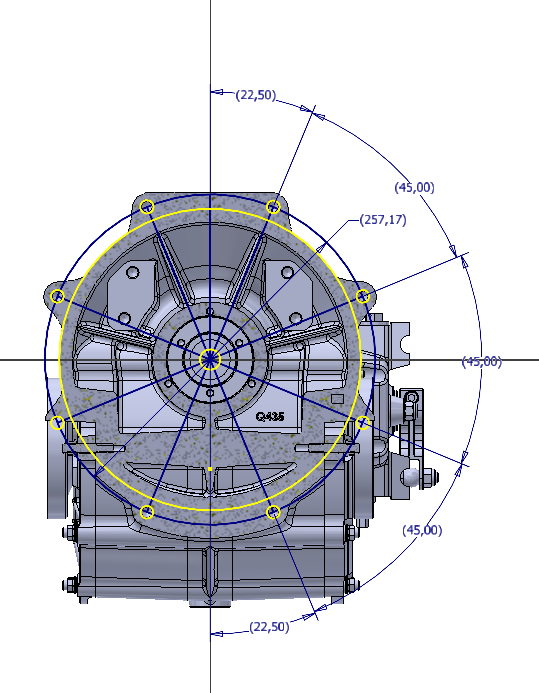

Not sure if this is correct.
Taken from a model of a quaife box that is supposed to be a direct replacement of the g96.
It does look like 4 of the holes are in a circle. I wonder if the quaife box has another intermediate piece in between.
257.17mm is almost exactly 10 1/8”.

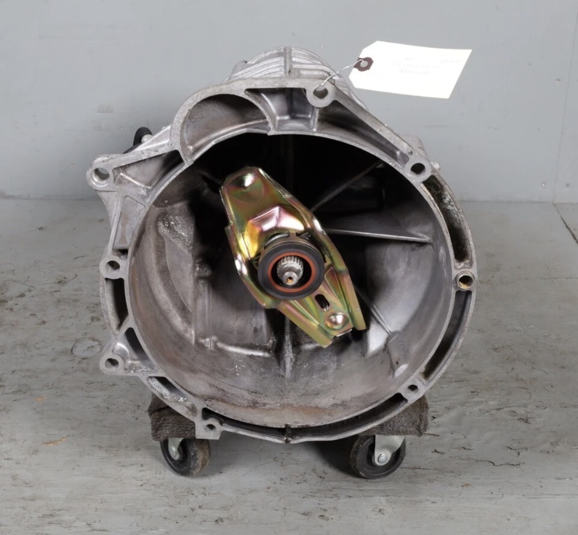

Picture from eBay of a 996 transmission.
