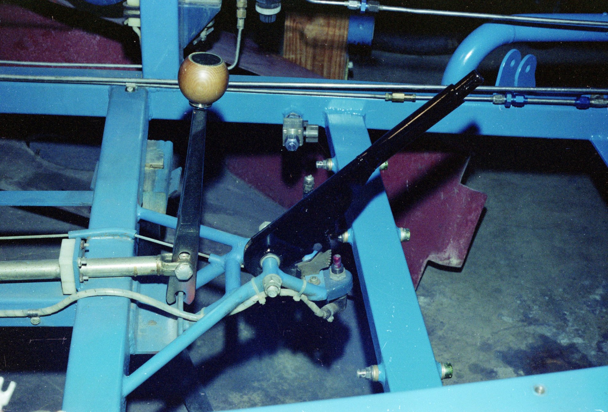

This was done on the showroom Manta Mirage to keep it from being started with the parking brake off. The little red button forward of the parking brake handle is a microswitch.
