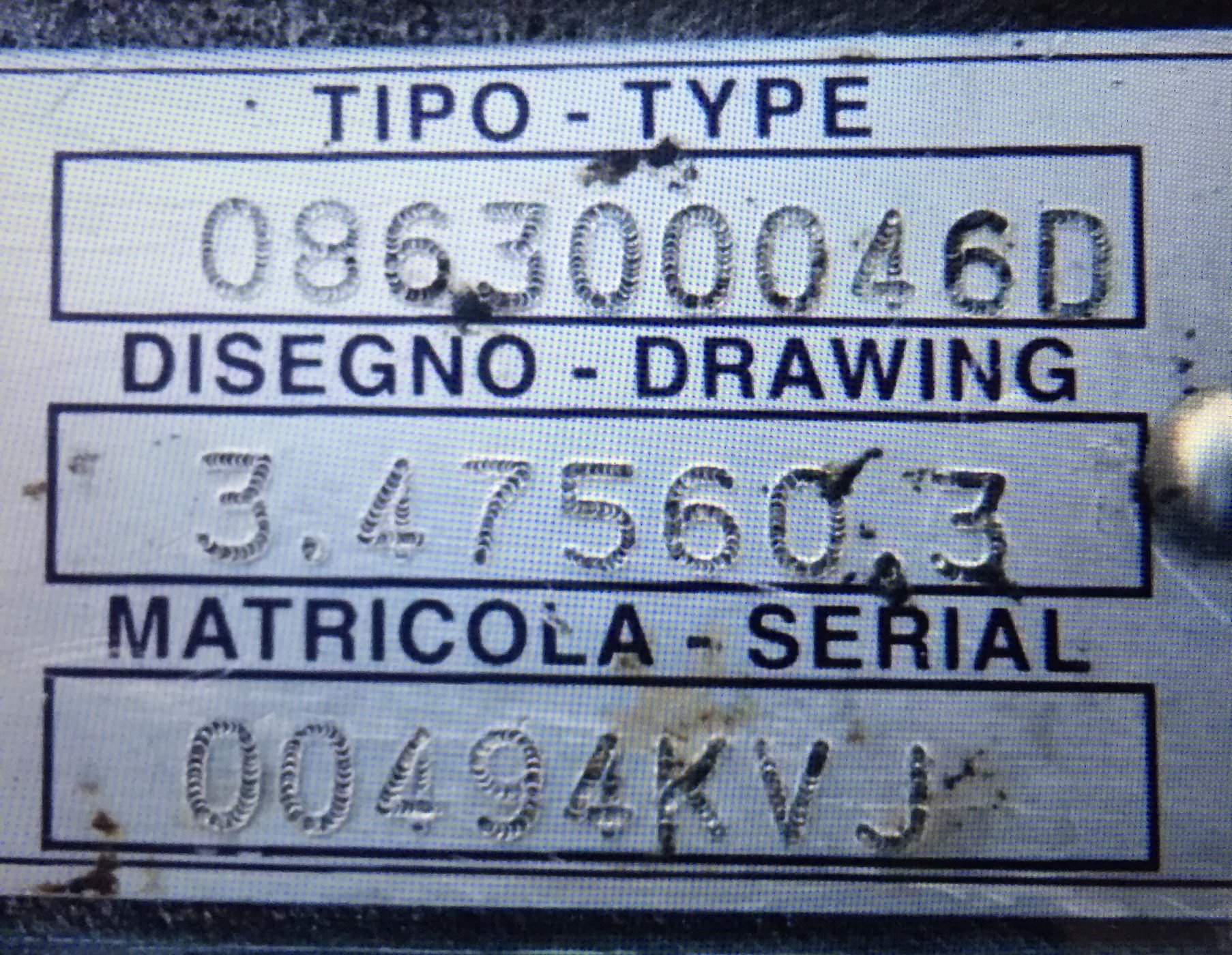

Try and find a used V10 Graz. They don’t require machining of the case for the drop gear install. Get it sent to Ron McCall for tear down/inspection/forward shaft removal and drop gear install.

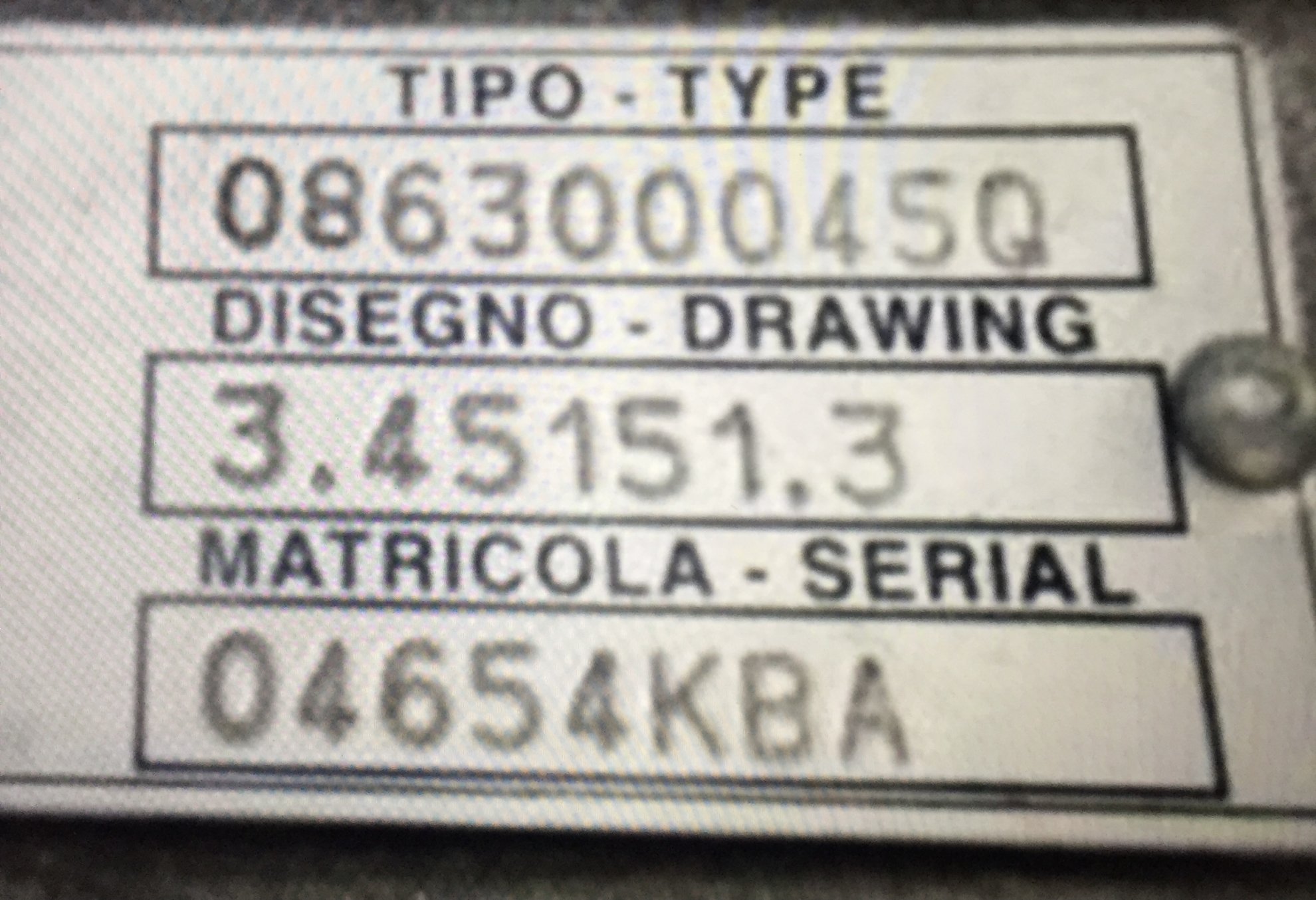

I see many for sale on EBay but be aware many claim their’s to be from a V10 but are not. The serial tag will be proof of the origin.
Here is a picture of a V10 serial tag. The third line shows the serial number ending with KVJ. This is proof of it being a V10 model. If the serial number ended with KBA then it’s from the V8. The V10 model also has slightly better gearing.

Which one is 45J or 45D, if anyone knows? R-Tronic? E-Shift? Older transaxle out of Gallardos, so I don’t know if there was a change in PN or these are the wrong type.
