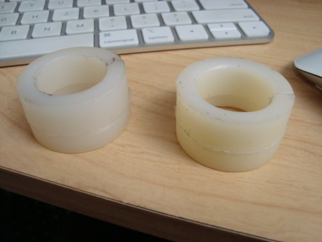

Supposed MGB however anyone know specific unit used on SPF ? Specifically the year and what did SPF modify to fit? My turning radius is very minimal. I removed the internal plastic stops, but this changed nothing. Would like to get another rack to experiment with. Appears I have quite a lot of tire to body room for additional turn radius. Any SPF owners know their steering wheel turns, lock to lock? Maybe it is what it is? Any info appreciated.

The strange thing is removing the plastic stops made no difference at all, so was thinking maybe there is something else going on? I thought more teeth machined on the rack could be a possibility?
You're right about the Moss Motors MG steering rack Rick except it's made in Argentina. Removing the plastic stops did make a sizable reduction in turning radius in my experience. Fewer 3 point turns.

Yes, sure the .850 wide stops are out. The 215 Avons now just miss the inner well, but I found the issue! Being dumb and cauious!
I didn't want to force the steering wheel, as turning gets pretty hard after the initial 1 turn? Anyway, I do have a little over 2 turns until the rack hits its stops . Sorry to all for the hub-bub! Maybe getting old, weak and loss of gray matter is catching up.
