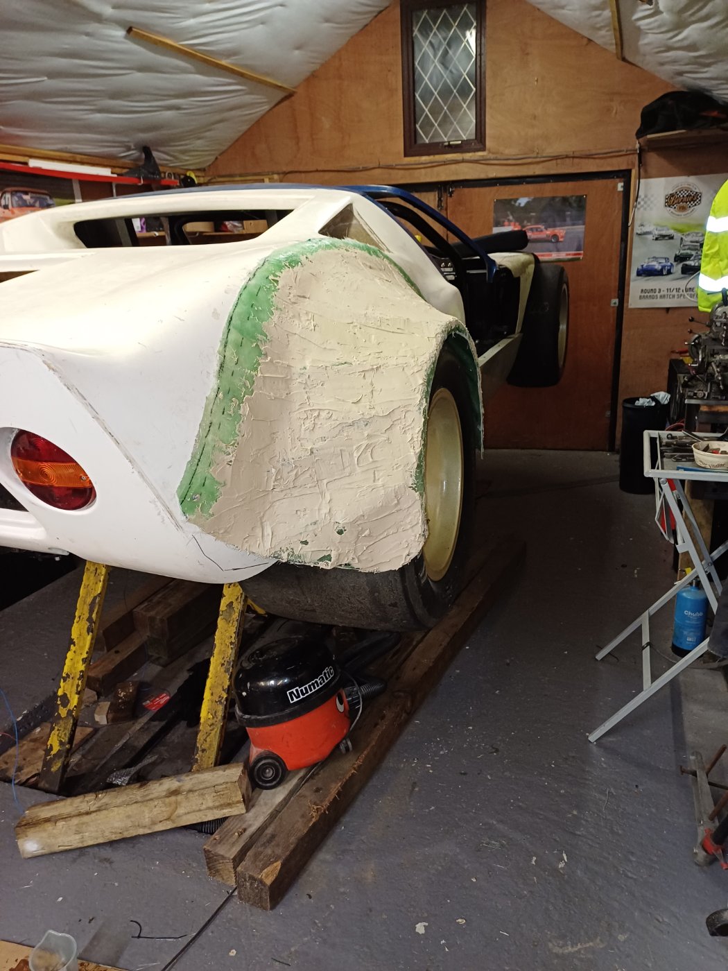

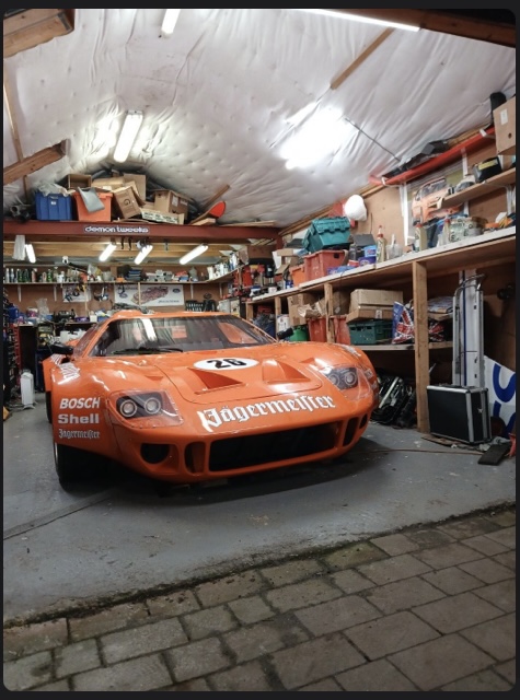

GT40 built on 1988 Lola T88/50 indy car

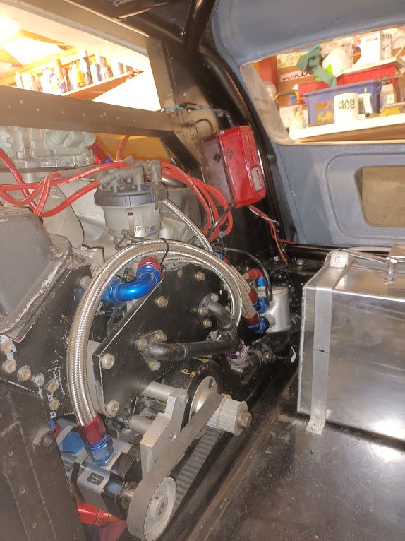

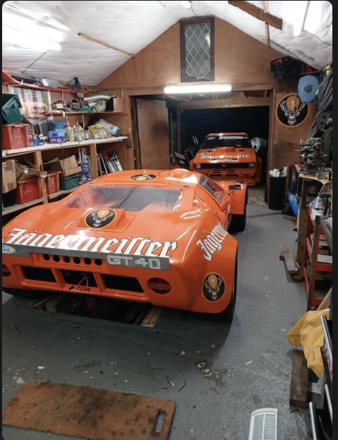

I have been been building a GT40 race car on a Lola T88/50 chassis

Aerodynamica might be another challenge as the chassis was designed for differend aerodynamica.
Otherwise, I realy like the outside the box thinking mating a GT40 body to a F3000 chassis.

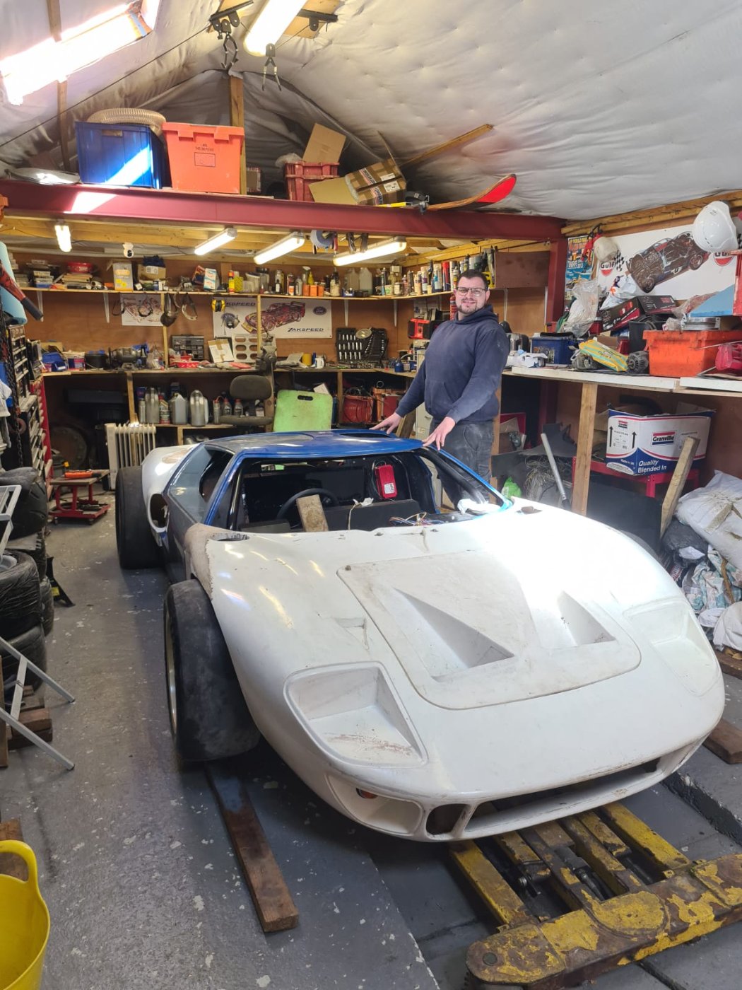

...mating a GT40 body to a F3000 chassis.

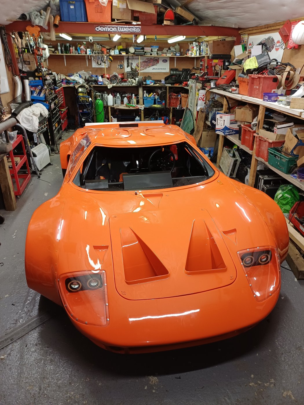

Looking at the earlier photos, it might be the rear end of the Lola grafted onto a GT40 chassis, along with the front suspension. The center section looks very non-Lola.
Would definitely like to see some pics!

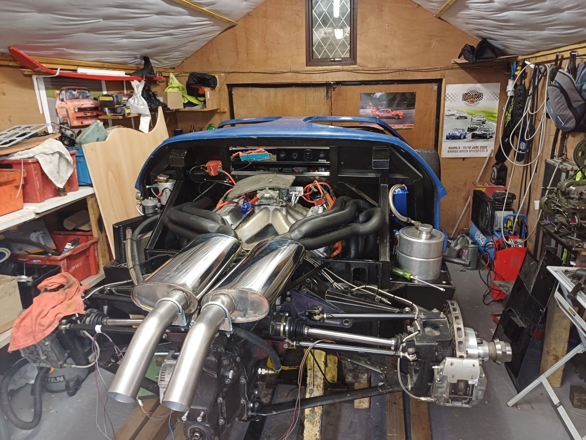

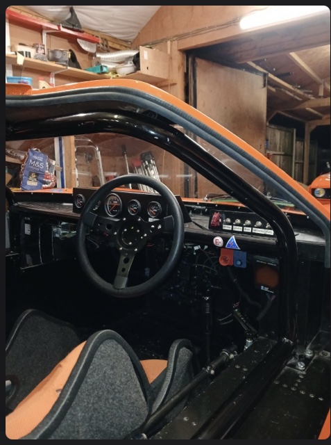

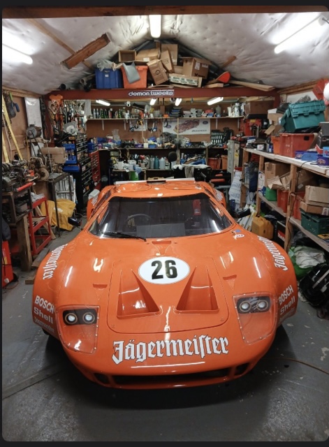

the centre section is a custom monocoque made in steel and fully riveted , with lola front and rear suspension from a lola t88 indy car
