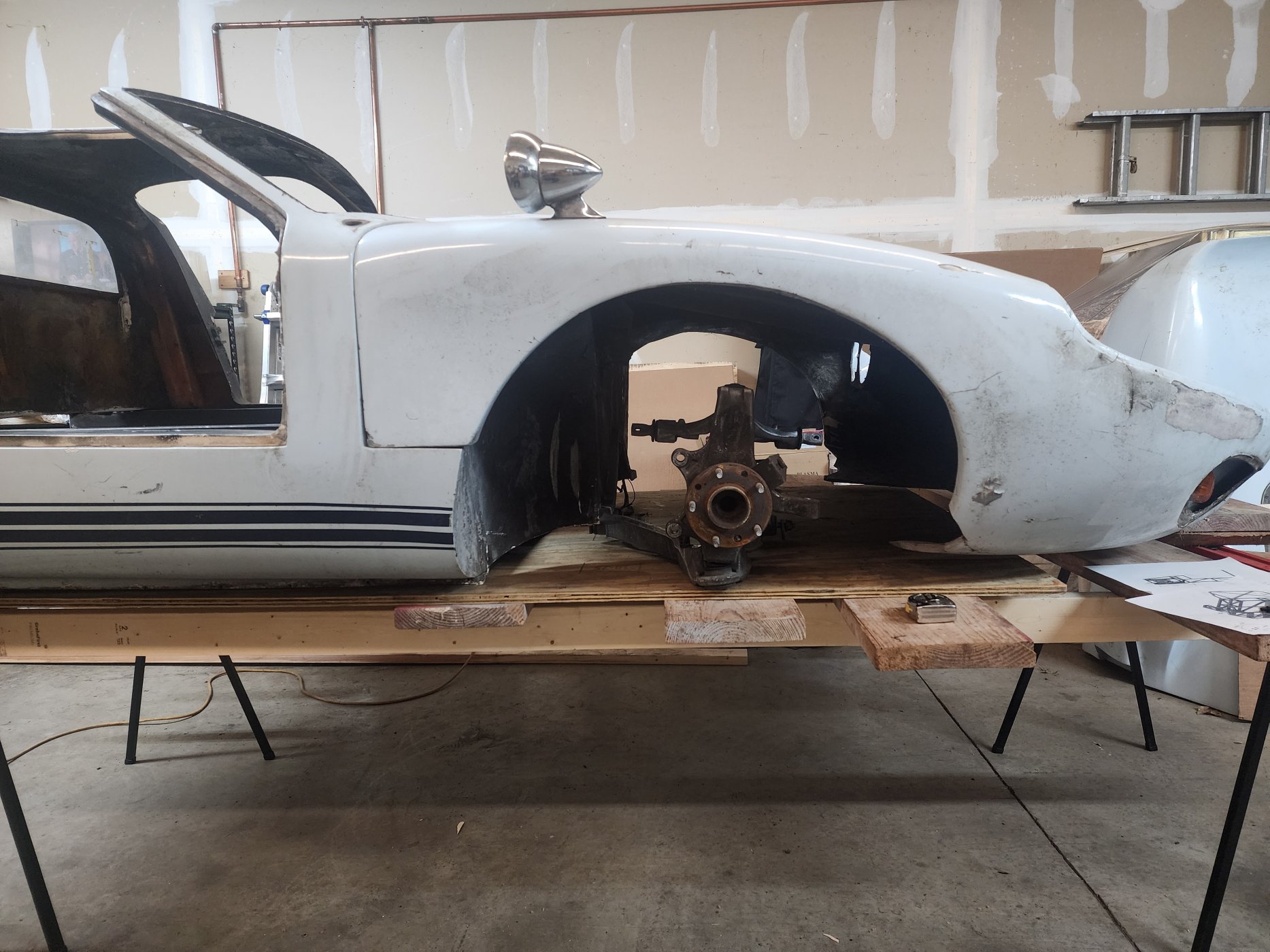

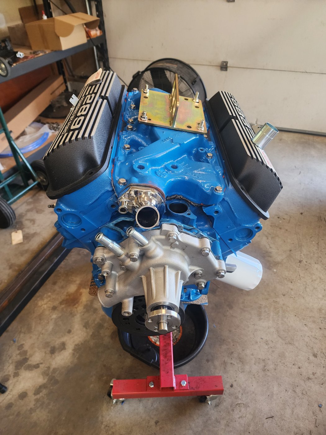

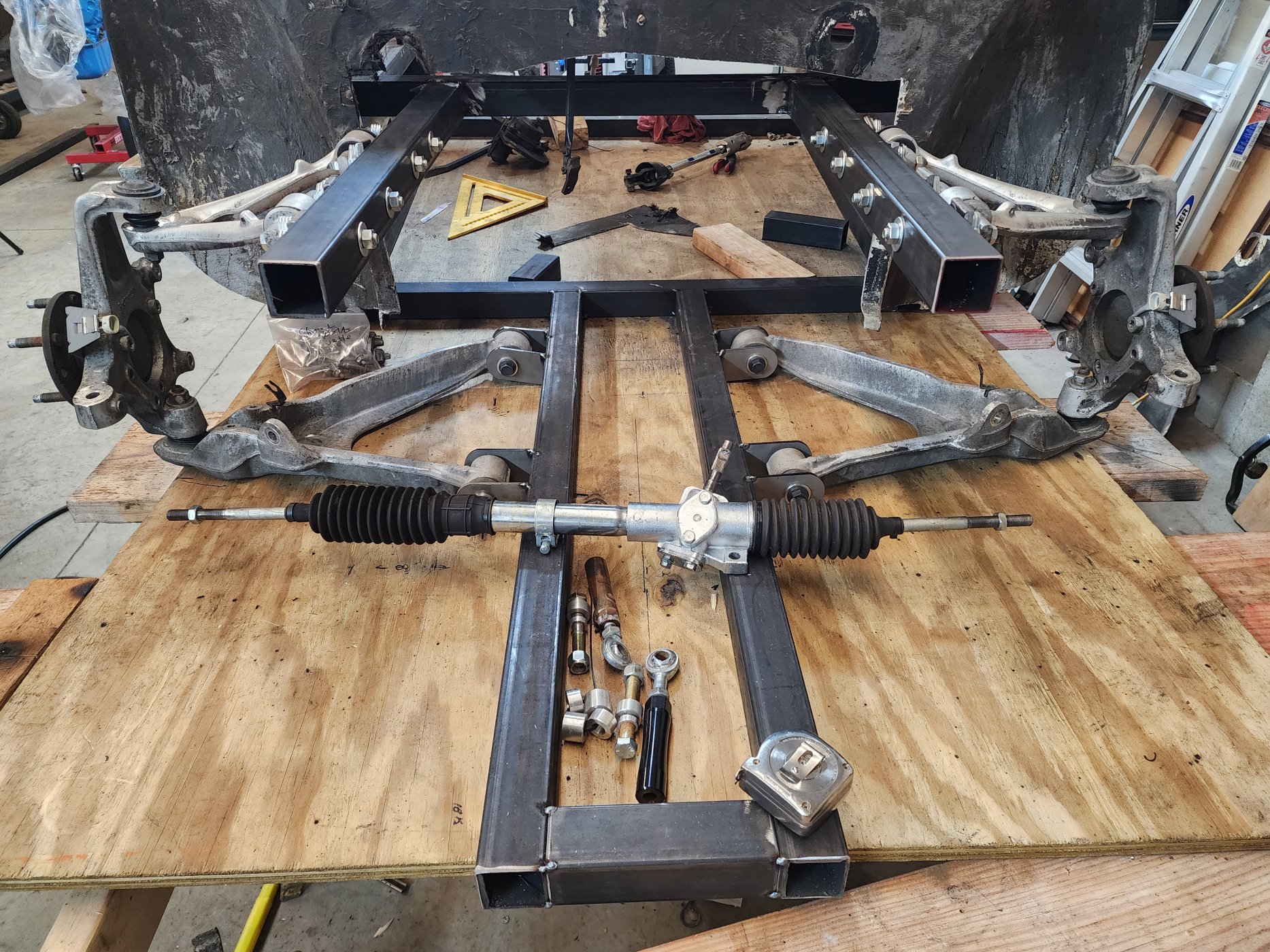

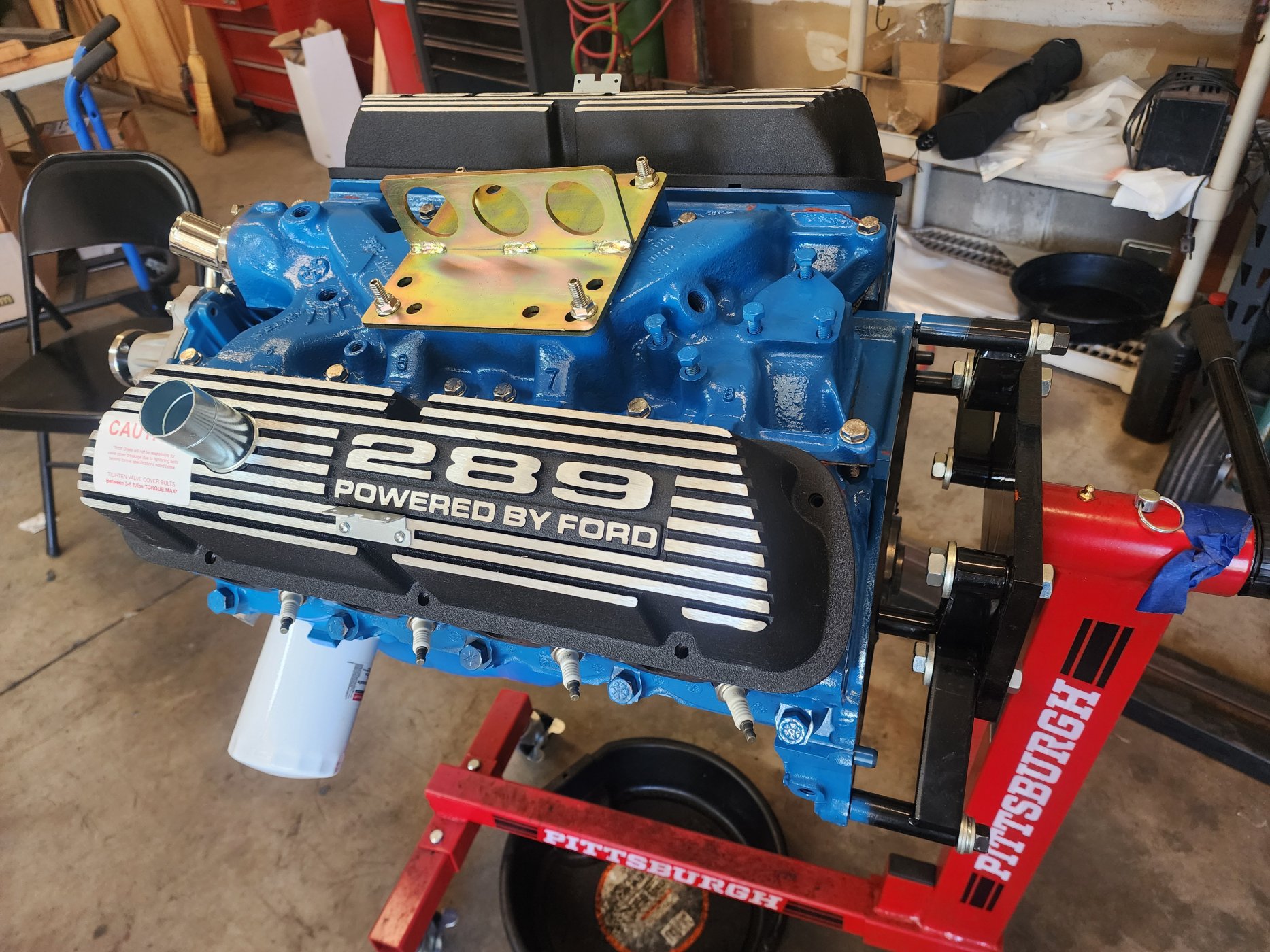

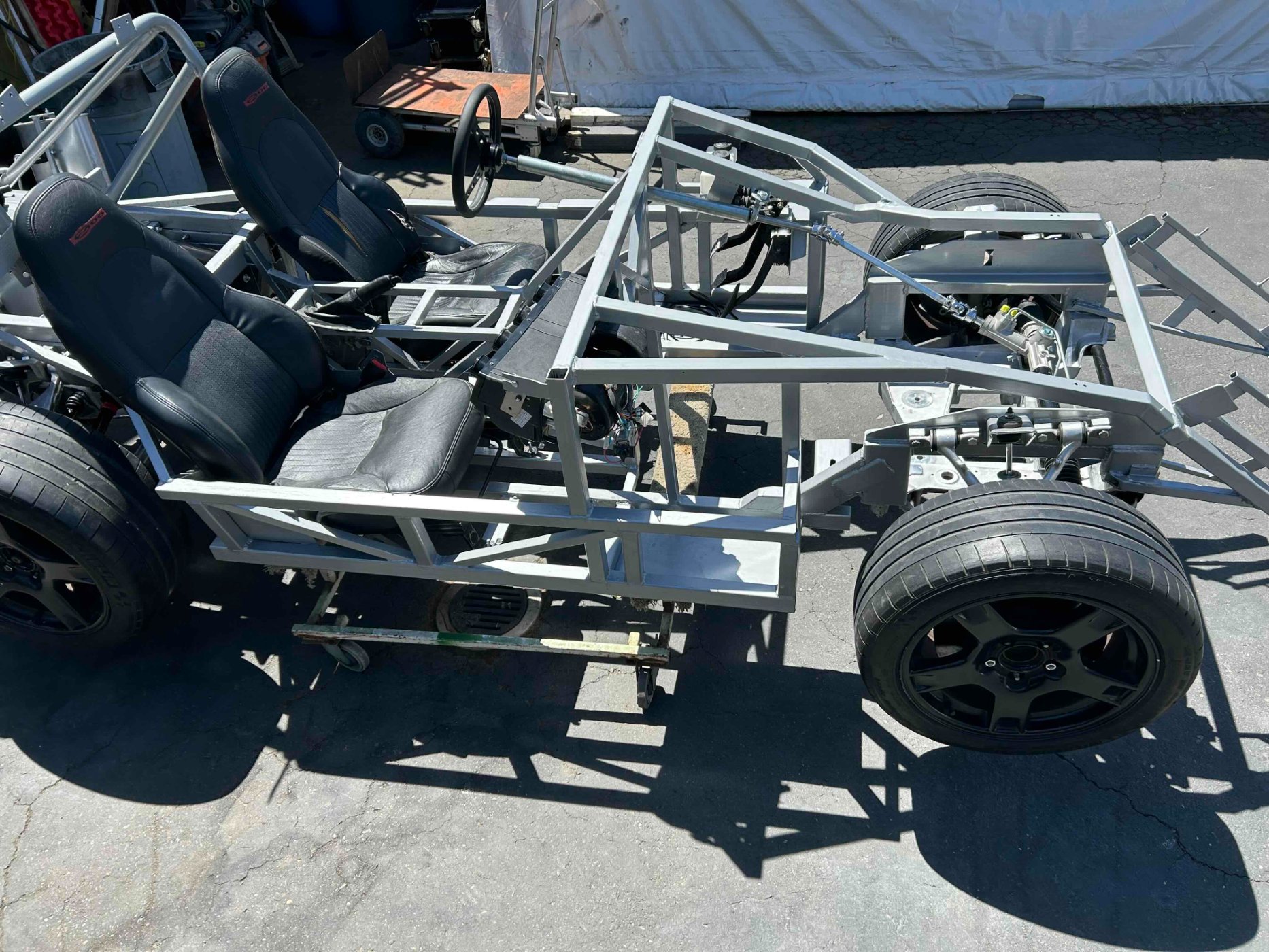

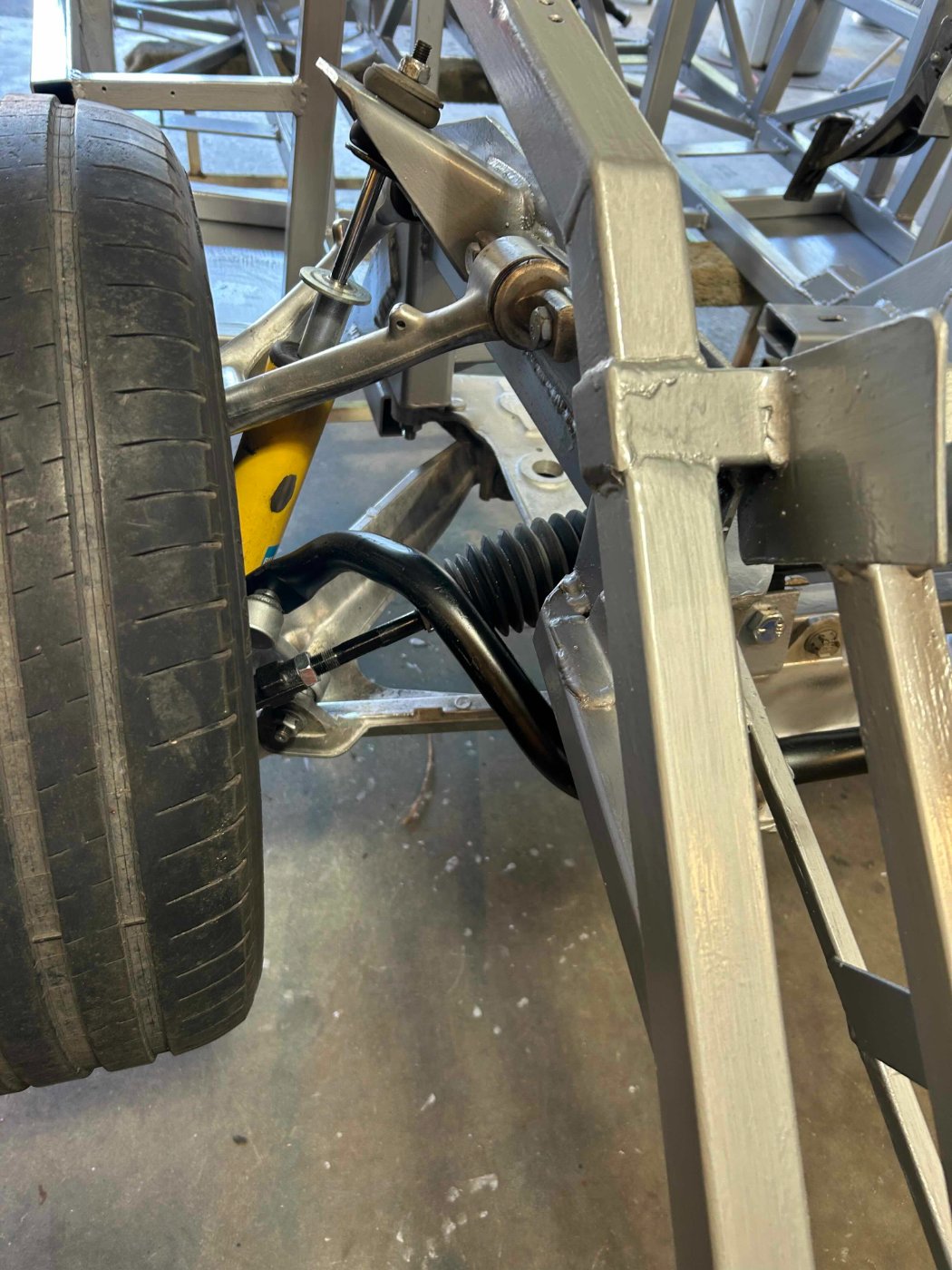

Well I just could not bring myself to spend the money on a manufacturers kit so I found a Kellison gt40 and junked the vw stuff. In the process of building my own chassis with a built 289 and o1x gearbox with c5 suspension. do envy you guys building the mfg.kits and watch all of you. I still have lots of questions also. Thanks for reading

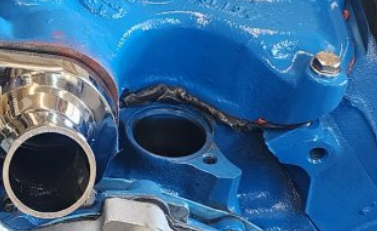

Alan, I may suggest you to redoo the sealing of the intake manifold.
The quantity of silicon sealant is way too much, if it is going out of the sealing plan on the outside of the engine, you can imagine that it is the same situation inside the engine. With time and the action of the oil, the extra material will fall down inside the lifter valley and you will get a lot of chance to plug the oil pump or other galleries.
It is just a suggestion ... :)

Thanks for the suggestion. As I did this most of the sealer was toward the outside of the edge. The cork gaskets never seal.well so I use a good amount of sealer so it squeezes out the oit side. But thanks for looking out for me!
Well I just could not bring myself to spend the money on a manufacturers kit so I found a Kellison gt40 and junked the vw stuff. In the process of building my own chassis with a built 289 and o1x gearbox with c5 suspension. do envy you guys building the mfg.kits and watch all of you. I still have lots of questions also. Thanks for reading View attachment 152564View attachment 152565
