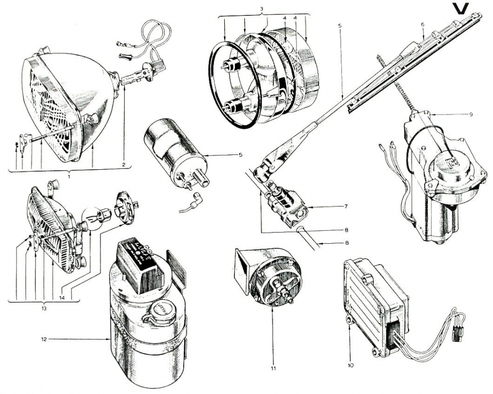

I need two more of these brackets, not sure who made them (marchal), or who still makes them ( perhaps valeo )

Hi, Is this helpful ? in front of the light unit is an aluminium reinforcement (bonded to the fiberglass) that it is riveted to, .regards, Peter.

Ah! So two brackets per light, mounted vertically at each side the light is adjusted by a combination of all 4 knobs.
Charlie Farley
Richard, in that drawing you will see the bracket behind the lower driving light. It is the same as the one on the website. A precise copy, plated as per the original. I also have the headlight brackets in stock.

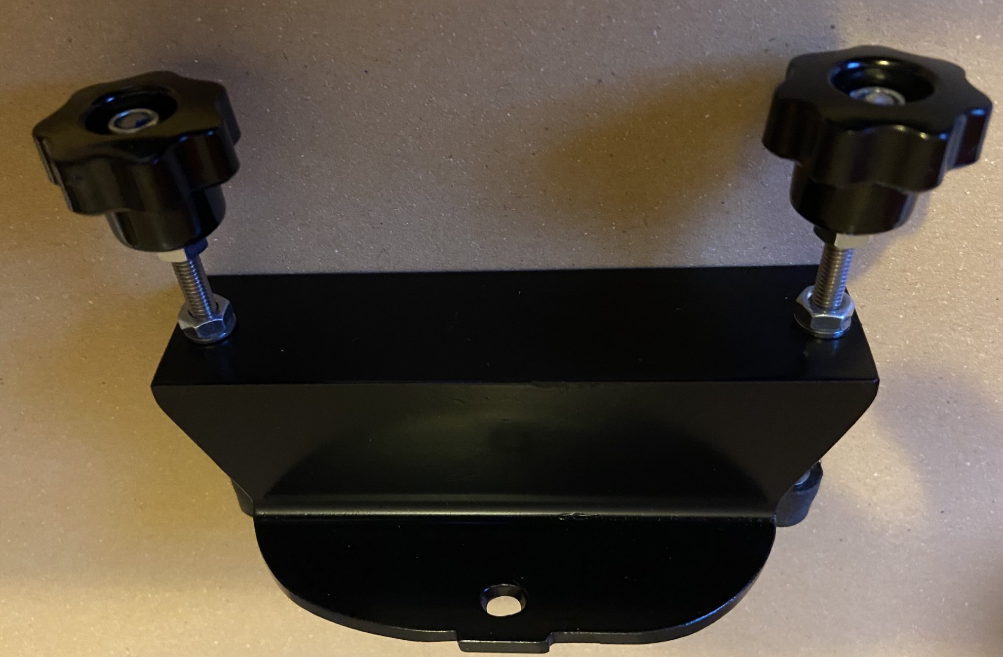

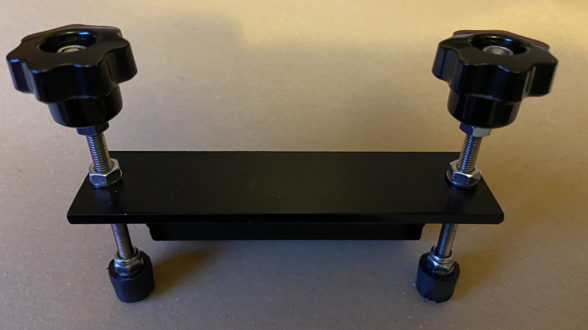

This may annoy the “originality is everything” officionados in here, but here is my attempt at something similar. I have got to try final fit and adjust, but preliminary trials show they should work.... and all from off the shelf items, with a bit of fettling
