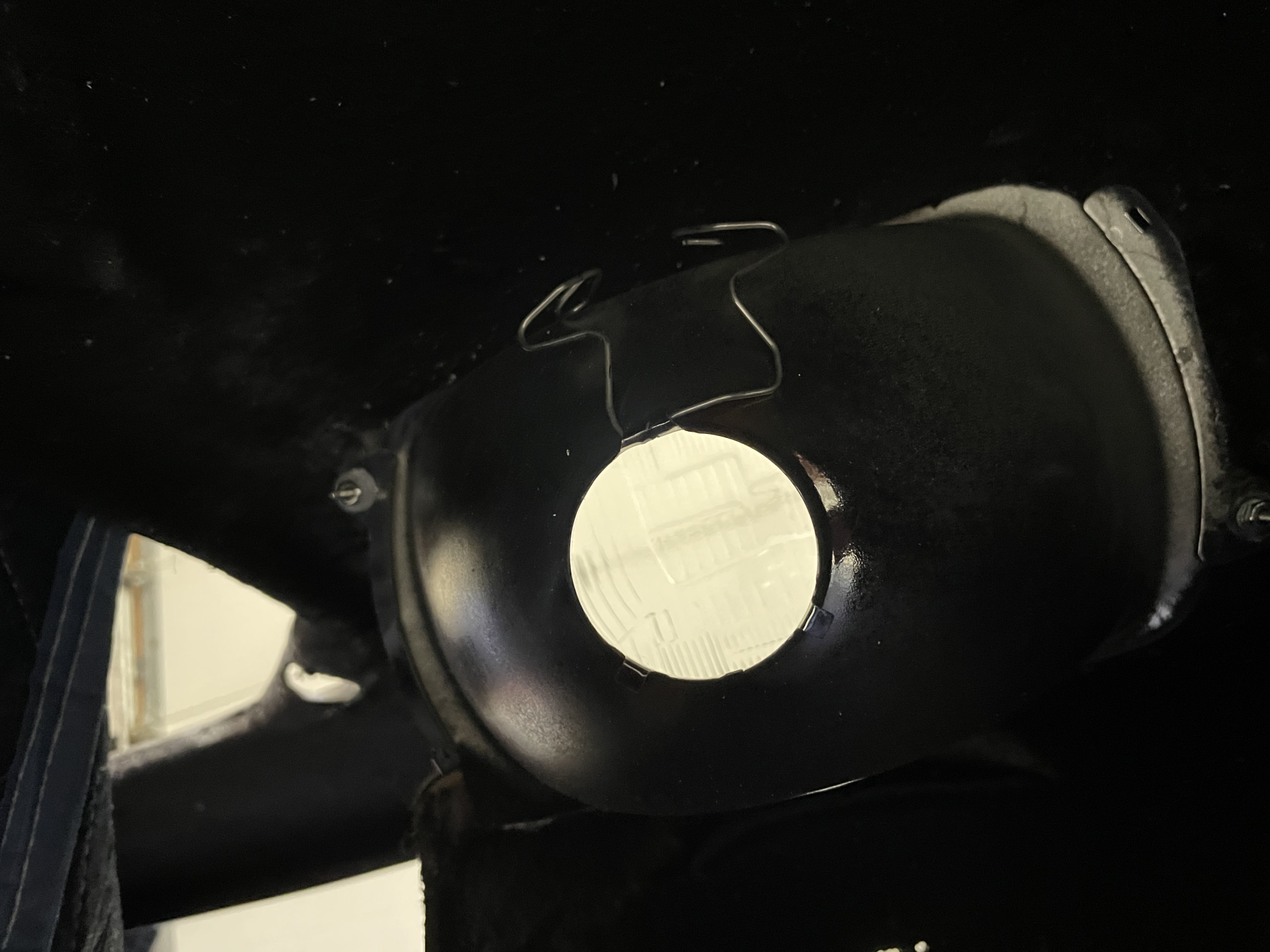

Where can I find Socket/Bulbs to fit the GT40 headlights.
P Phil G Supporter Apr 1, 2024 #1 Where can I find Socket/Bulbs to fit the GT40 headlights. Attachments tempImageXHhQOF.png 2 MB · Views: 200
H Walter Apr 1, 2024 #2 Hi: I have the original Marchal head lamps and they take the standard H4 bulbs - nothing special.
H Walter Apr 1, 2024 #3 if you are talking about the round auxiliary lights (Marchal TP 27SP, fog and high beam), they take R2 (Bilux) 45/40W 12V 3200K P45T ....

Ian Anderson Lifetime Supporter Apr 2, 2024 #5 Bulb, UEC P45T, 12V, 45/40W, clear Moss Europe www.moss-europe.co.uk would be standard Bulb, H4, xenon, 12V, 60/55W, white Moss Europe www.moss-europe.co.uk I found to be much better but check your wiring can take the extra load. Ian
