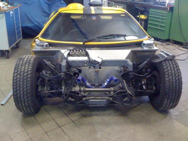

Hi Hendrik !
Is yours like this?
Regards, Mike S

My car has the KVA setup, I'm sure, pressed steel, big spring..
Yes it is exactly like in the pic. Are there replacement coil overs (and other remedies) available? Thanks for the efforts!
