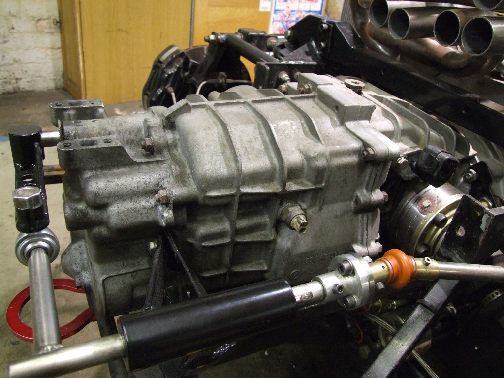

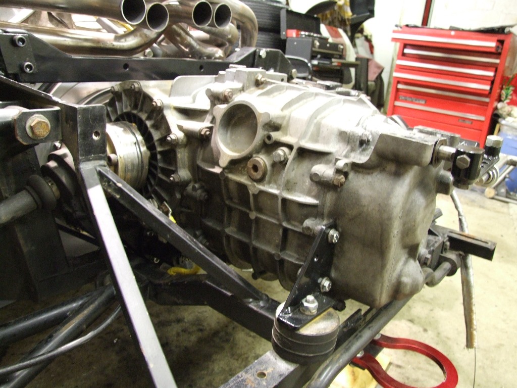

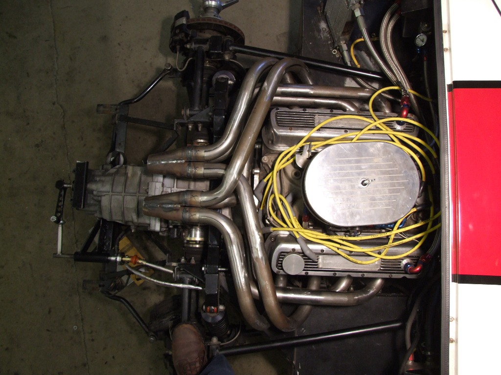

This is a Ford engined GTD running a G50 gearbox

Looking at pics, I am a bit sceptical about the driveshafts alignements.
Questions :
Is the car on stands? (wich would explain why we have a so wide angle for the driveshafts).
Because if this is correct height and then angle, there should a high stress on the CV joints and also vibrations.
Old memories (but getting old...so not always perfect & accurate) said 2 or 3 degrees are the best angles and to not go over 10°. I believe a 6 to 7 degrees for the shafts according to the expected driveshaft speed should be what would be acceptable.
The gearbox seems to stand very high, wouldn't it be better to flip it? and then reduce the angles.
On a porsche 996, the angles seem to be more closer to a 4-5°.
