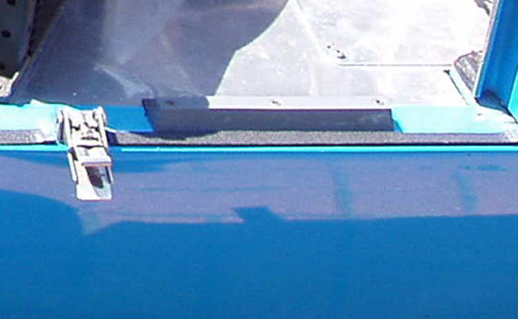

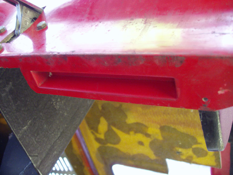

In the rear clip of my GTD is a reccess for a plastic body locator that is screwed into the chassis. I know other manufacturers have their own way of accuratly positioning the rear clip, but I'd like to stick to the GTD way if possible. Is the plastic strip commercially available or was it specific to GTD?
Any advice much appreciated.
Simon

I was able to find similar material at a local plastics dealer here in Raleigh, so it should be available just about anywhere. It is not difficult to machine to size and, judging by the photo, yours should not be hard to do either. You could probably do it on a table saw with a finish blade. This would certainly be the most economical way to go, if the exact part isn't readily available, which would certainly be the easiest.
Lynn
