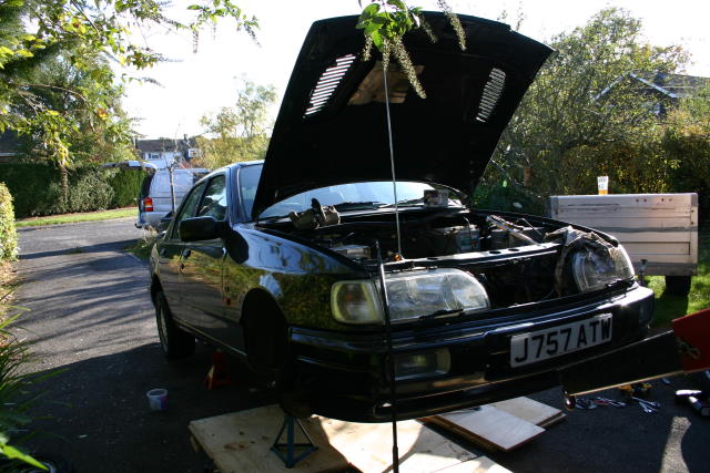

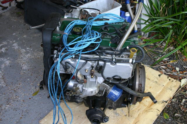

When I removed my motor and trans from my 4x4 Sapphire Cosworth, I did it from below and the front of the car had to be jacked to an incredibly high level to enable it to be pulled out. (not an easy job when done in your drive:stunned:)
