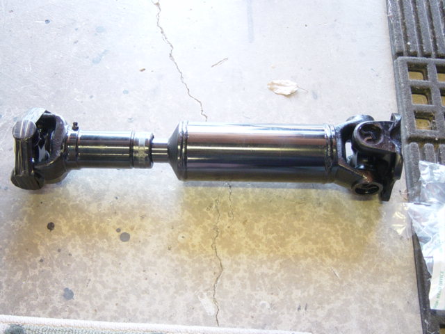

Here are the Spicer parts I bought:
(2) 3-2-119 Flange yoke
(2) 3-3-2591KX Slip yoke
(2) 2-40-1711 Tube shaft
(2) 3-28-47 Tube yoke
(4) 5-178X U-joints
These are found in Spicer's catalog J300P on their website
www.spicerdriveshaft.com
I paid $ 450 for the above, and still need to have them
welded together and balanced by my machine shop.
These parts go together with 2.50 " .083 " wall tubing,
and when finished look something like below.
Thanks to Dave Harris for the photo.
Check with Lynn on the length of the tubing needed per side.
My guess is around 7.00 ".
Regards
MikeD

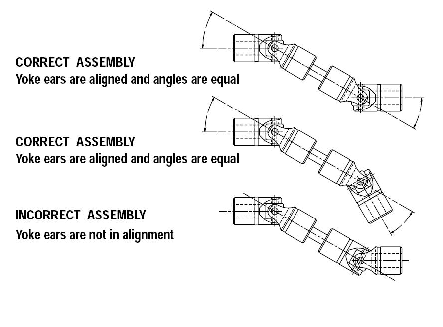

I suppose this is as good a place as any to put this.
I had a brain fart last night when I reassembled my half shafts and looked at them wondering, "are those u-joints in phase?" I couldn't recall which way was the right way, but I knew that they needed to be right or they would vibrate.
So I looked it up on google and here is a diagram to use as a go by:
