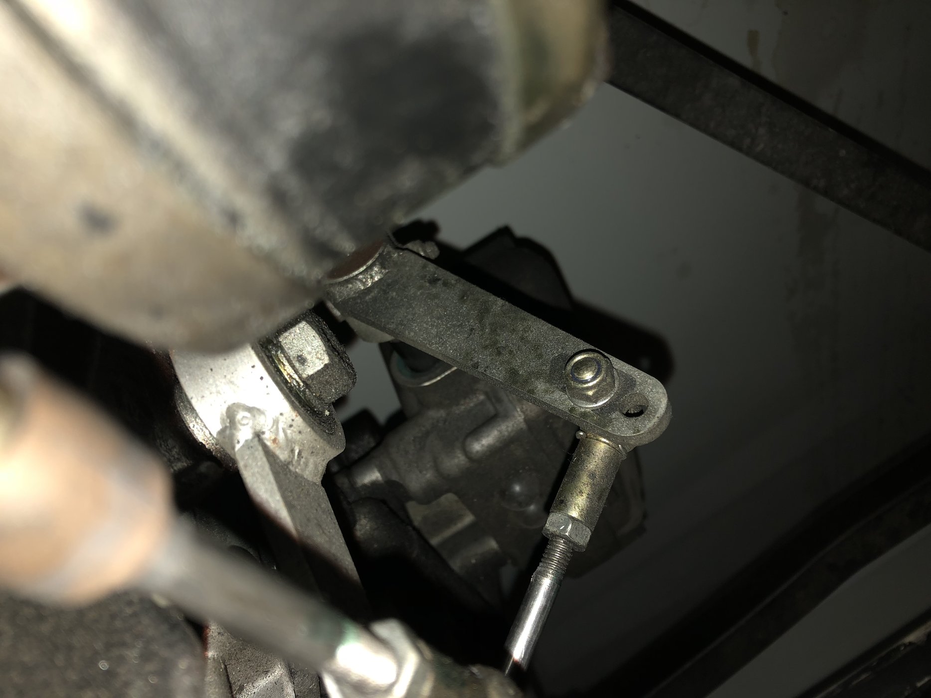

@ Dave, you are correct - But I only have two holes (see picture).
Question: to reduce the force I need to extend the lever - so I would change to the outer hole?!
After you changed the hole - was there the need to adjust the cables?

Markus,
I moved from the outer hole to the middle hole on mine. It's counter intuitive because you would think it would increase the force required, but I found it reduced the movement and some of the resistance. I didn't need to adjust the cable. You're already in the hole I recommended. As I said most of the resistance seemed to be in the RBT itself. Maybe it's worth opening the linkage box on the side of the trans?

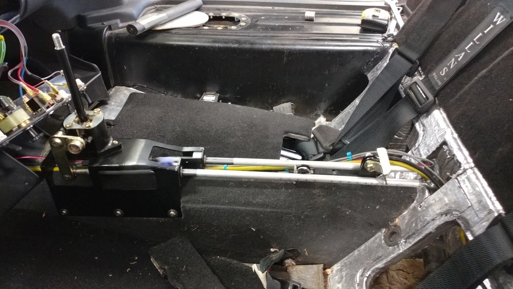

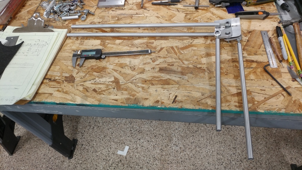

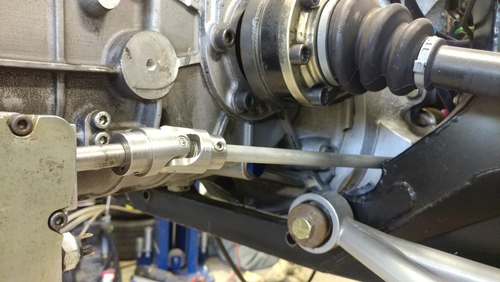

After putting up with very heavy shifting for years I finally pulled the cables out and found them to be the problem. Almost impossible to move them by hand. The car was well out of warranty by the time I got it running. I started building a rod shifter but the project is currently stalled. As this is keeping me from driving the car I looking for suggestions for a supplier for some good shifter cables. For some reason there is a 4th picture that shows up if you view them. The 4 picture is not mine!

Thanks Neil I'll give them a call. I have a ZFQ transaxle and a Olthoff shifter upgrade. The cable that goes over the top always seemed 2 or so inches to short and the geometry of the shifter arm a little off because of it. Thanks again.

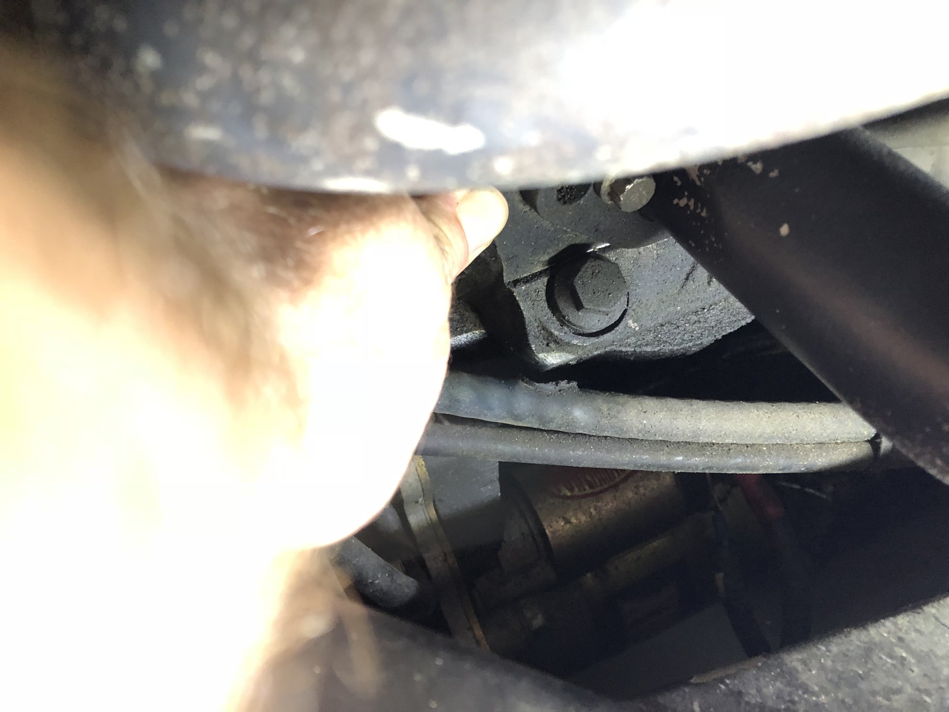

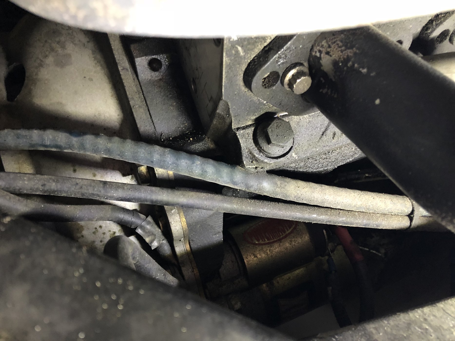

- the other cable is touching the engine block and the outer liner is already melted (to fix this I guess the cable should be longer!?) – see also pics.
