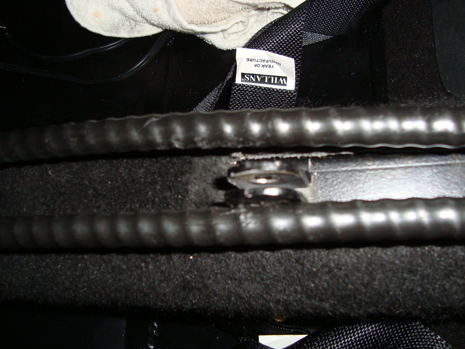

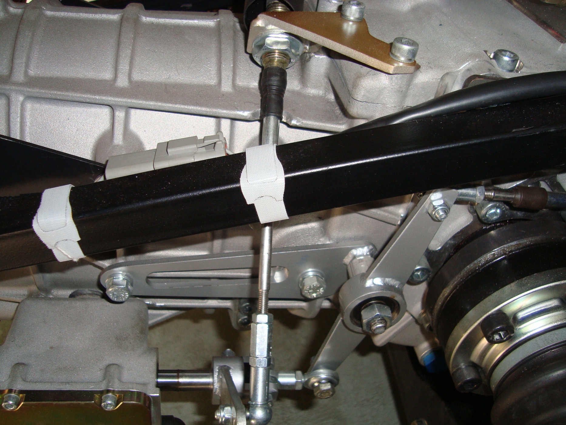

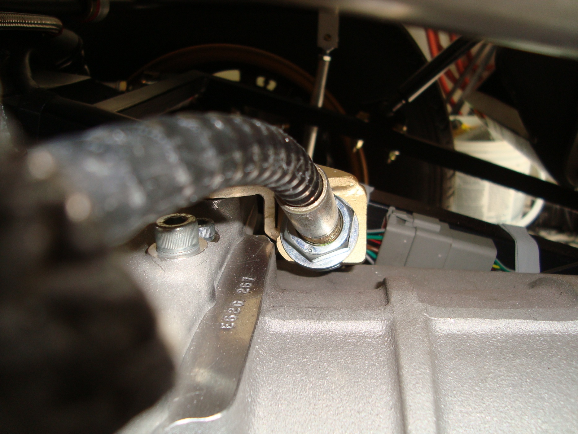

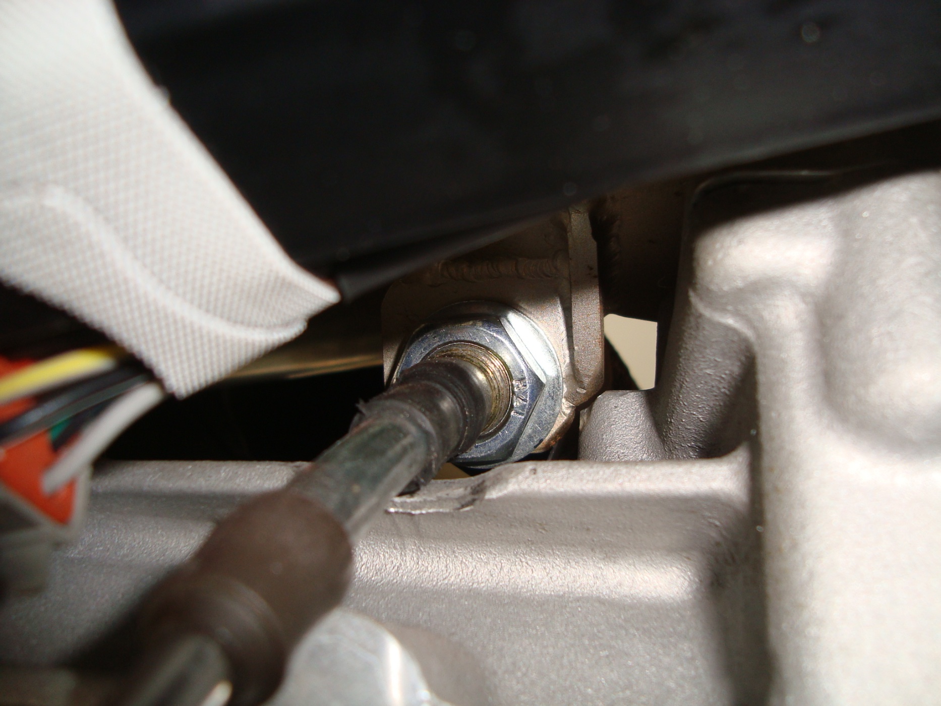

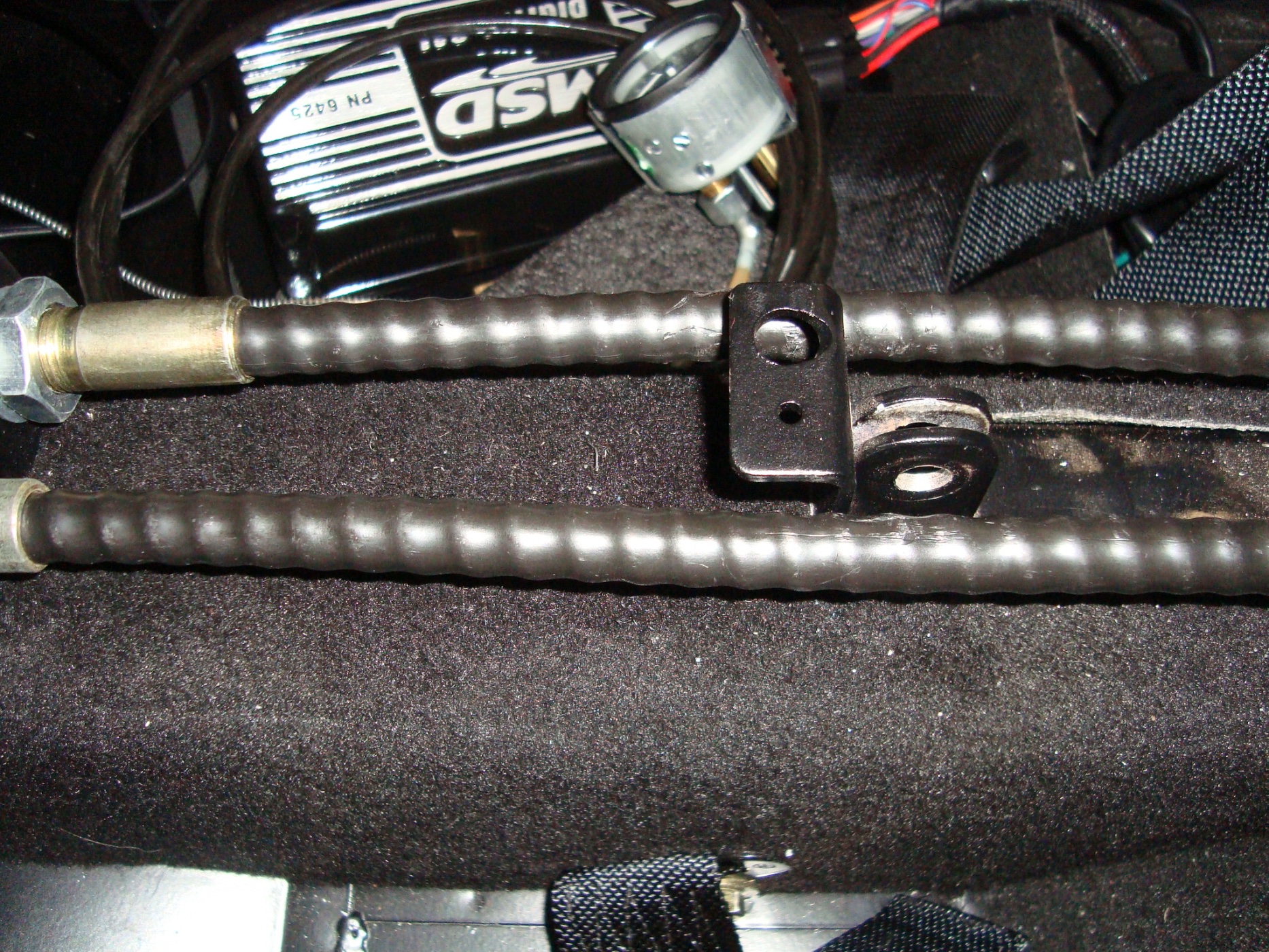

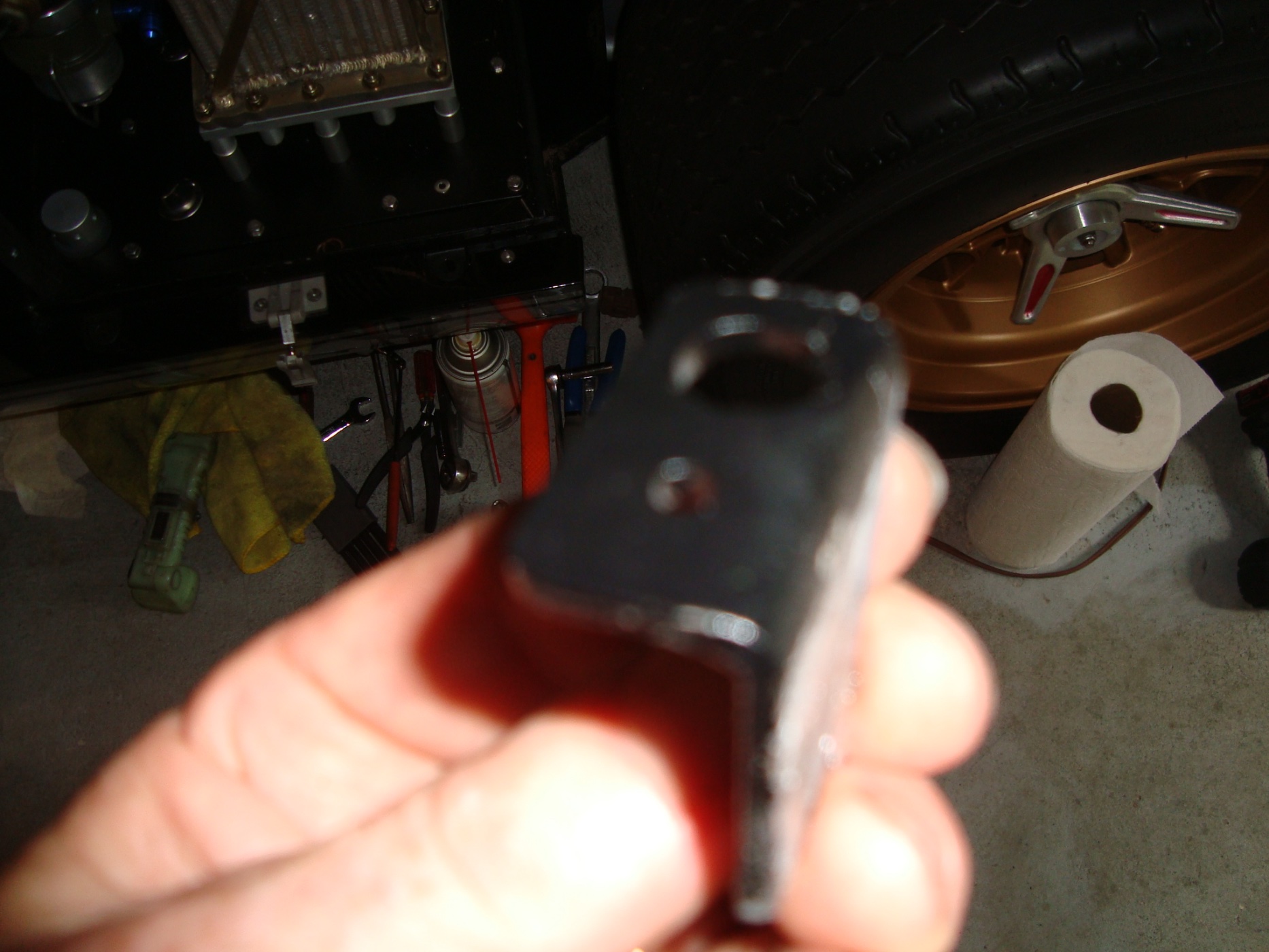

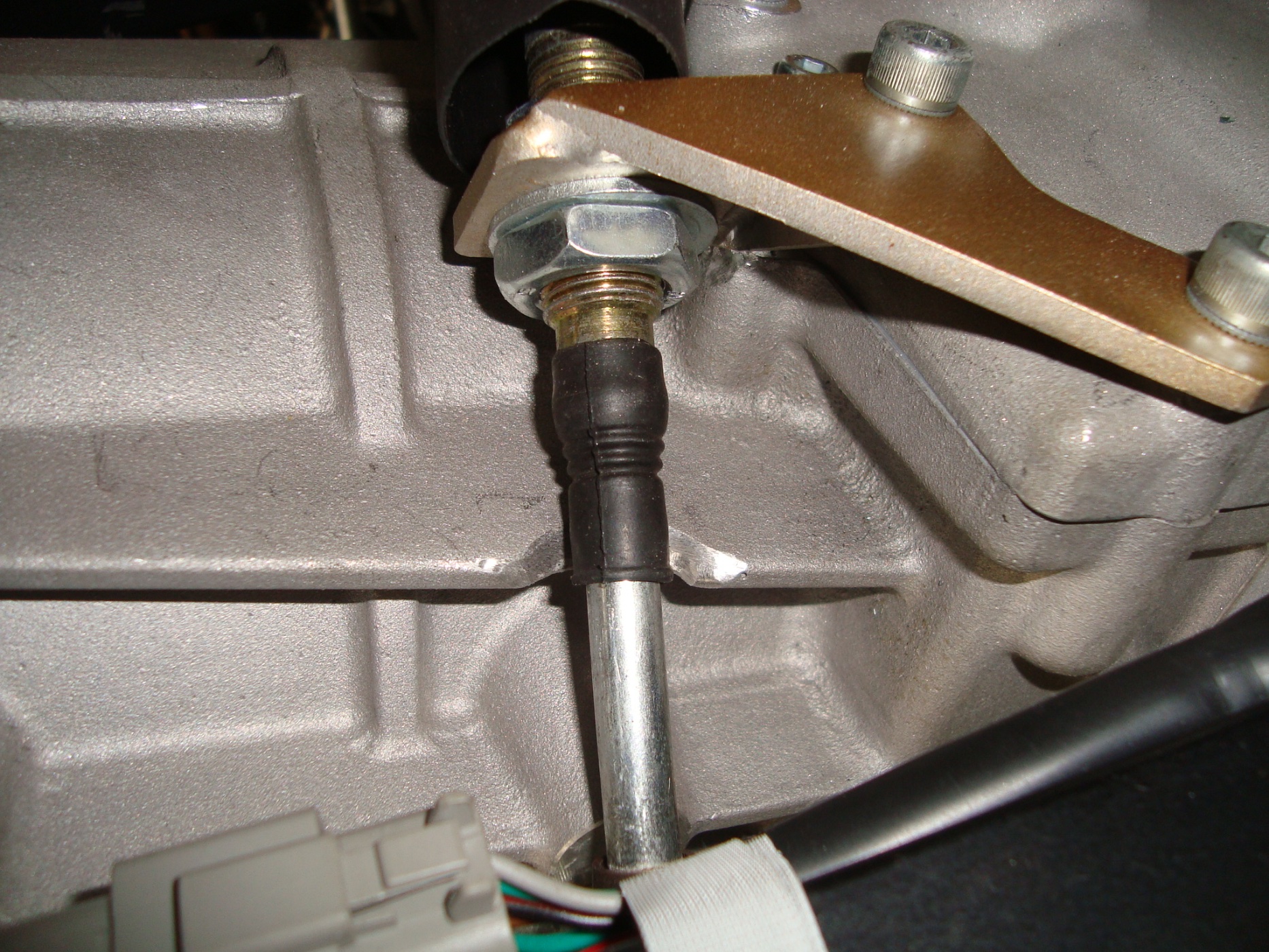

Chris, here are the pictures. Subtle changes but they did add up. Moved the parking brake to under dash so cut off the small tab at the original parking brake handle (last pictures). This took some bow out of the cable so now a straight shot out the firewall. Rotated the transaxle bracket and added some metal to extent it along with some case relief to line up the over transaxle cable to the shifter arm below. Hope this helps.
