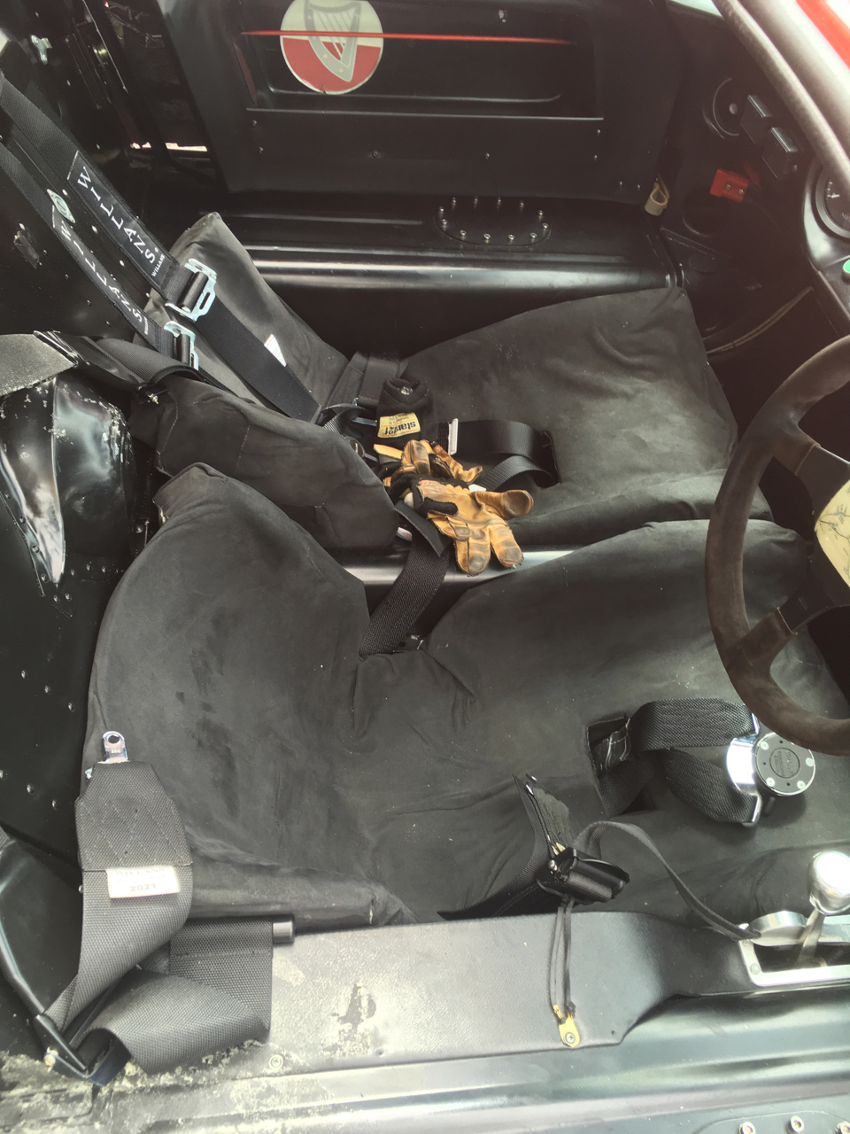

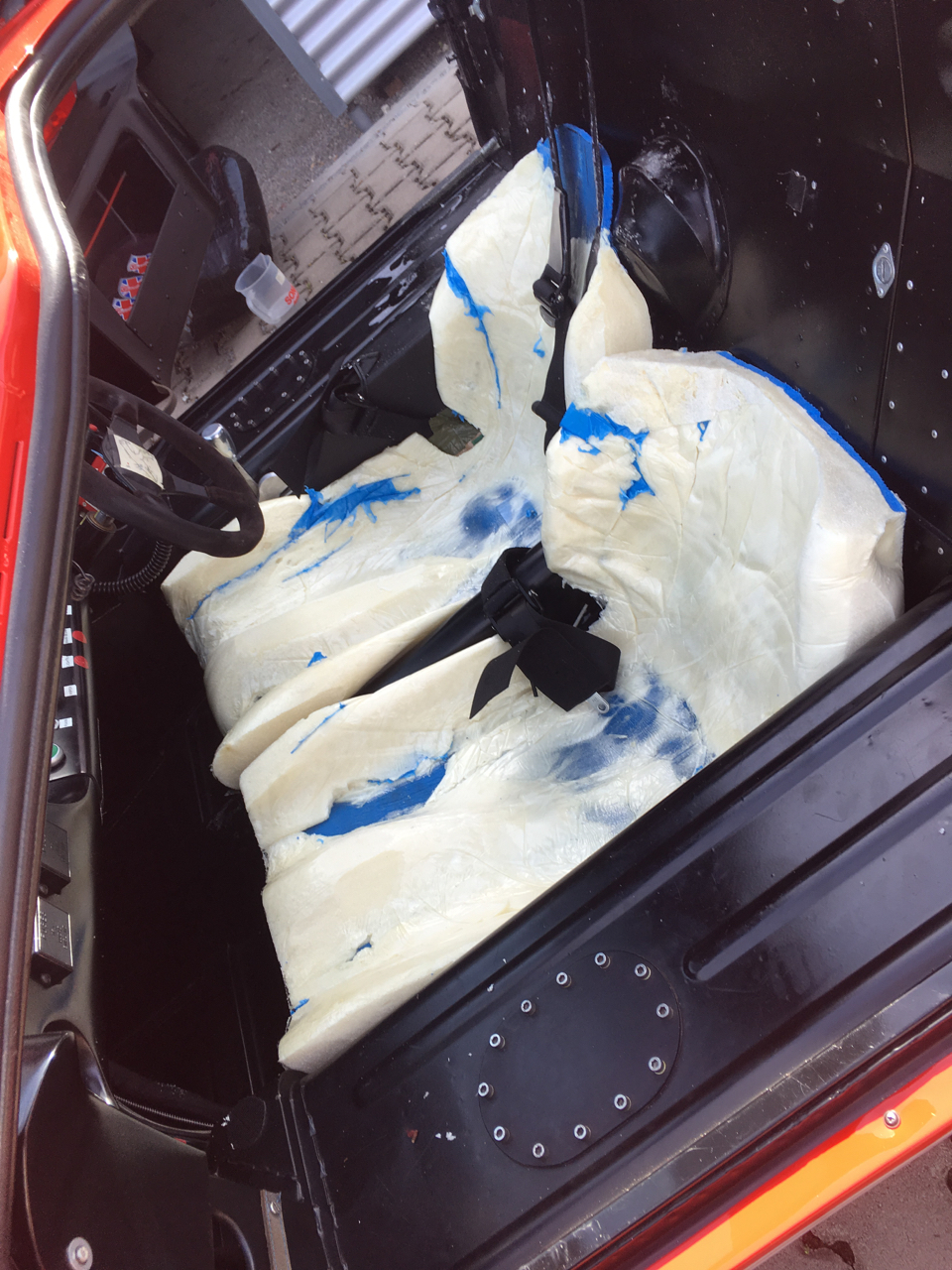

I foamed my seats right inside the car, using rigid polyurethane 40g/l density foam. After peeling of the trash bag, which was used for foaming in place, I coverved the seat in alcantarra, using Pattex spray glue. Here is the result:
The only two mishaps were :
1. fogot (or too lazy?) to mask the surrounding area with painters tape, hence the PU spillage stains, which will take patience and time to get off.
2. the seatbacks are too low. Therefore heat from the firewall warms ones shoulders more than needed for comfort.
So I'll do them again. I also wonder where to attach the upper end of the seat back. Any hint or idea is appreciated.
