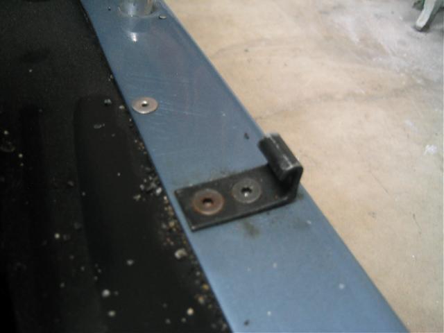

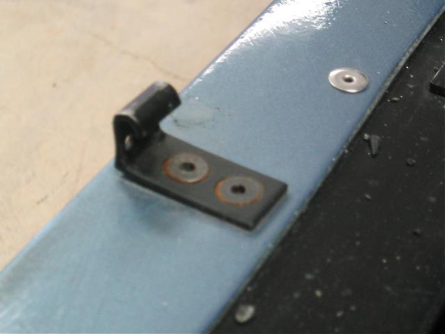

Dean,
I'll try to get a few pictures of mine for you later today. Are you using the latches from Pegasus? If so,you have to weld on a 90 deg tab to the part that attaches to the chassis.No big deal though.

Thanks everyone, as usual, Problem answered before I got out of bed today. I love this sight.
Ron, that is what I was looking for. I suspected that but wasn't sure.
Dean,

Yes, they come from RCR. They are the same that Pegesas sells. They still need to be modified. I am sure if you ask Fran to do it for you he will. He has been very accomidating to all my special request. I really don't think it will be a big deal. I have to weld up some other stuff for the car today anyway.
