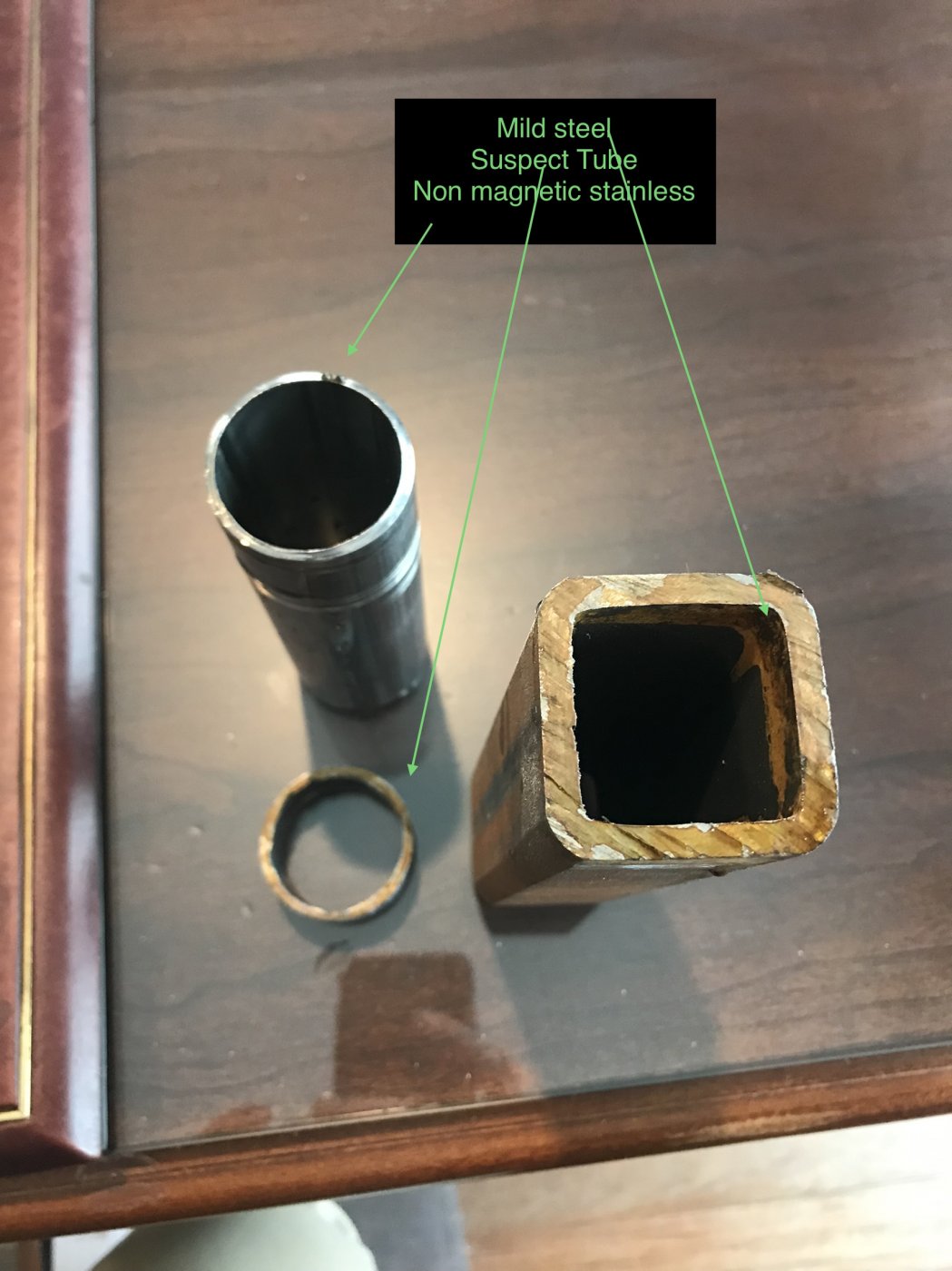

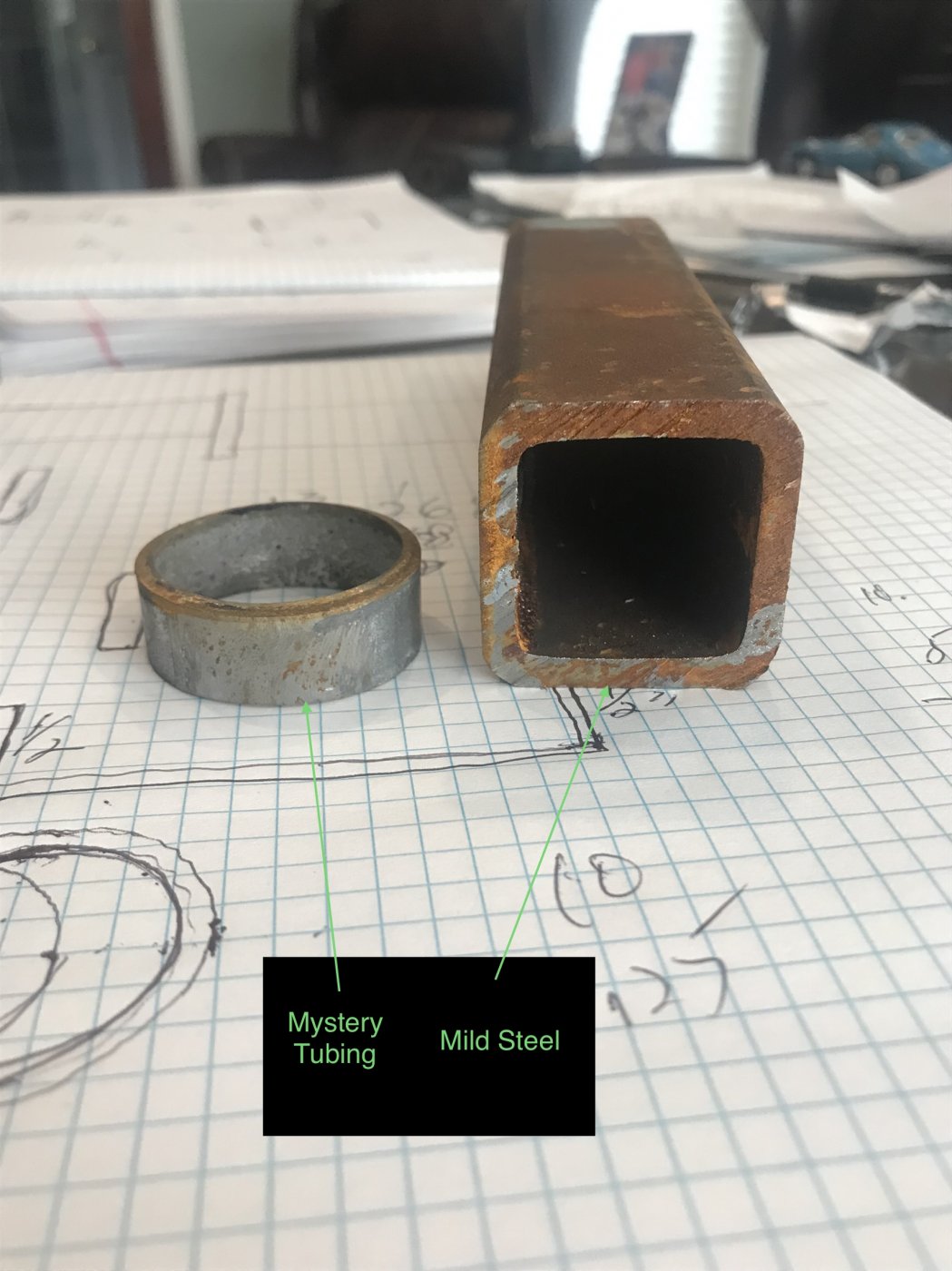

Thanks everyone for your replies. Well, just to close this thread out I decided to replace the sections of the magnetic tubing. My conclusion is those two pieces are not 304, but some other grade most likely 409. My little experiment leaving the pipe outside Showed some rust after 5 days.
Here is a pic of the tubing vs, Mild steel. The tubing certainly didn’t rust as much as mild steel, but not looking pristine either...
The area on the side that rusted I cleaned up 5 days ago with a dremel to take any oxidation or coating off…

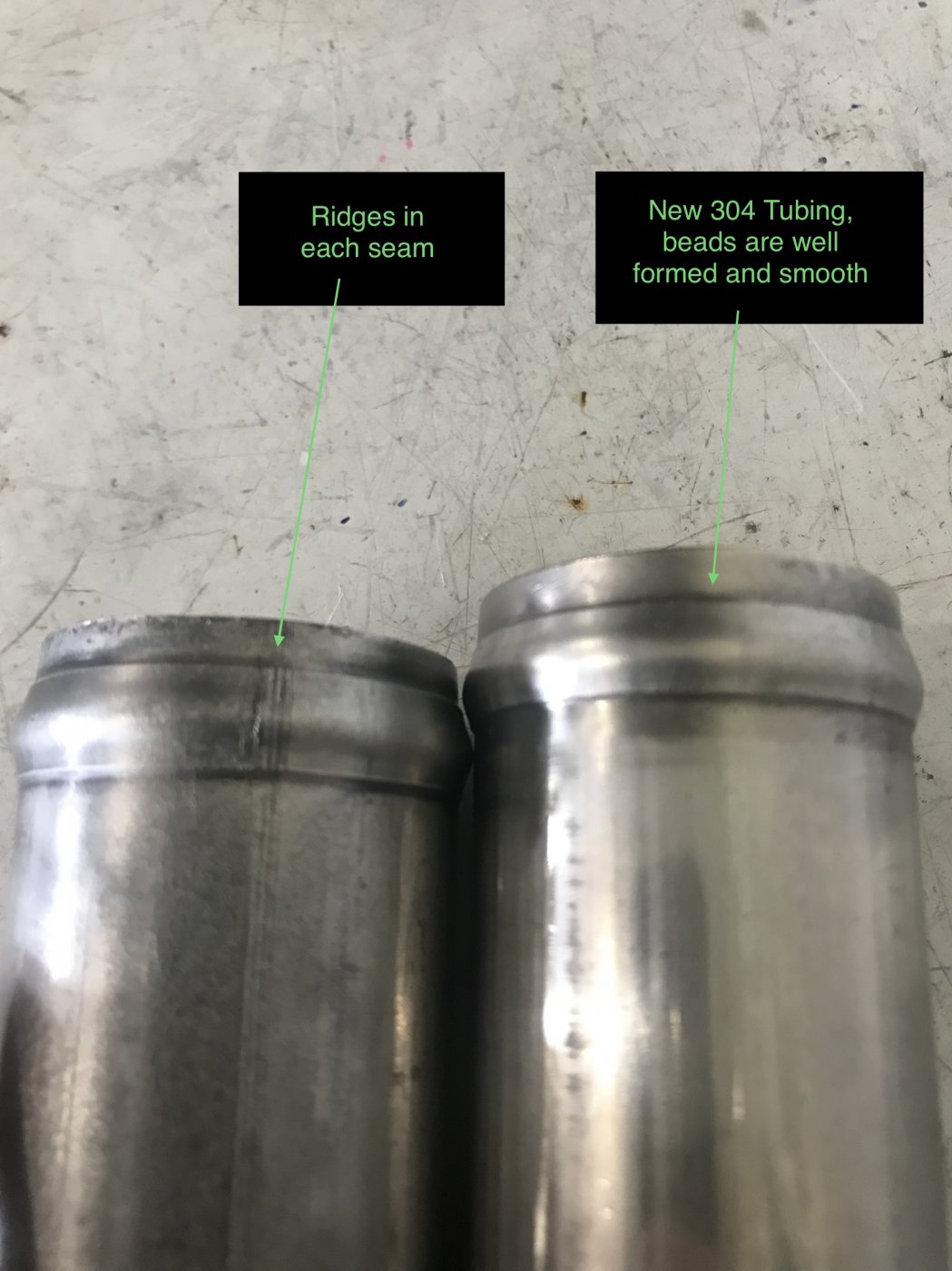

Lastly, both magnetic tubes had these ridges down the weld seam. To me, any hose end may have had trouble sealing them so after realizing this decided to replace them with some tubes from Verociousmotorsports. They have very good prices on tubing and will apply the bead ends as required. Now on to finishing the cooling tubes…
