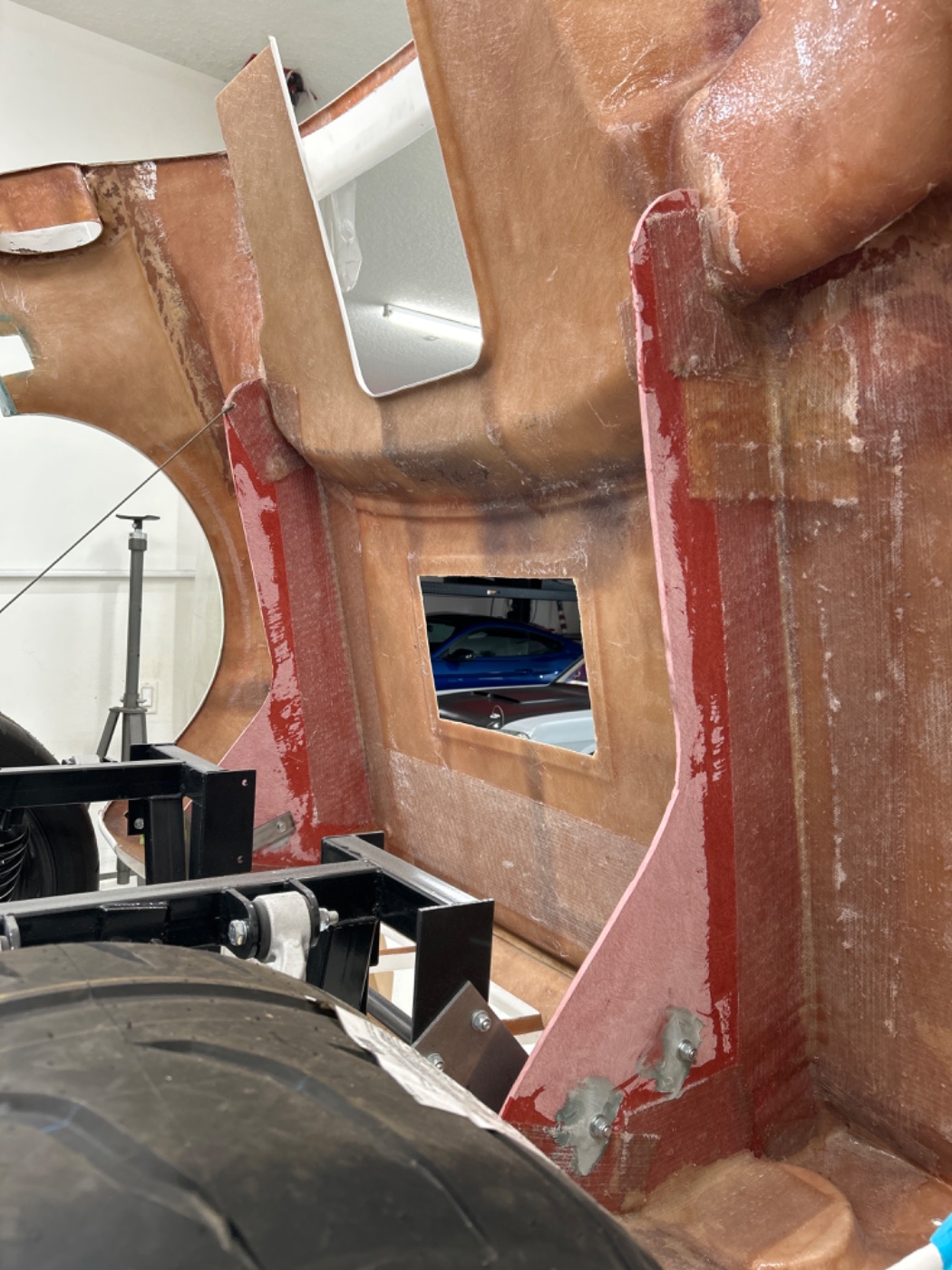

I'm in the process of planning on how I am going to construct a new inner wheel tub and front corner structure of rear clam area for my AP build, as they only come with a 1/2 wheel tub and no front corner inner clam structure. Right now I'm thinking epoxy and or resin with a combo of 1708 and chop strand mat over the plywood and thickened epoxy to glue them to the clam. I guess I'm debating on if I need "marine grade" plywood for a car that will hardly ever see rain. Thoughts or wondering what you have used to make body panels.

Sounds like you got a sound idea, however I would use insulation foam board in desired thickness. It is easy to shape and light weight and lay a couple of layers of fiberglass matting over it when secured in proper location.
Plywood sounds too heavy to me, would also be susceptible to moisture variations unless completely sealed and encapsulated. I have seen people layup fiberglass on a waxed table, then remove that, trim to size and join it together to form the inner wheel tubs.
1/4” plywood really isn’t that heavy… and no heavier then the pieces from AP that I intend to replace. I intend to completely cover the new pieces with fiberglass and resin. The original pieces weren’t fared in properly. I can see a lot of air gaps. Can you tell I’ve been watching a lot of boat building videos on YouTube?!?
