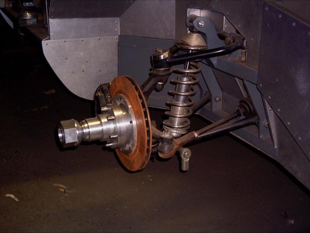

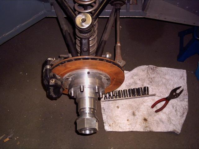

I omitted most of the dimensions, in the case of the wheel they would be particular to that wheel only. The hub would need bearing bores to fit the particular upright being used, and bolt holes for the wheel pins and rotor hat would need to be drilled and tapped. My dimensions are particular to my setup.
On the hub there is a 3/8" setback to allow for the adapter, and the adapter is drilled thru. This could be left solid with only space for the bearing retainer nut and cotter pin.
The 3/8 setback on the hub allowed me to keep the original 56" track width. The original hubs had a 1/2" thick flange, and machining off 3/8" would have left next to no material for supporting the adapter. I kept the stock location for the rotor hat, just beefed up the area which didn't add much weight at all.
The photos aren't great, but give a good idea of how the parts look.
Hope some of this helps

John:
You are welcome. I realize that the photos are of poor quality, and there are dimensions missing, but I fabbed these parts to fit a particular wheel, and they would not necessesarily fit other types.
The hubs I had on my uprights would have worked with a wheel such as Vintage or Trigo etc., except for the added 3/8" which put me too close to the bodywork.
The snout on the adapter has a thru hole as I wanted the same look as original, and I simply plugged the bore about 2" in to seal off the front bearing.
The whole setup weighs about 2 lbs.
I had originally wanted to O-ring the area between the adapter and hub, but the fit on the hub and face of the adapter was so good we left it out.
