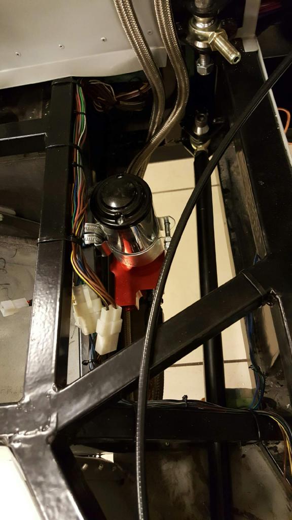

Fuel pump, mounted below tank top level to ensure good suction

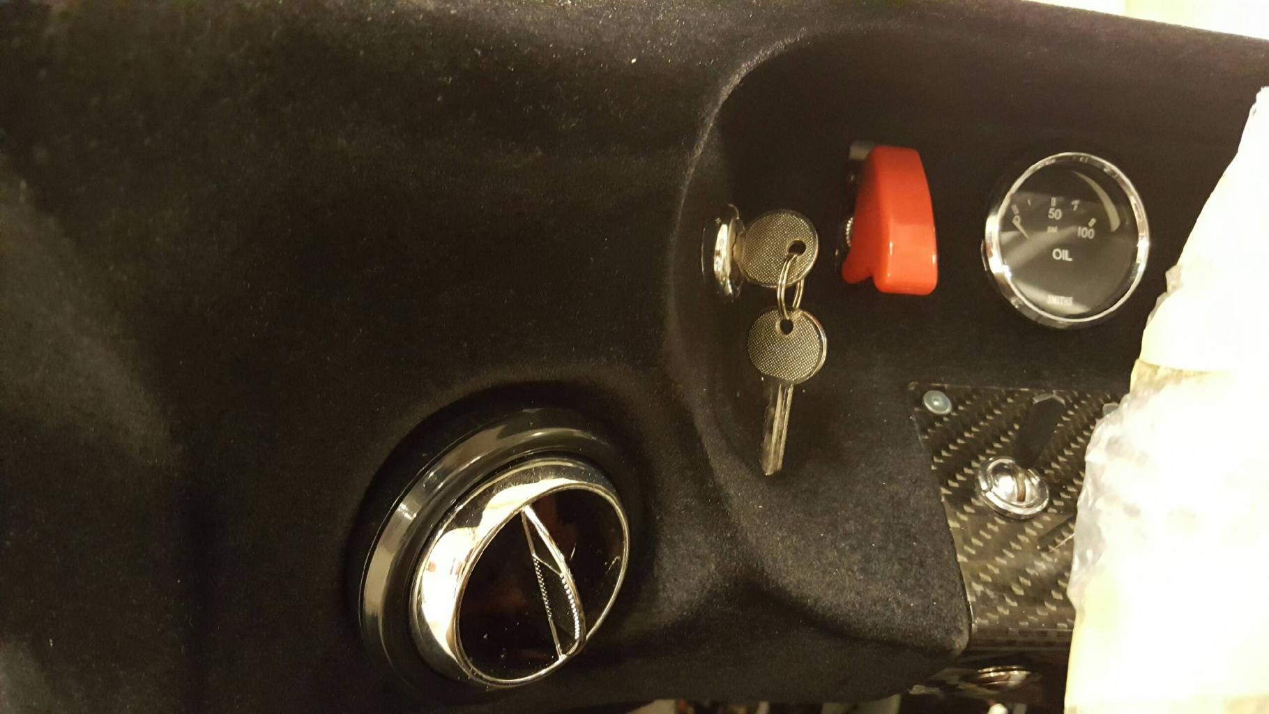

Nice small airflow regulators. Carbon panels on dashboard are made by Sweden Composite.

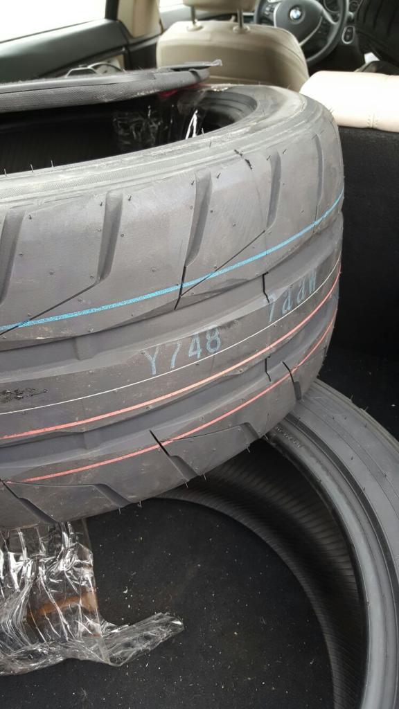

New rims ordered from Bailey SA. Went down in size to 8"/10" so also ordered new tires. Nitto NT05 from Summit Racing.
Looks really nice! Thanks for advice in the wheel section on these.
225 front. 275 back

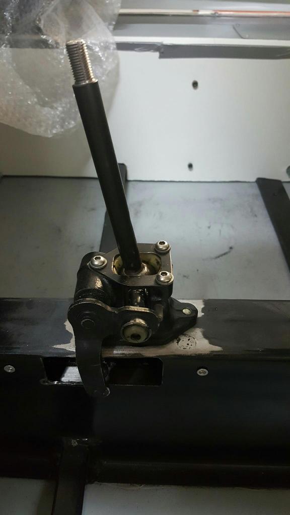

some updates....Olthoff shifter mounted, cable to be added.
Any advise on nice leather cover for it?

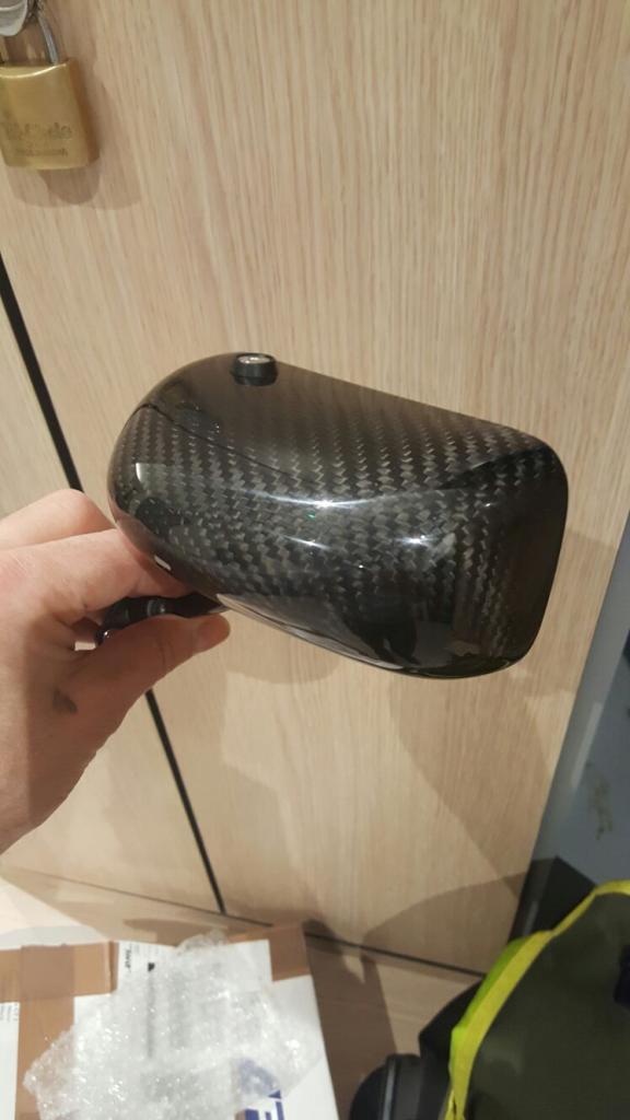

mirrors got the side indicators mounted on them, cable covered by plastic cover on mounting arm

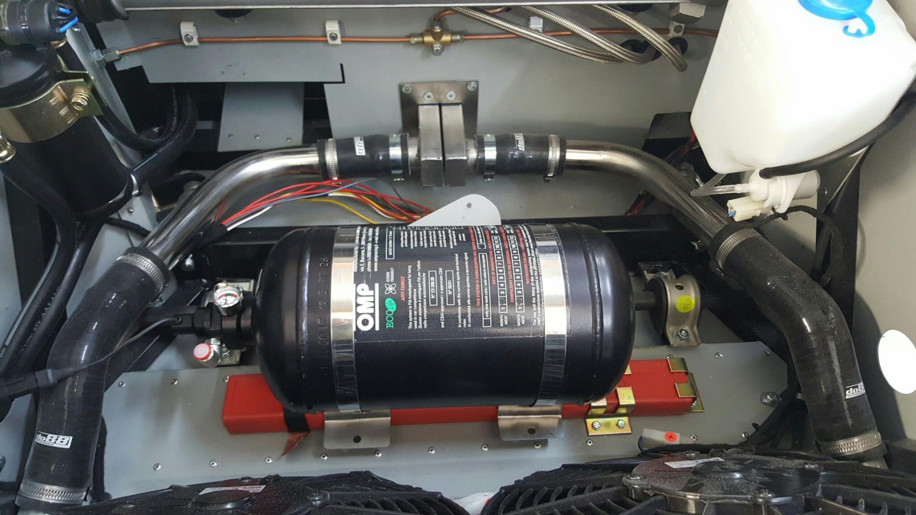

OMP CESST 1
Extinguishing sytem (engine compartment and cockpit) for saloon cars, electrically activated, with control box, tubing, noozles,steel bottle. 4,25 lt Ecolife.
Will be mounted a bit further back above coolant hoses
