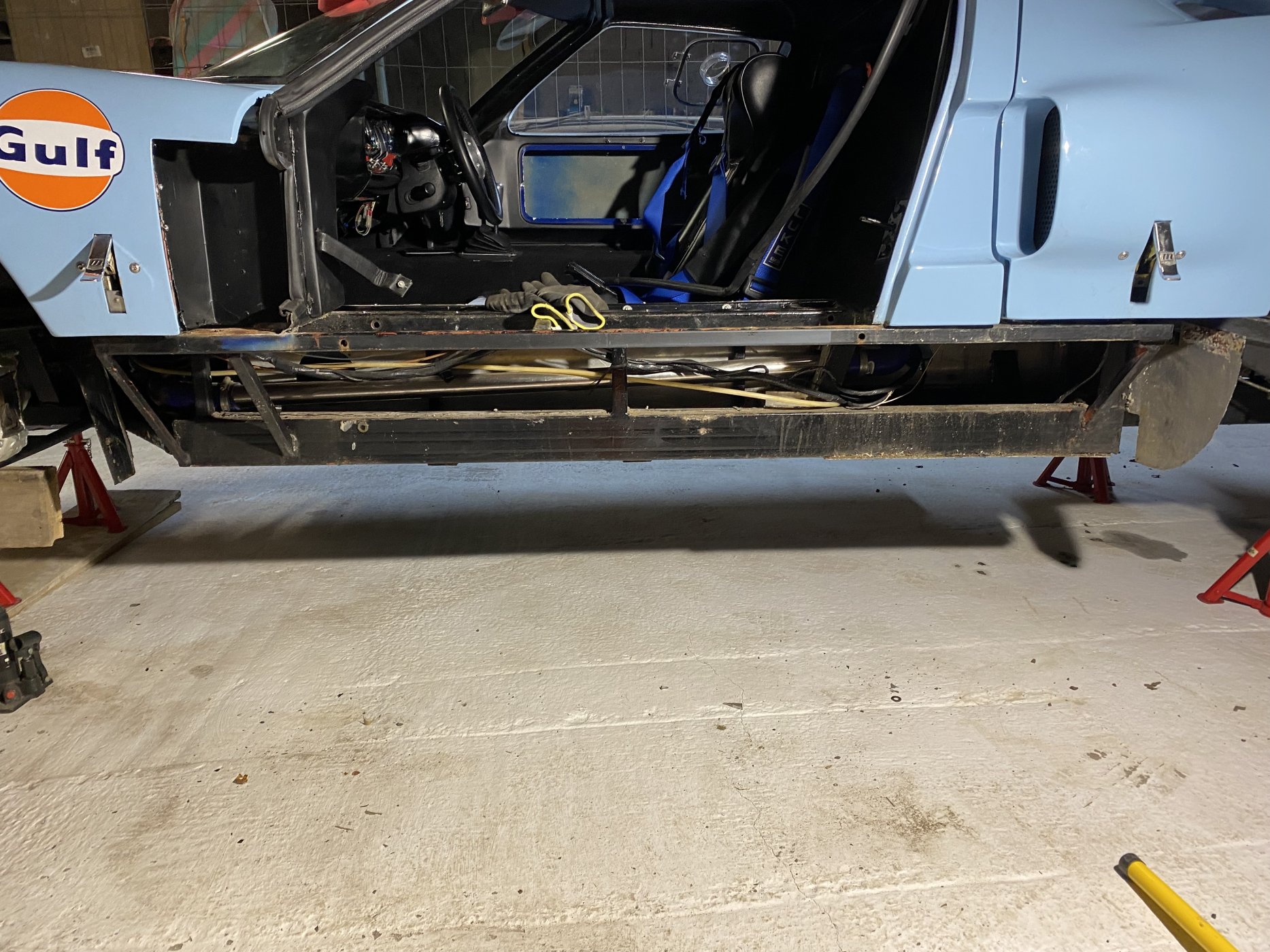

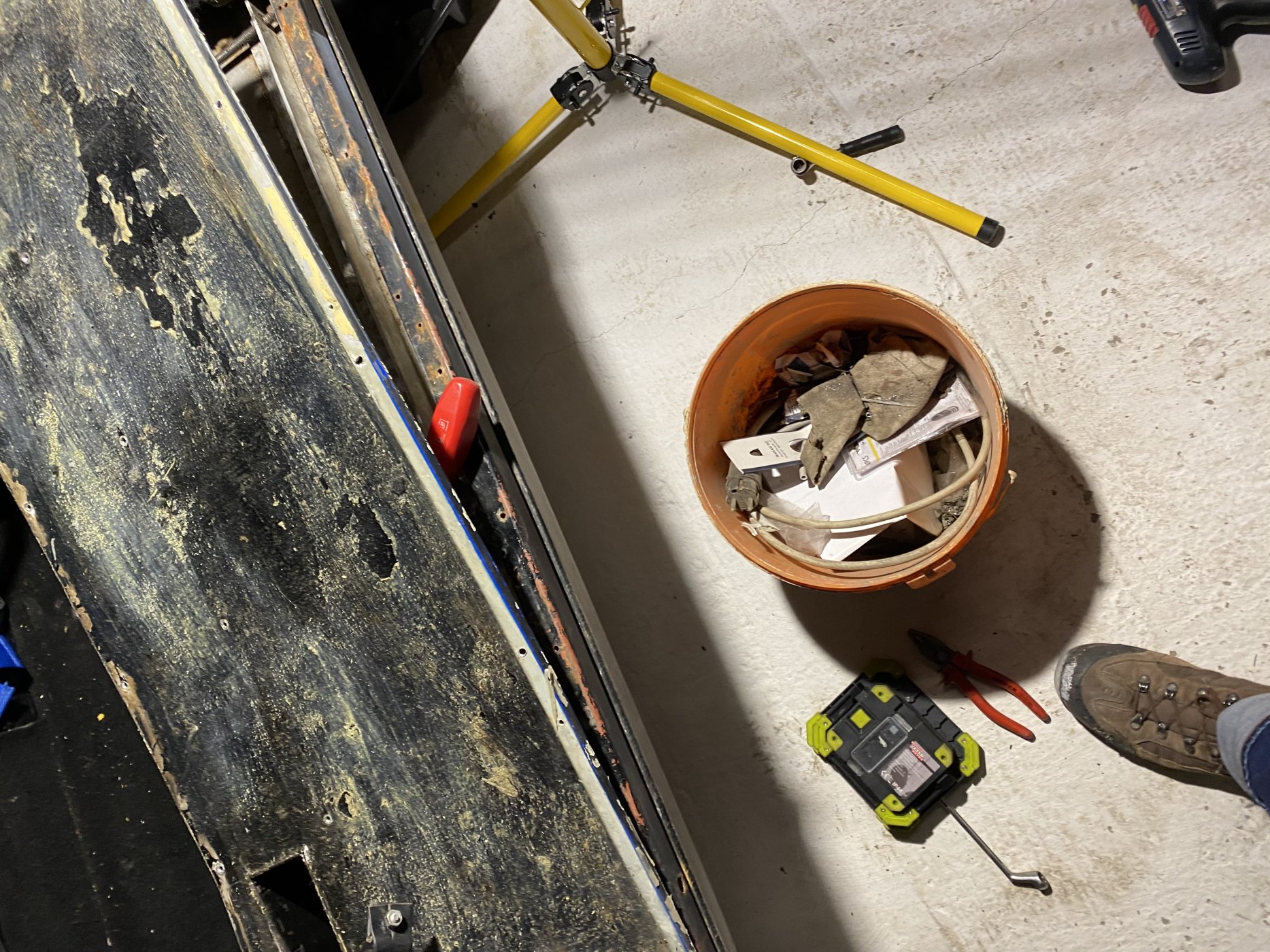

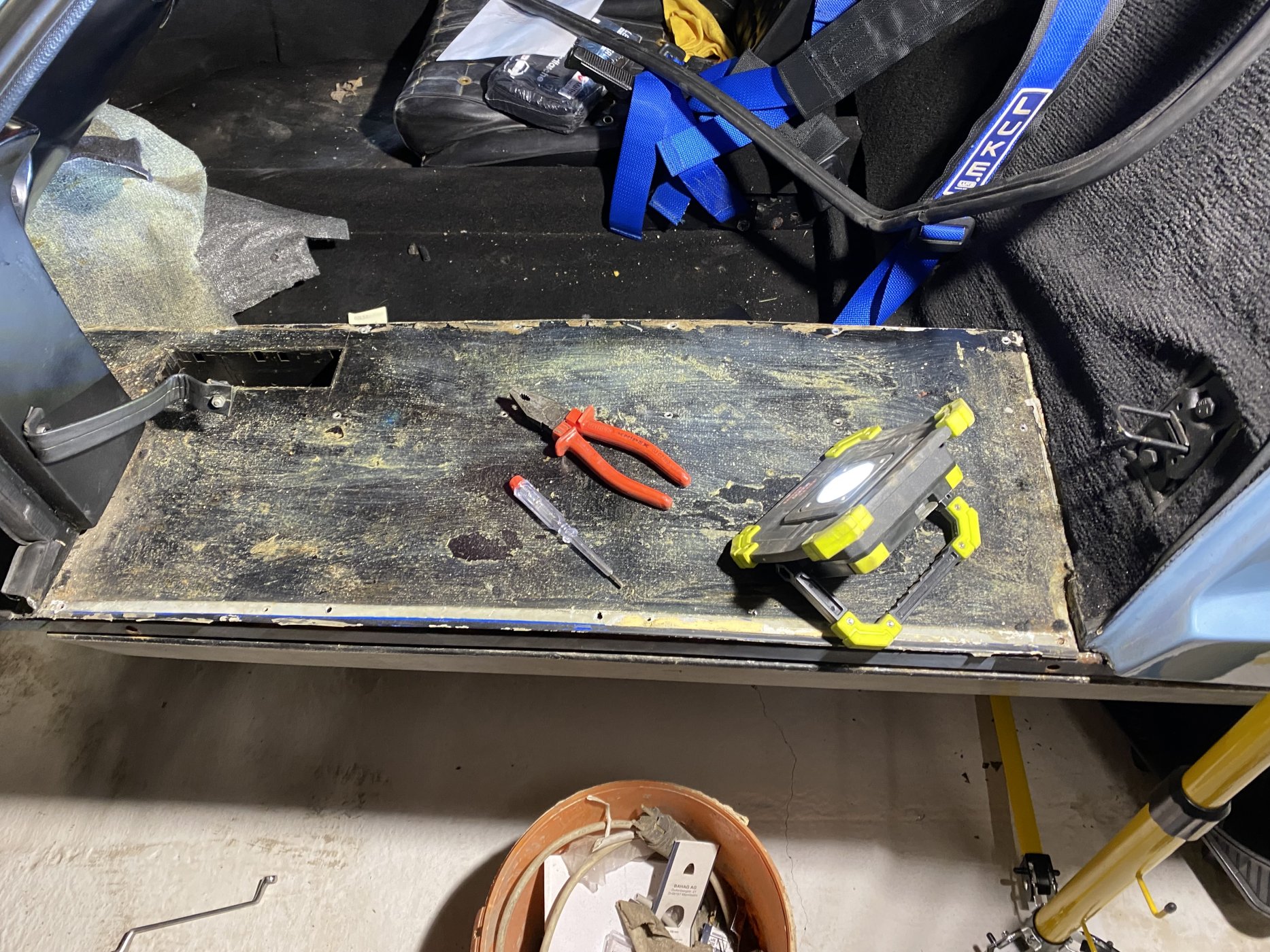

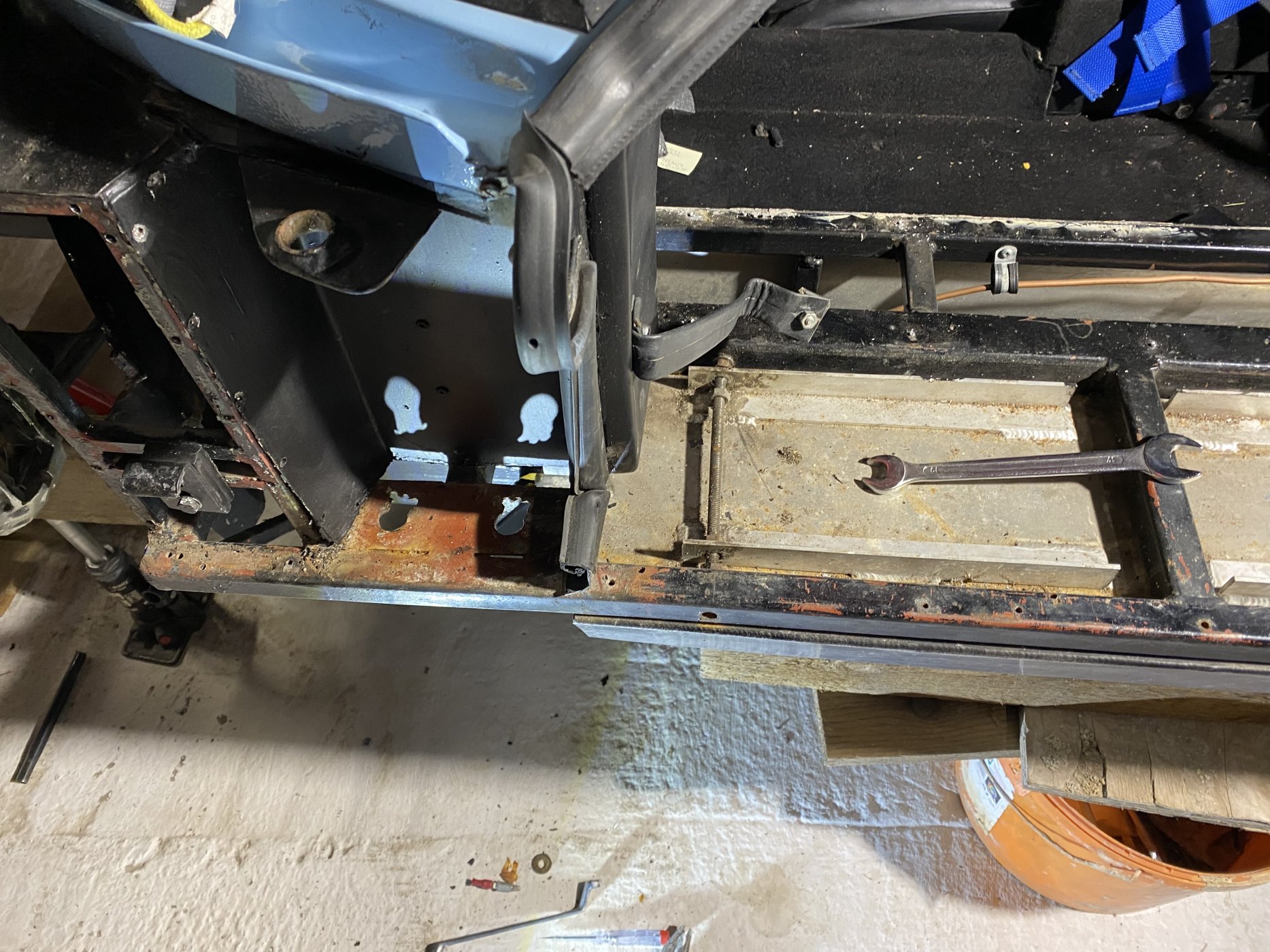

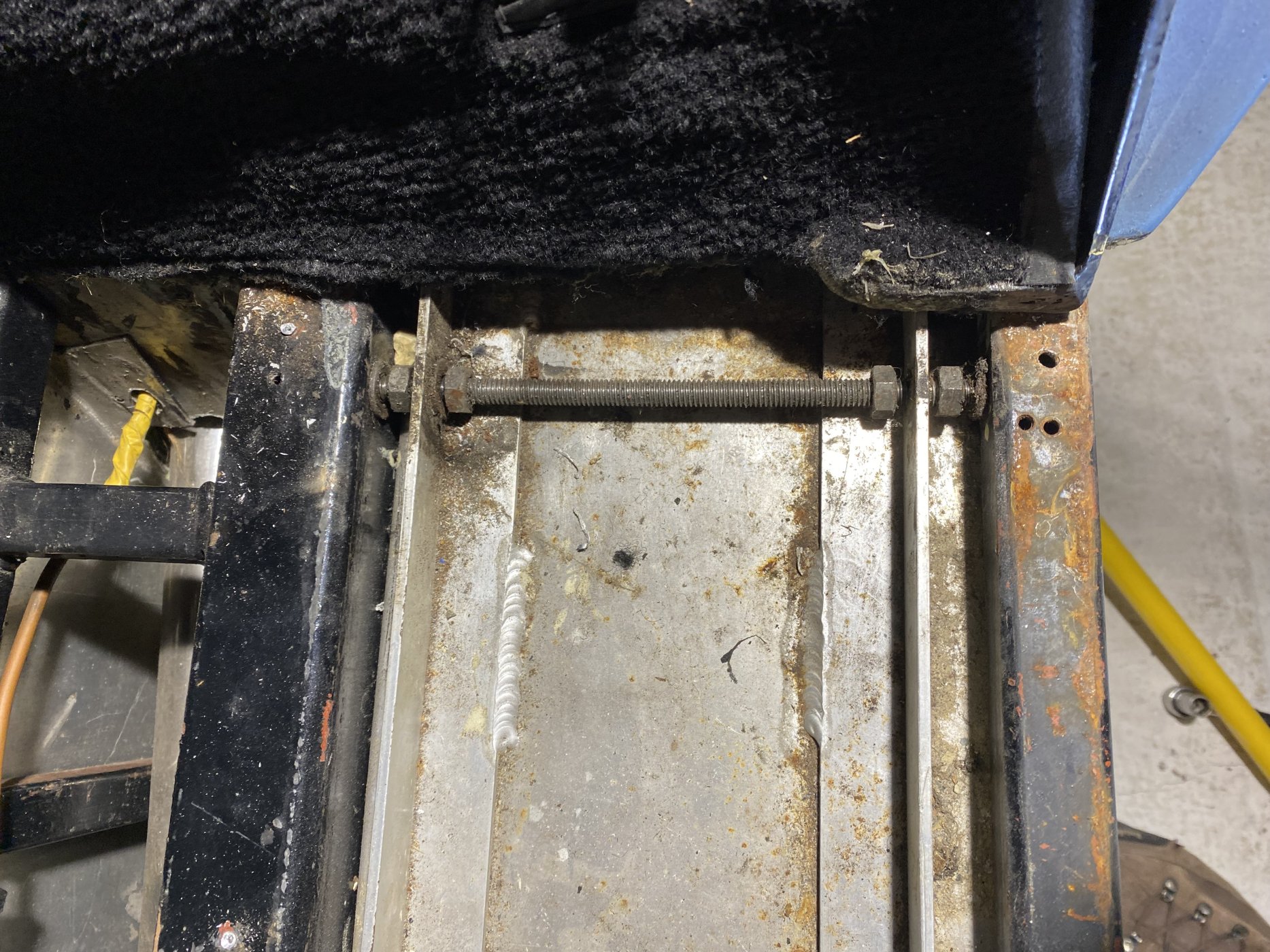

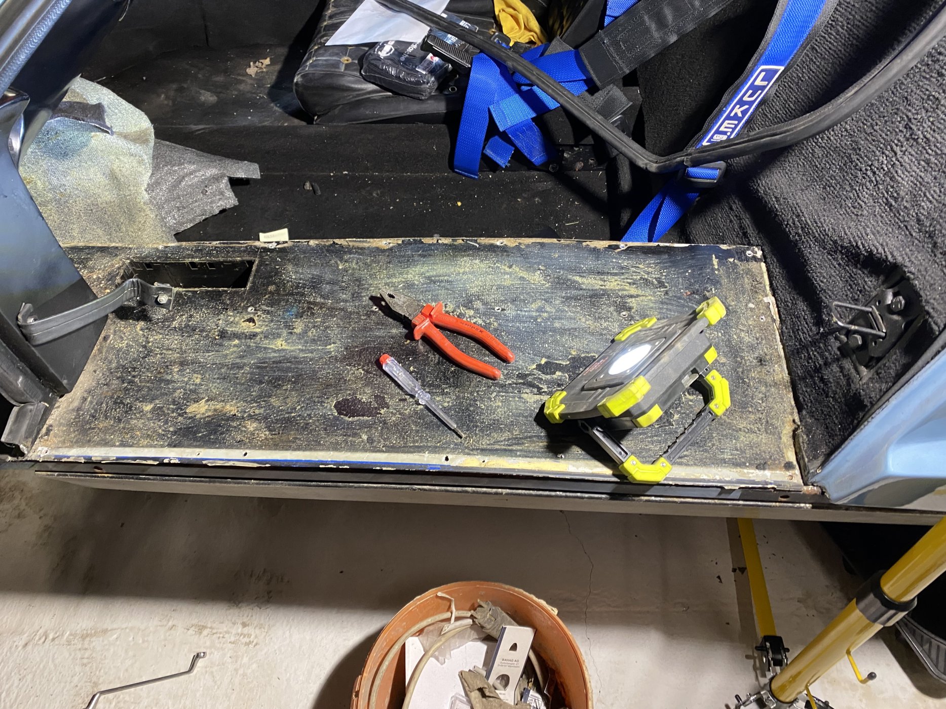

Succesfully removed me KVA fuel tank. see pics attached. The top sheet on passenger side need to be removed. Then you can remove the bolts hanging the fuel tank into the frame. The construction with the bunch pf nuts is a bit wired. Will change that upon remounting with tow screws to fix to each side of the frame.
