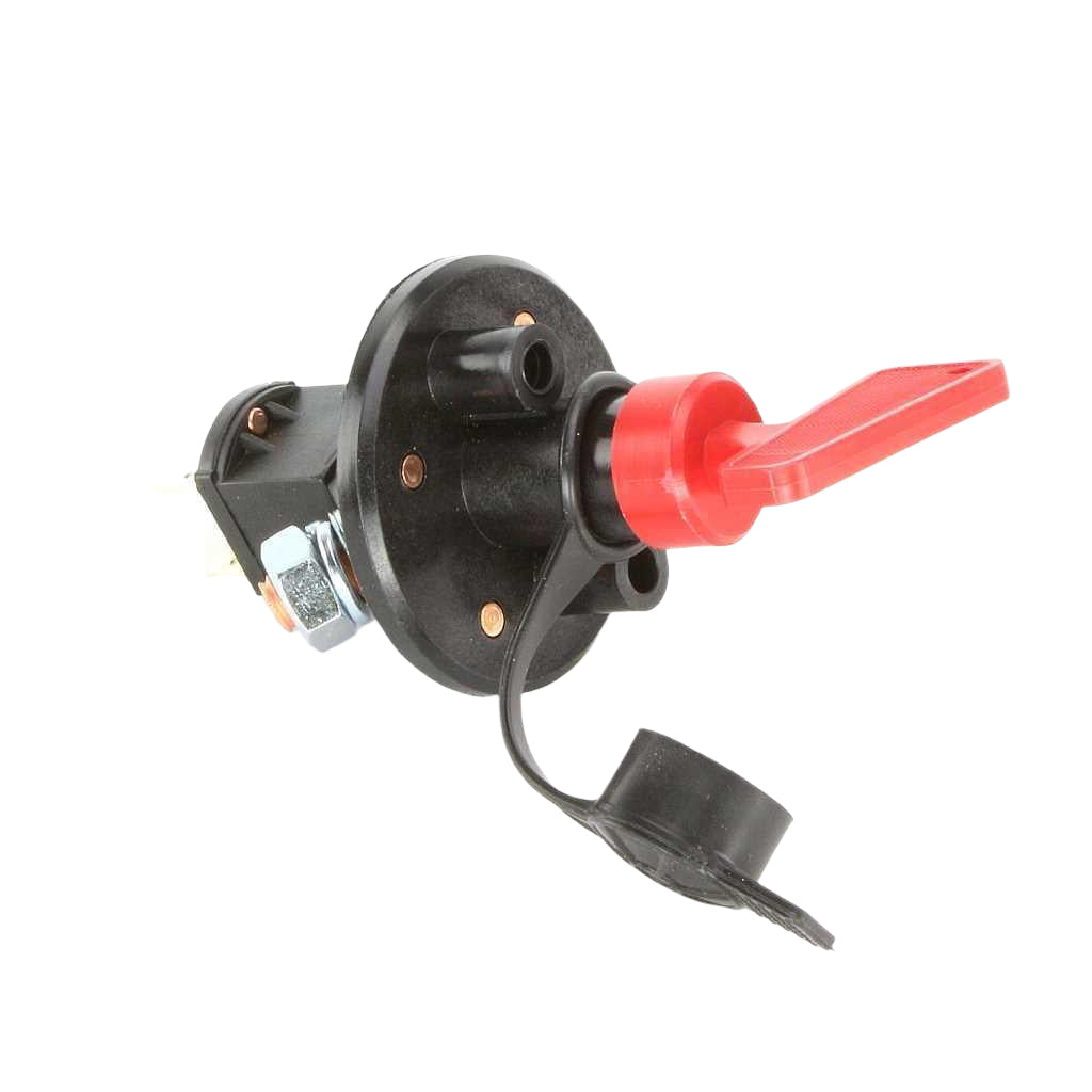

I'm curious if anyone as insight on maintaining memory in a stock GM ECU when utilizing a battery isolator. I'd like to maintain long/short term fuel trims when I isolate the battery. I know I can plug into the OBD2 port with a 12V source, but have no idea what current draw will be. Has anyone done this, and if so, what battery capacity was needed to prevent the ECU from dumping memory for a few weeks?
Shaun
I think some isolators have the ability to provide a small bypass current for just that
This one is what I have
