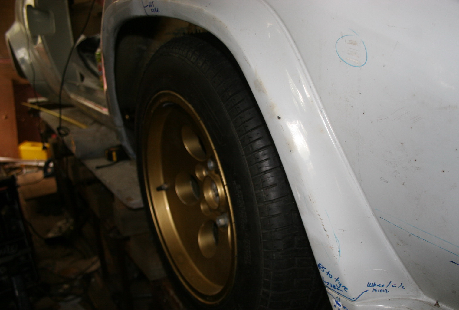

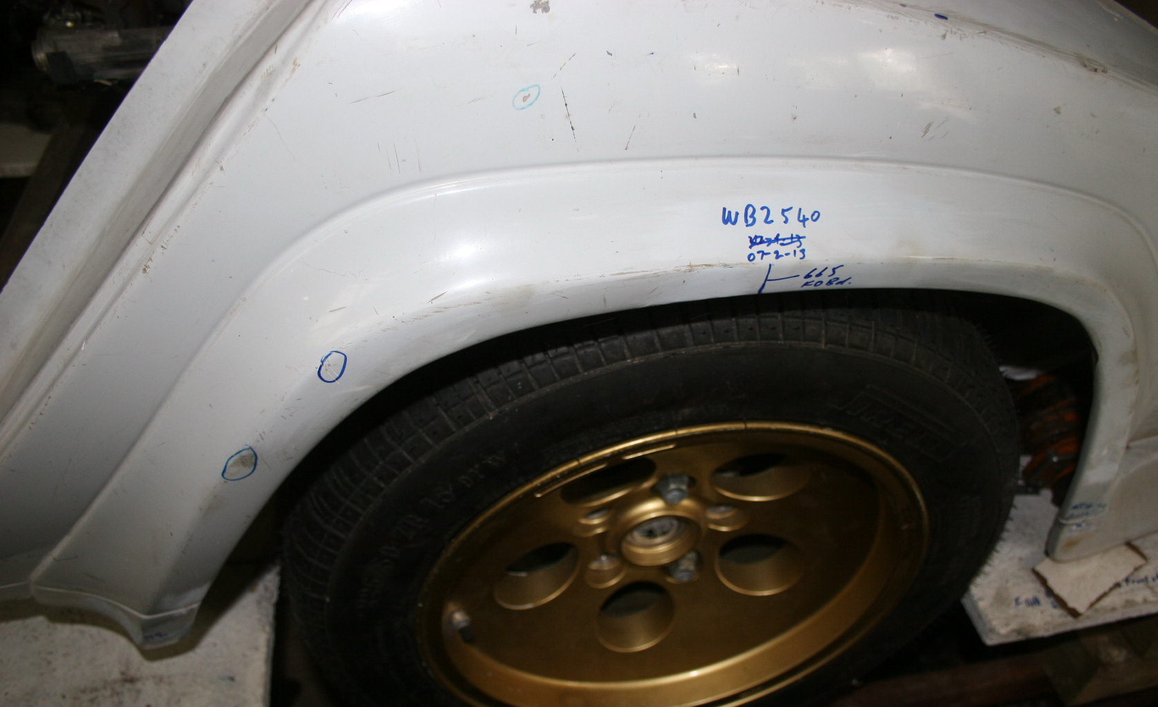

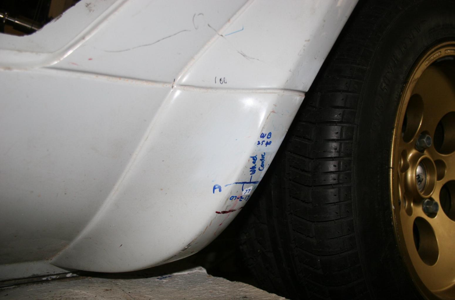

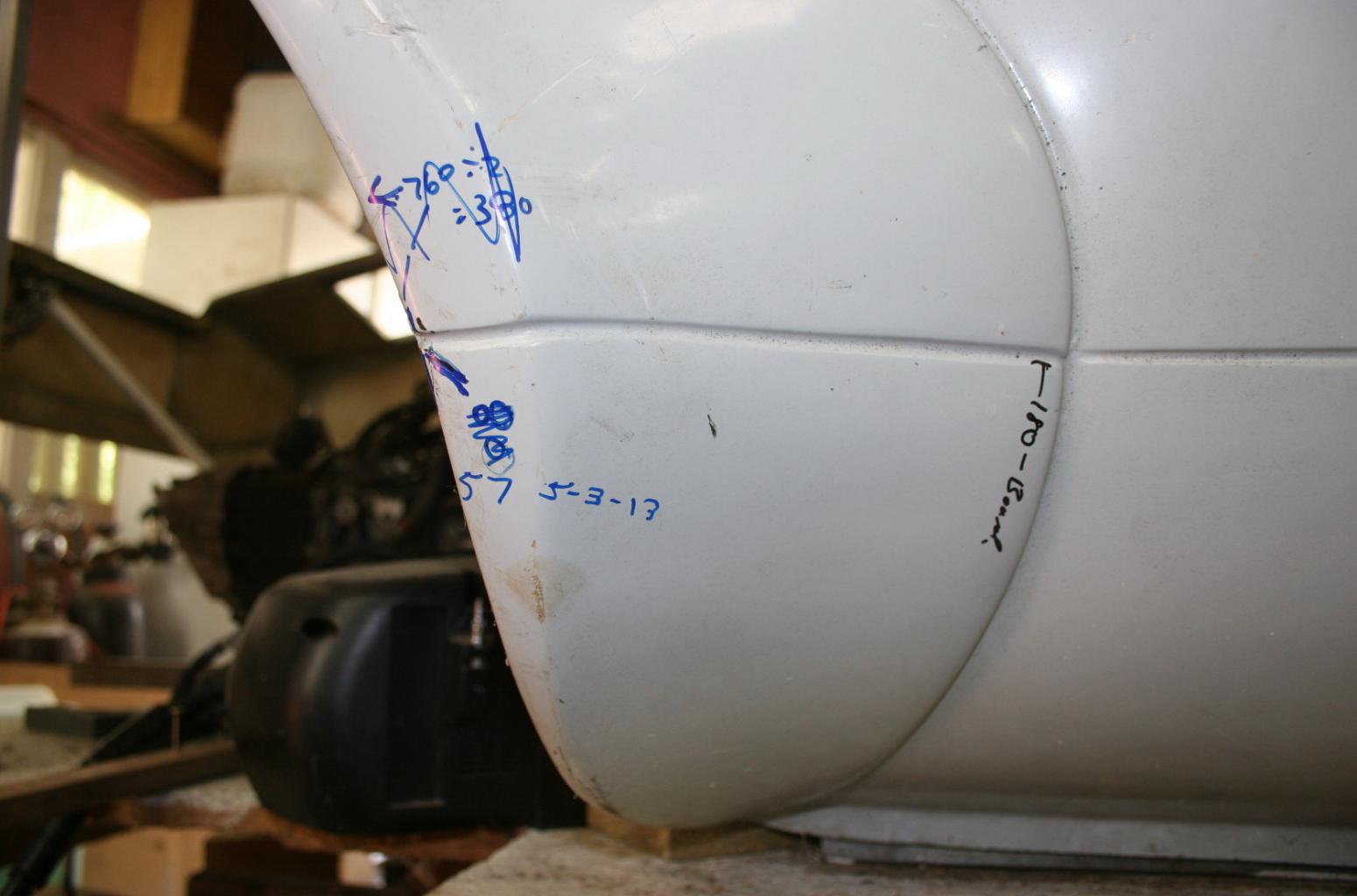

Hi Guys, Many thanks for the advice and tips they will help a lot, it looks like fibreglass is the way to go, as far as copying the parts rather than buying the originals, buying them is not possible as the company that made them has shut down at least 8 years ago, and as far as I can find out the moulds have been sold off or destroyed, and I never signed anything about not making copies. As suggested these moulds will be used to make one set, and then kept just in case of future damage. I have attached a few pictures below it would appear the rears are made in 3 pieces. Looks like as a beginner I could be in for a serious lesson on how to do fibreglass, luckily my friend has done a little in the panel shop so nothing ventured nothing gained. He has suggested after talking to a few people that to hold the shape you can use plastic tube ie garden hose to form a ridge on the back of the mould just to give it some rigidity.

Hello
Ok if that's the case you can mold ;
Do you intend to mold only flare area or the whole wing ?
seems from your pics that the future mold can be if it's only flare in "one shot" ( no separate molds to unmold)
There is a groove on one side to be carefull to mold !! in this area you need to brusch carefully the initial gelcoat and then when cured properly ( means that the gelcoat is gelified but still sticking a little) you need to apply resin mixed with special cut fiber (long 3 mm) or roving "rope" to insert on the groove so this gelcoated area mold will be really in contact deeply with the groove .
concerning the rest of laminating is not an issue due to the simple form you have to copy ; eventually if you want to give more stiffness to the mold you can determine a flange where the mold starts ( bonding small wood blocks with double tape all along and then bonding on the perpandicular face of these square blocks cardbord flange covered by parcel tape or alu tape being cut carefull to copy acuratly the round form)
Yes you are right eventually you can use hose placed momentanly with spots of bondo and then covered by strand matt ( one ply) to rinforce torsion mold
This have to be done minimum 3 days after mold curing , not to impact gelcoat aspect thru plies thickeness
If you can source good stuff in a professional poly supplier it's advisable to buy gelcoat mold ( it's a green or blu color not much more expensive than part gelcoat but made specially for mold purpose)
Buy also "surface strand" 100gr thick (maxi 200gr); this first ply is used to prevent bulbs in contact to gelcoat area and laminated with good quantity of resin and rolled with special "anti bulbs" nylon of cooper groved small roll
Hope this helps:worried:

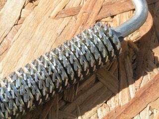

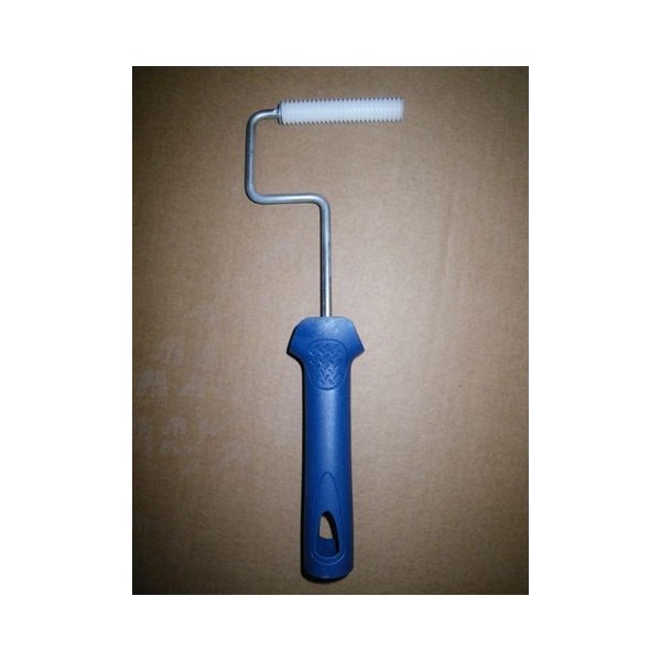

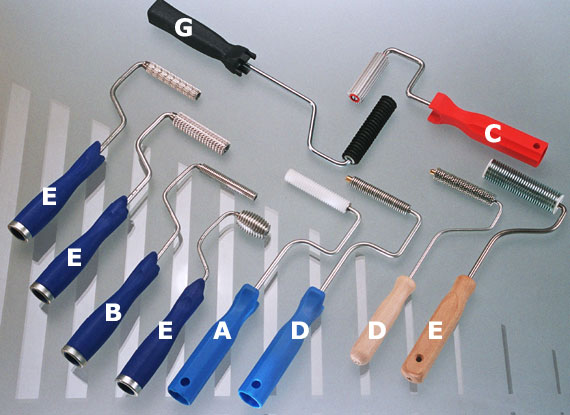

To take off bulb when laminating use rollers like these ;
watch next post !
To calculate resin quantity ; evaluate surface then choice strand matt thikness
( 100gr, 200gr, 450gr,600grammes) and multipy by 2 to have total resin use
Sample ; 1.5 meter square mold of 450 gr strand by two plies gives ;
1,5x ( 450x2) x2 =2700 grammes of resin more or less 2,5 litres
Hope this heps
Some sample of rollers to take off bulbs when laminating strand matt ;
