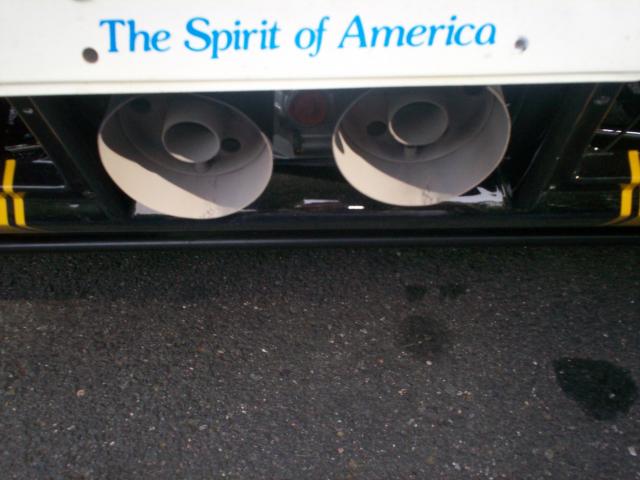

Think the mixture is correct
.030 over 289
11-1 c/r
C30Z solid lifter
44IDF's
F11 E tubes
145 Mains
170 Air Corrector
55 idles

I like that look, I remember the old days when gas had lead.
