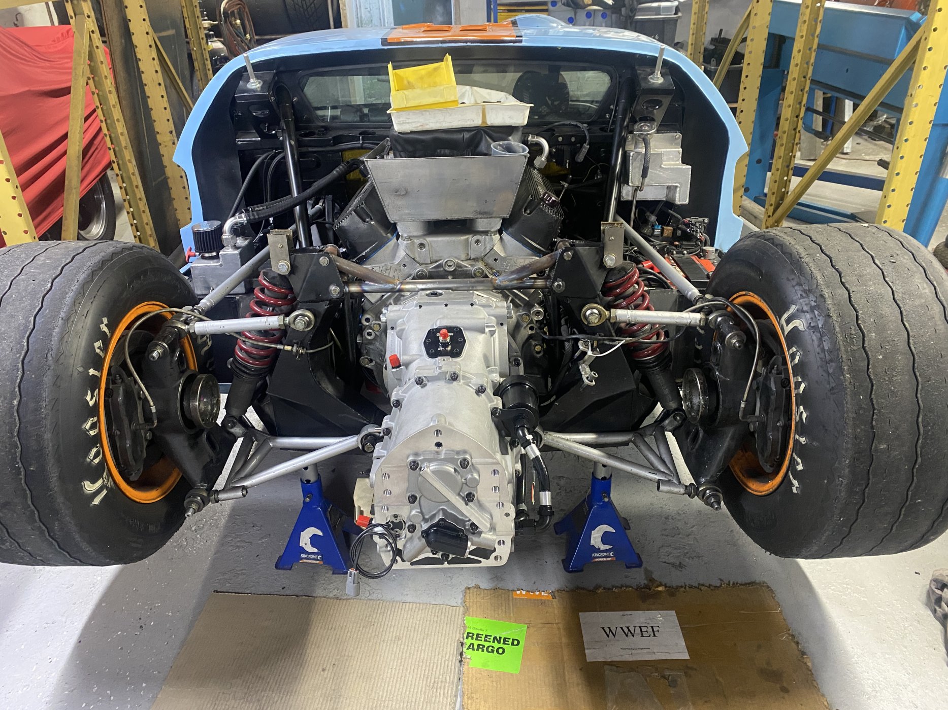

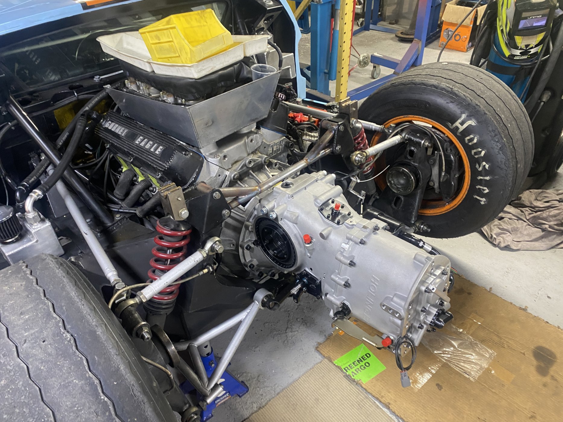

MFT Holinger for GT40

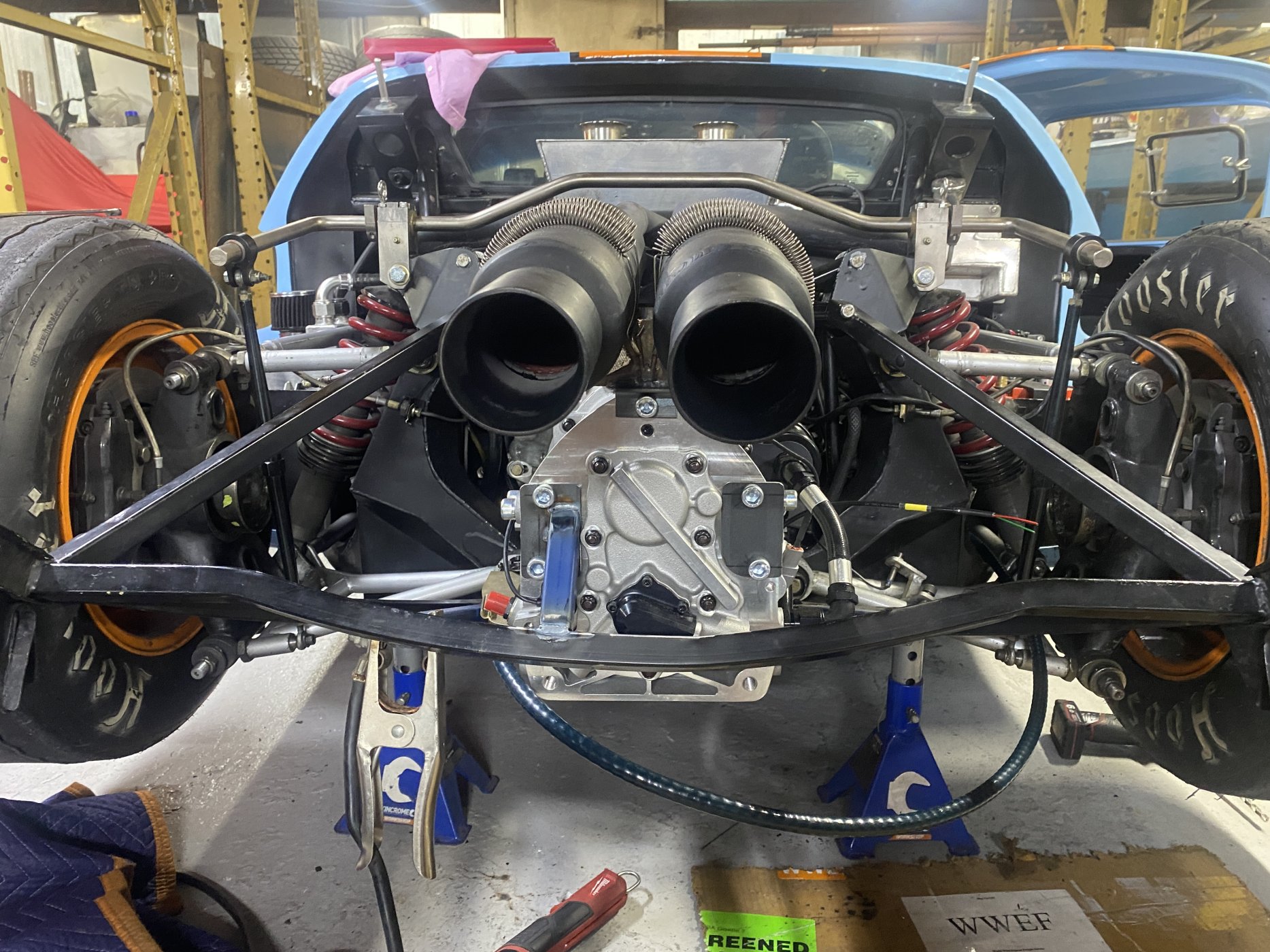

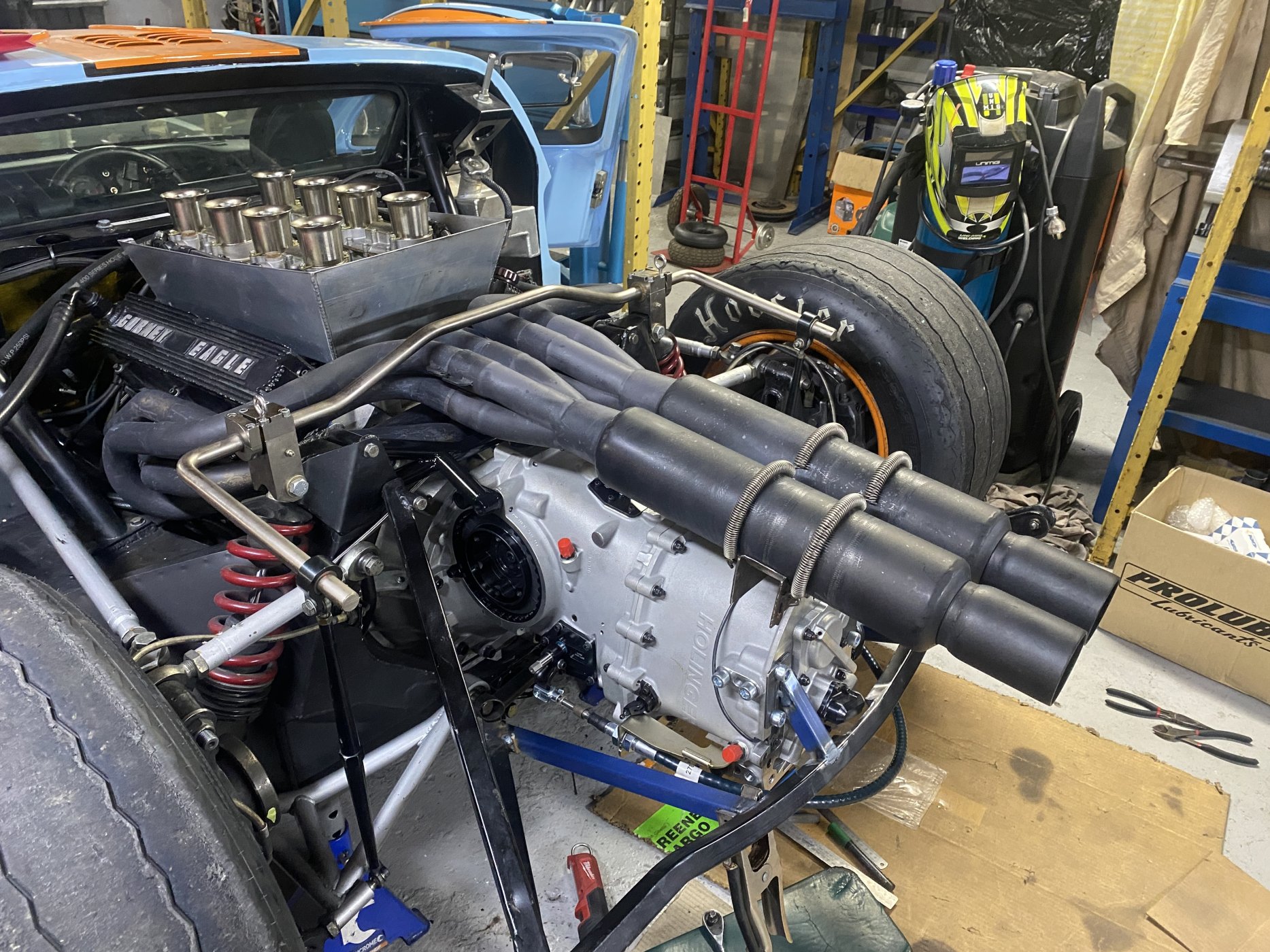

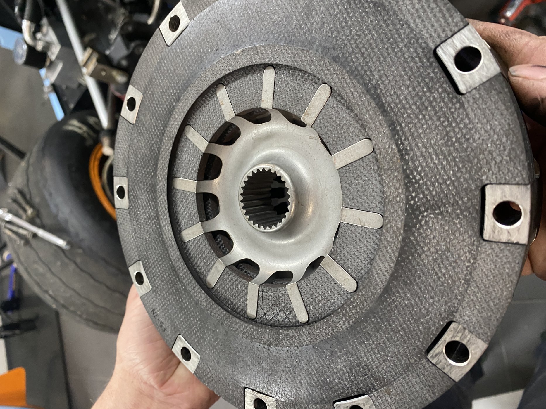

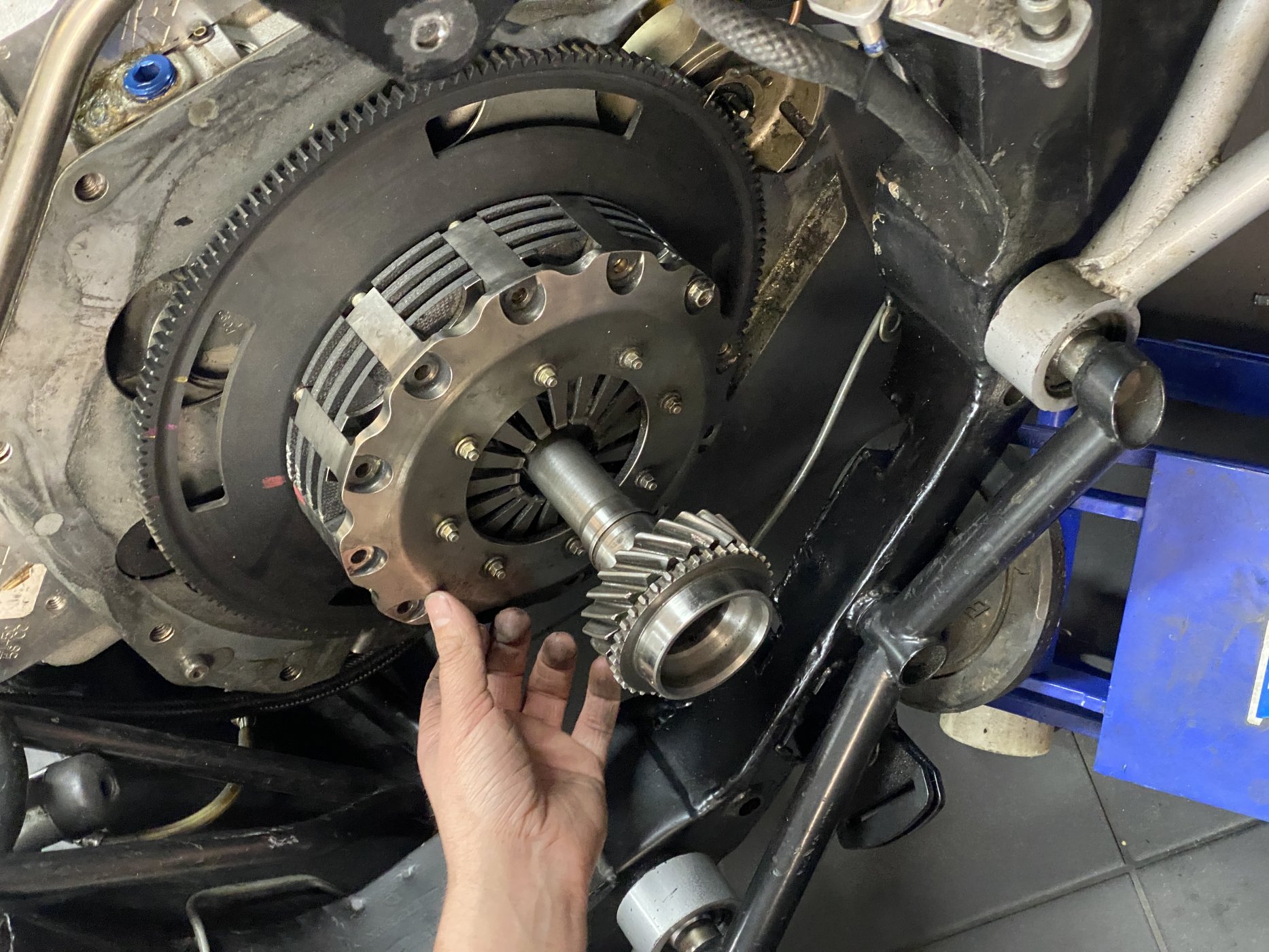

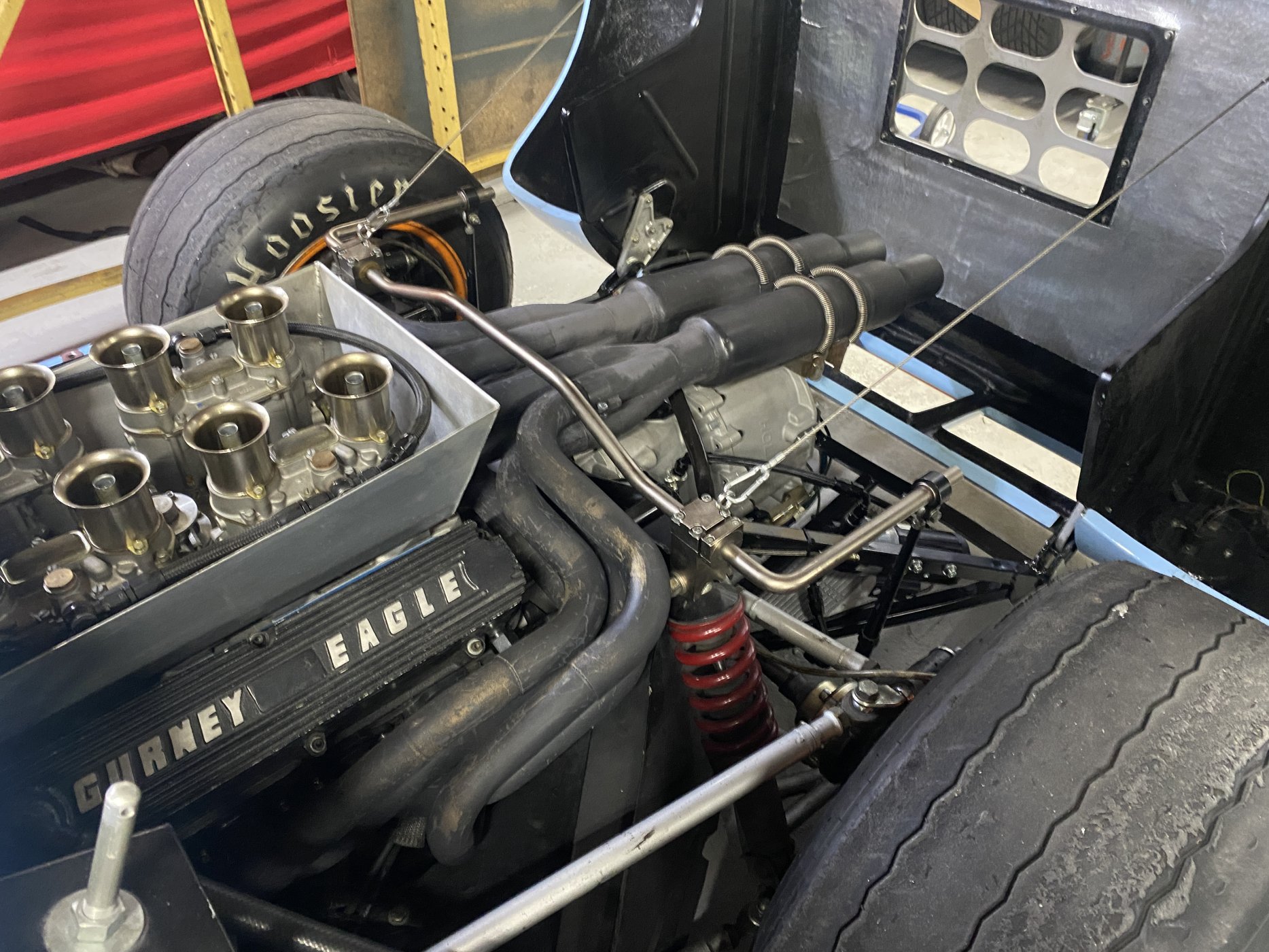

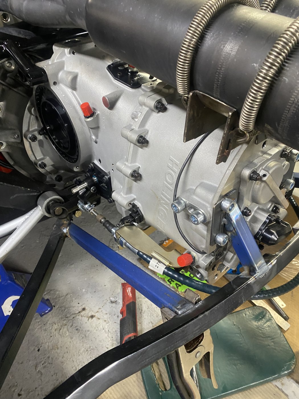

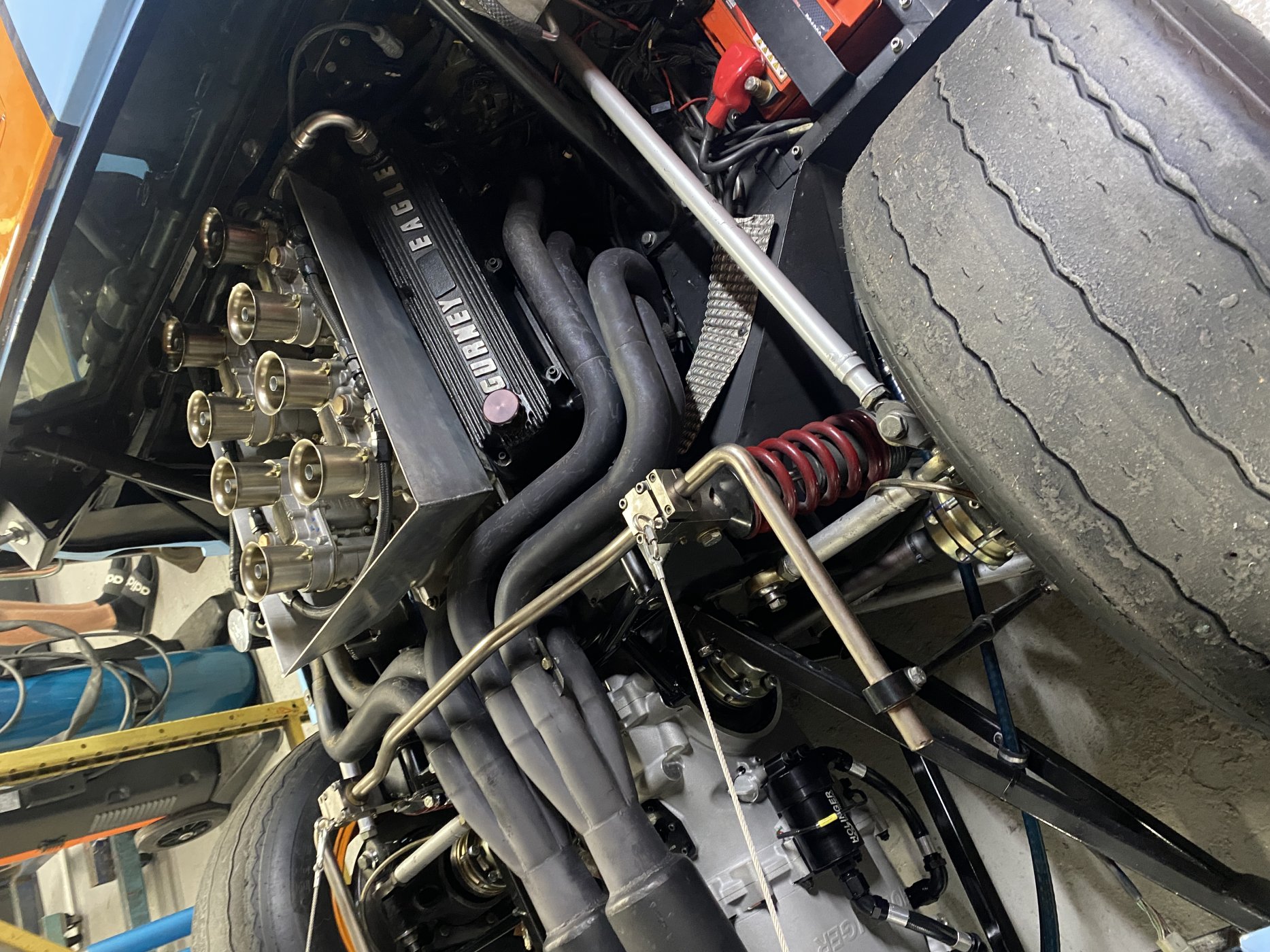

New hub from Tilton Carbon clutch to fit MFT as the ZFQ didn’t fit.

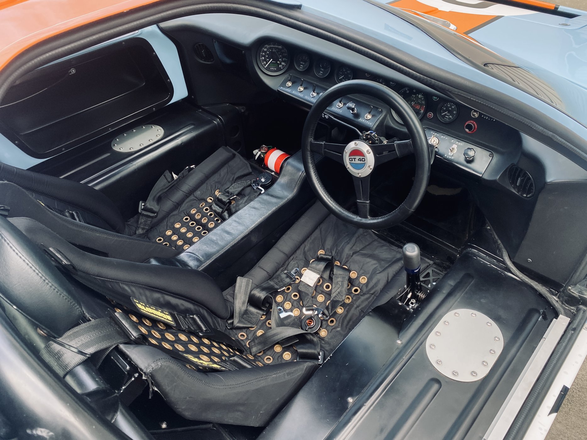

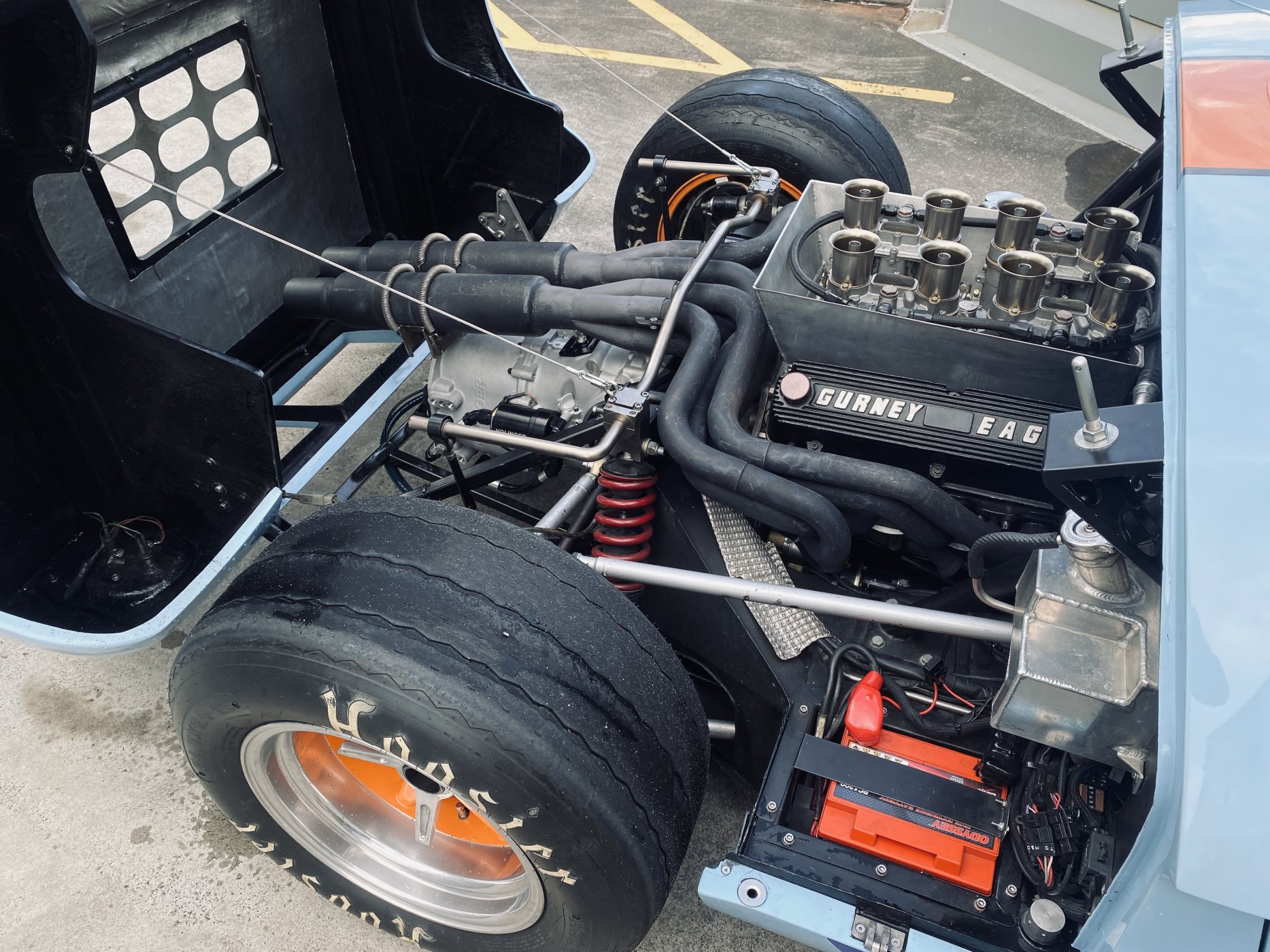

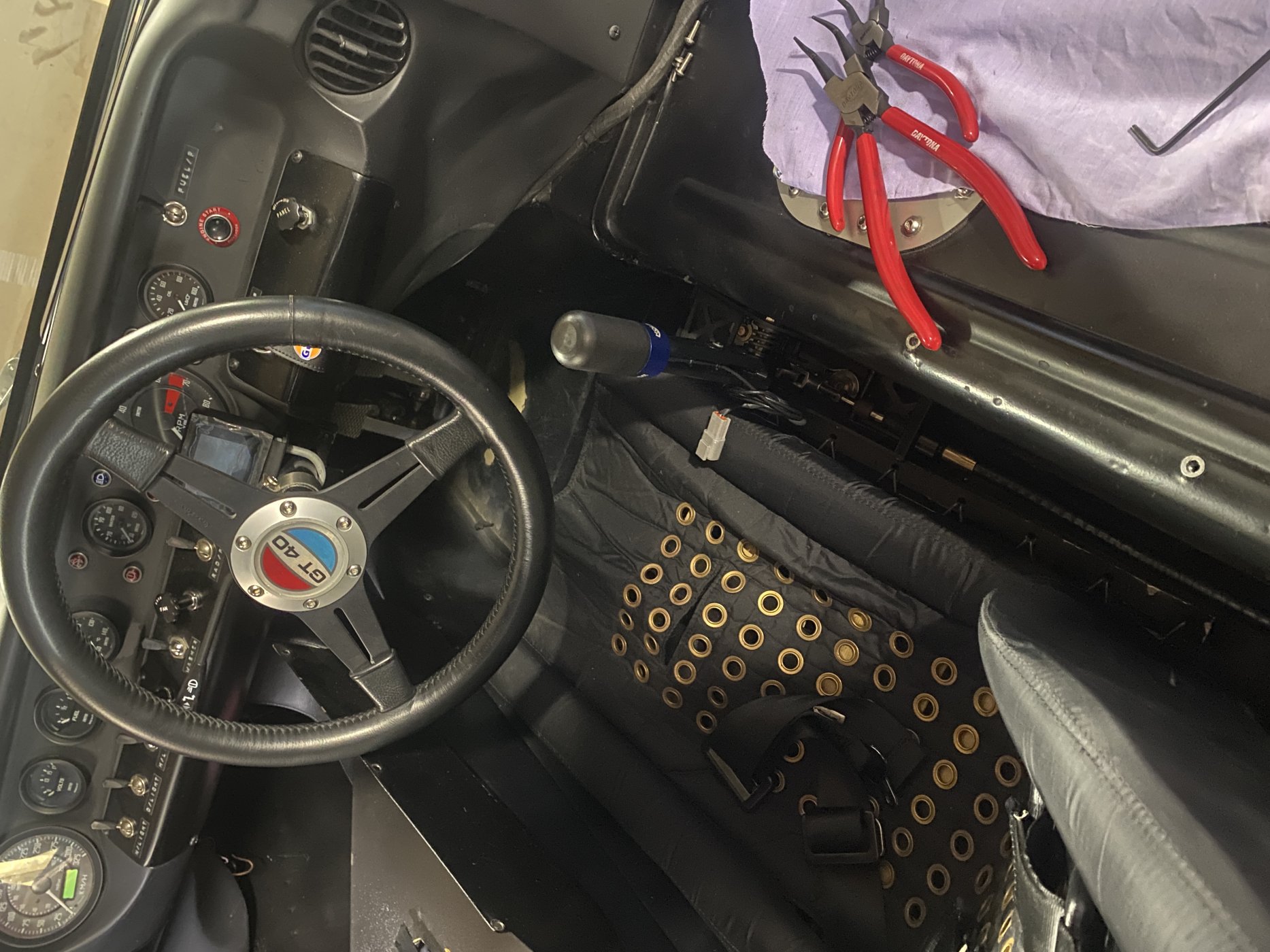

First event with my MFT Holinger trans in the car at the HSRCA Eastern Creek. The time, cost and help to make my GT40 a lot more fun to drive. Still old school, heel and toe using a clutch is the way to go in my view.

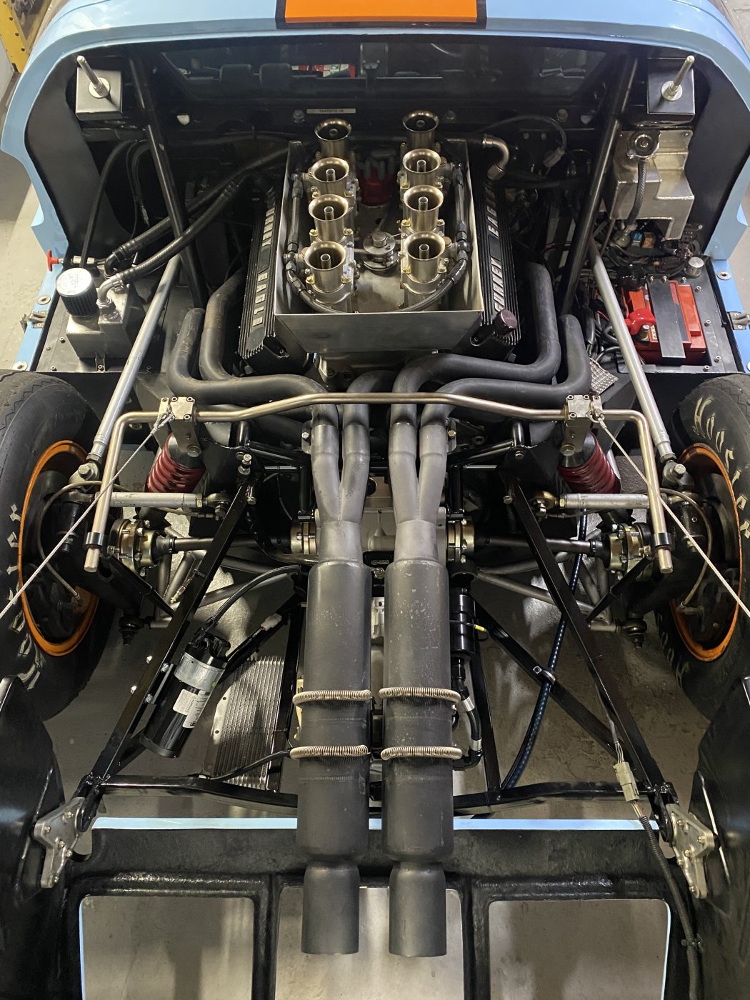

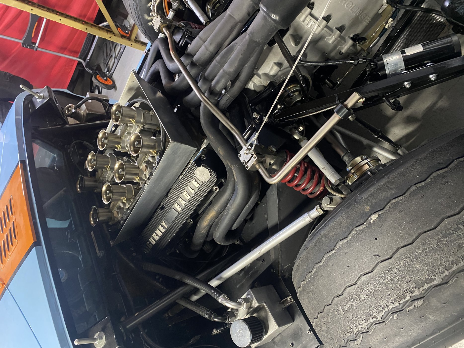

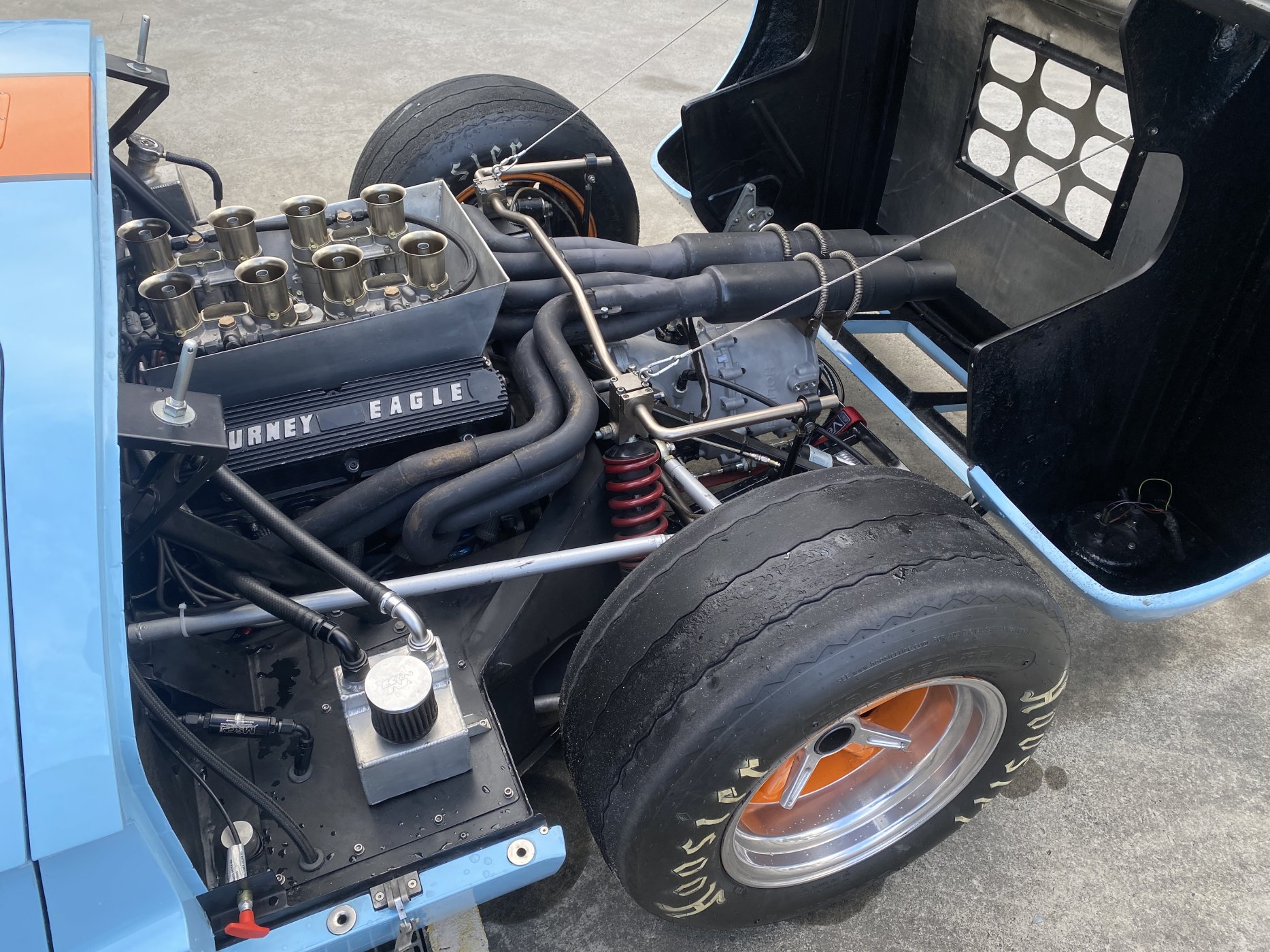

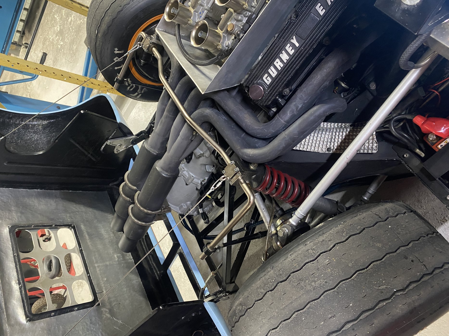

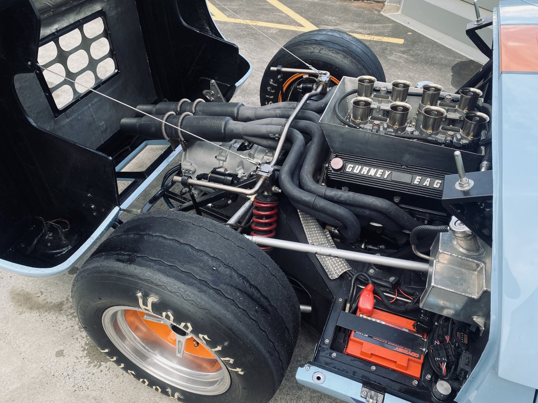

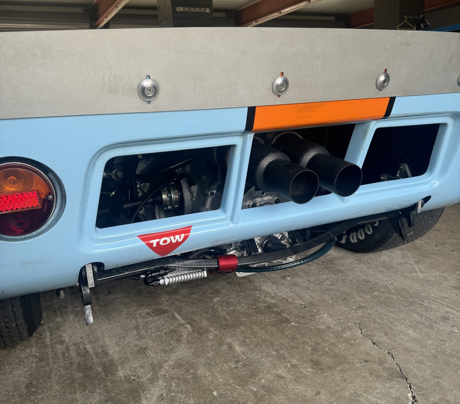

Warren, love what I see on your oil catch can setup. Anything you would do differently? How is it working for you and does it have a line going directly back to the pan or what do you do for draining/servicing it?
Devin
Devin
Hi Devin,
I don’t have much oil in the catch can, I had it made then stuff a couple of stainless scourers in it for baffles. I just disconnect and unbolt it and tip out the oil. Cheers, Warren.
