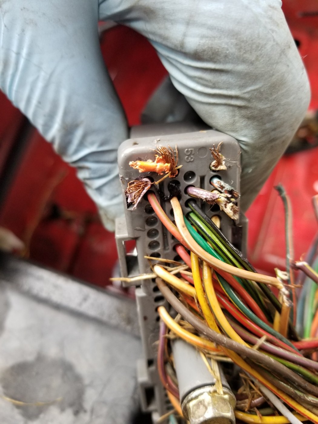

Toyota is not the only one. My 97 Ford F150 has it as well and the rats & mice ate gobs of the wiring right up to the connectors! I'll post photos when I get to my iPad..

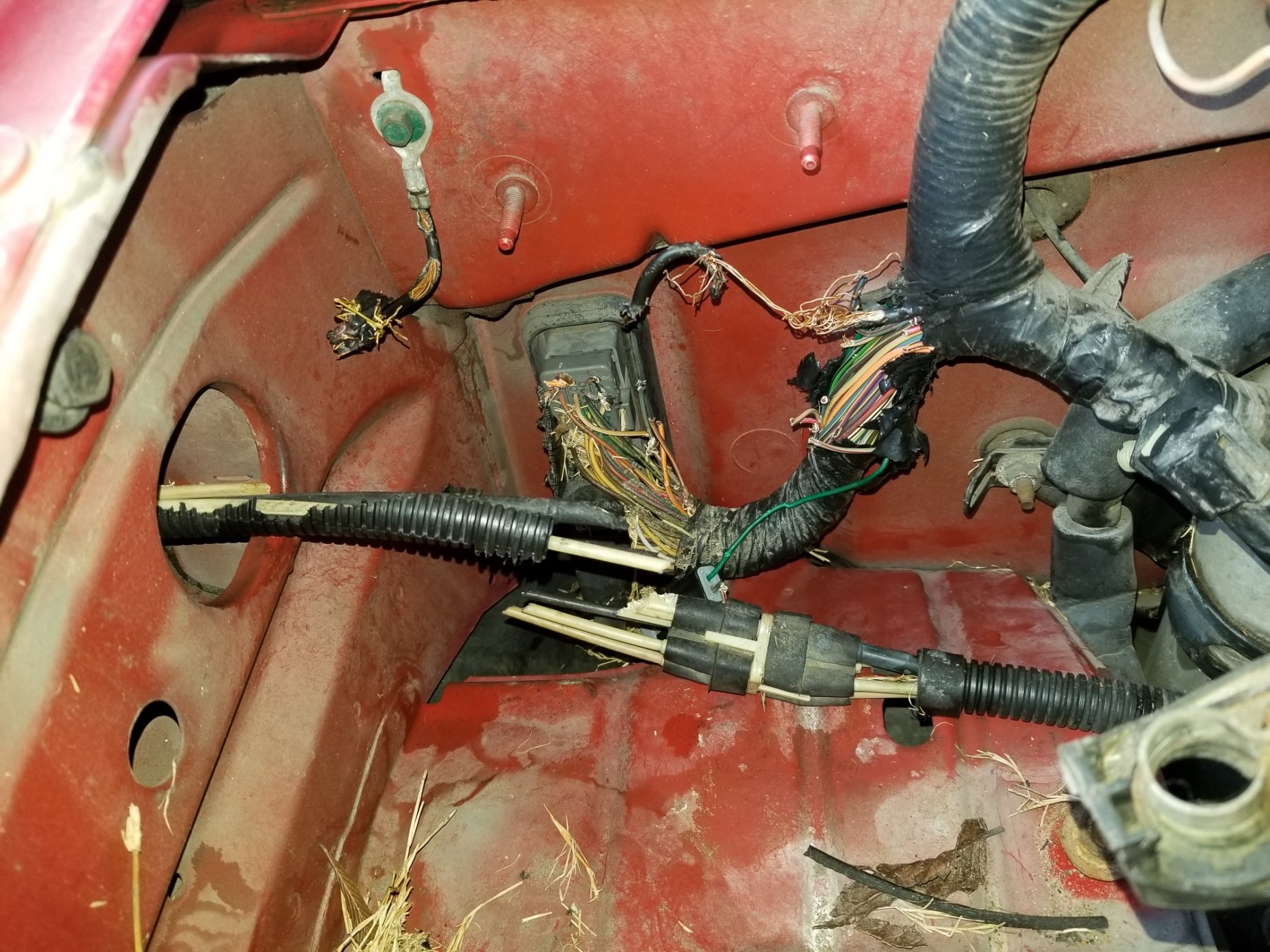

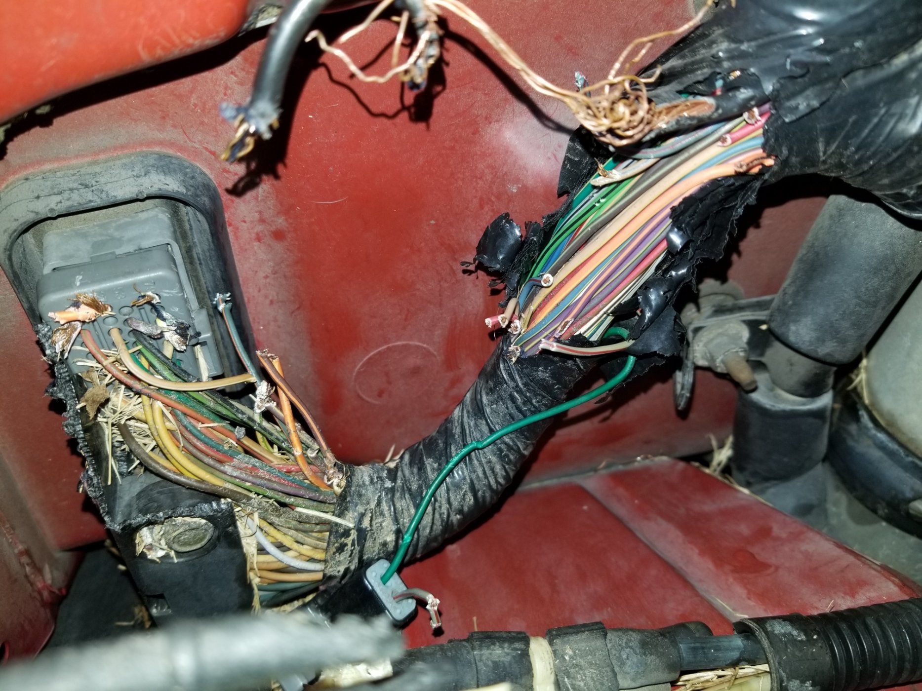

I was able to affect repairs to the wiring and saved the truck…
Notice the vacuum lines were also eaten…

That was a very determined critter. Congrats on saving your truck.
I'm torn between buying back my truck and getting a new one. With sufficient time and parts, I can attempt to fix it, but I'm worried that the mice will eat the wiring a third time.
It’s a long story, but basically I was given the truck by my next door neighbor since it had not been used in a couple years and when it did, it didn’t run well and the transmission sometimes would not shift. It had been in his family since new in 96 (its a 97) and was his daily driver in college. Now with a wife and 2 kids - it just sat. I had nothing to lose. A new front wiring harness could be purchased for almost $900, but I wanted to see how bad it ran, shifted, etc. As it turned out, the shifting problems were caused by being almost 4 quarts low on ATF and with 150k miles on the spark plugs, their gaps were now pretty uniform at .110”. I changed ATF and Filter. No leaks, so it’s sort of a mystery as to where the fluid went. It now runs smooth, shifts nicely. I still have to charge the AC and do some other repairs.. Meanwhile, my repaired wiring harness seems to be working well! I’ll try to find some photos of my repair process.
Splicing wiring is not fun, but it’s not rocket science either. I only had to refer to a wiring and vacuum line diagram a couple times.
