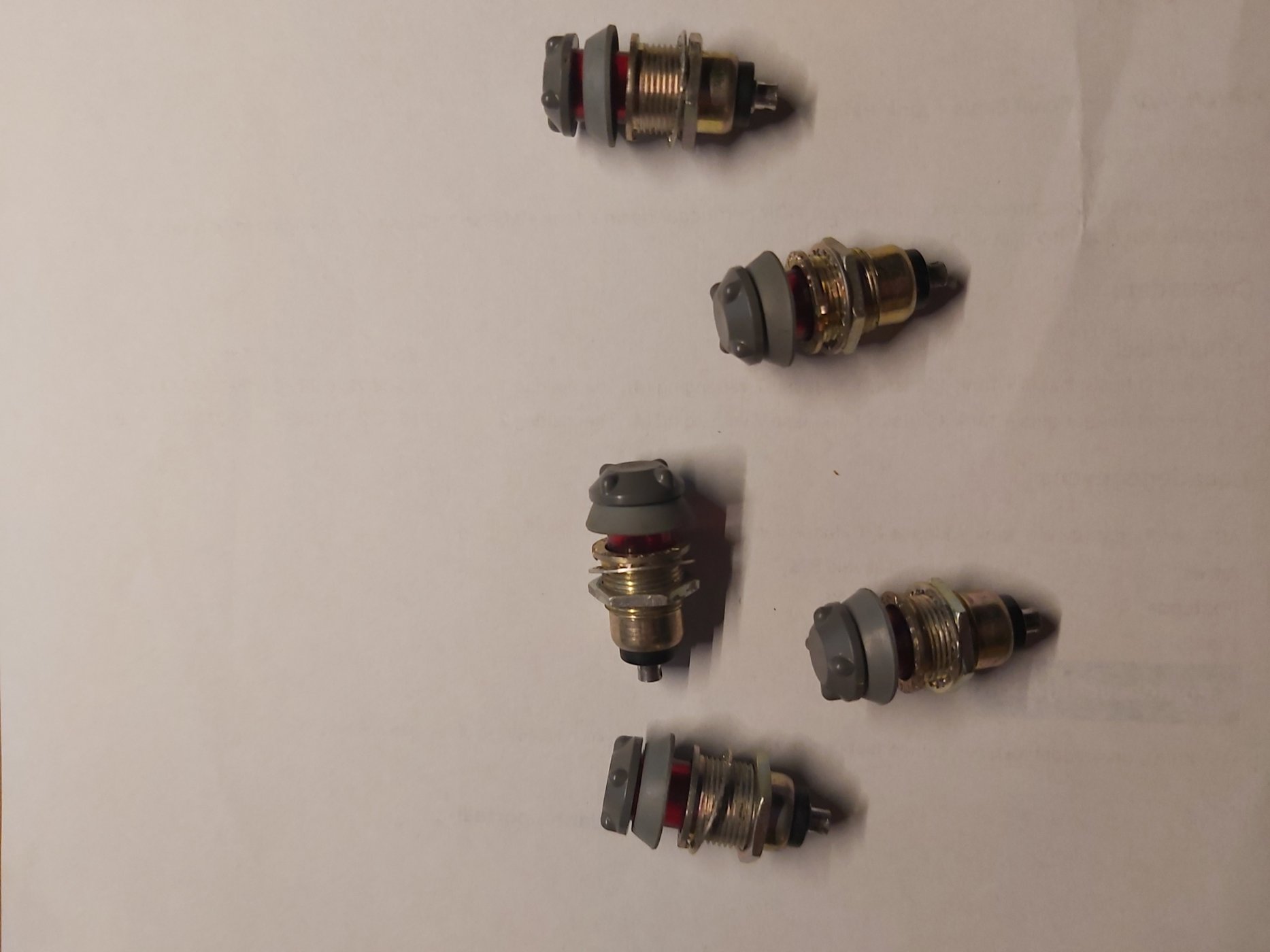

MS25010A what bulb
Neil
I think the 28V bulb is a #327. A 14V bulb is #330 or #382. These are panel illuminators, designed to edge-light a plastic panel.
I know what it is. A panel iluminator designed to edge light a GT40 switch panel..
But as Ford also used the Boeing 28Volt wiper motor in the mk2 I am wondering if they did the same with these Boeing panel lights.
If I hook them up with 28Volt bulbs they just glow.
