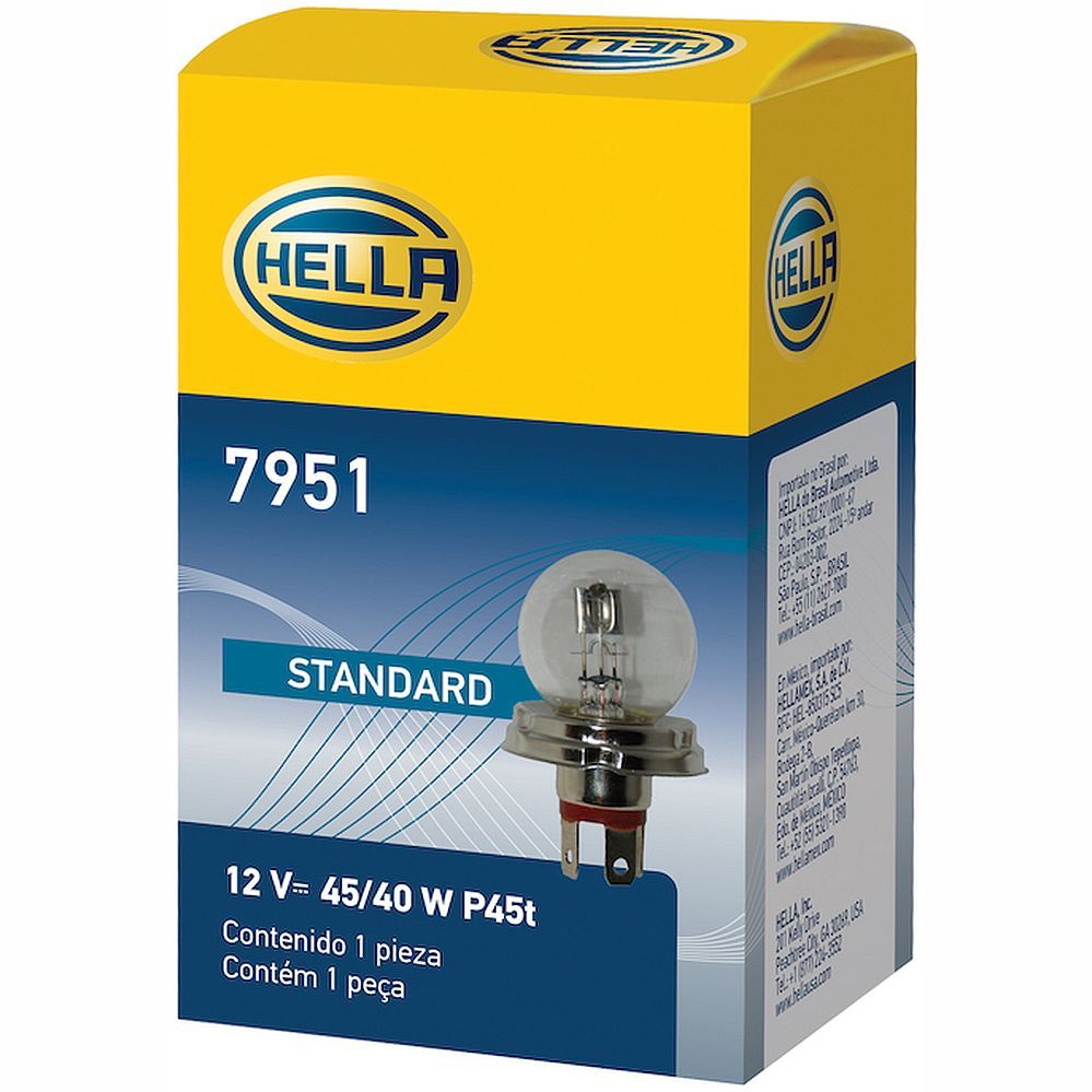

I have an RCR40. Not sure where the headlights come from (I think Lucus) but they came with Hella 7951 bulbs. My understanding is the way the 7951 high low beams work is a combination of the filament height and enclosure geometry. H4 LED bulbs don’t have different heights for high and low beam and the height doesn’t match either position in the 7951 bulb.

HID would be good. Not as power hungry as Halogen, yet brighter. Unfortunately, not able to find HID bulbs with the P45t-38 base (also referred to as R2 or S13). If using an H2 conversion it seems likely they won’t work well with enclosure geometry.
I wonder of these LED lights will work. They look like they replicate the form factor of the Hella 7951s. No idea if they are any good.
