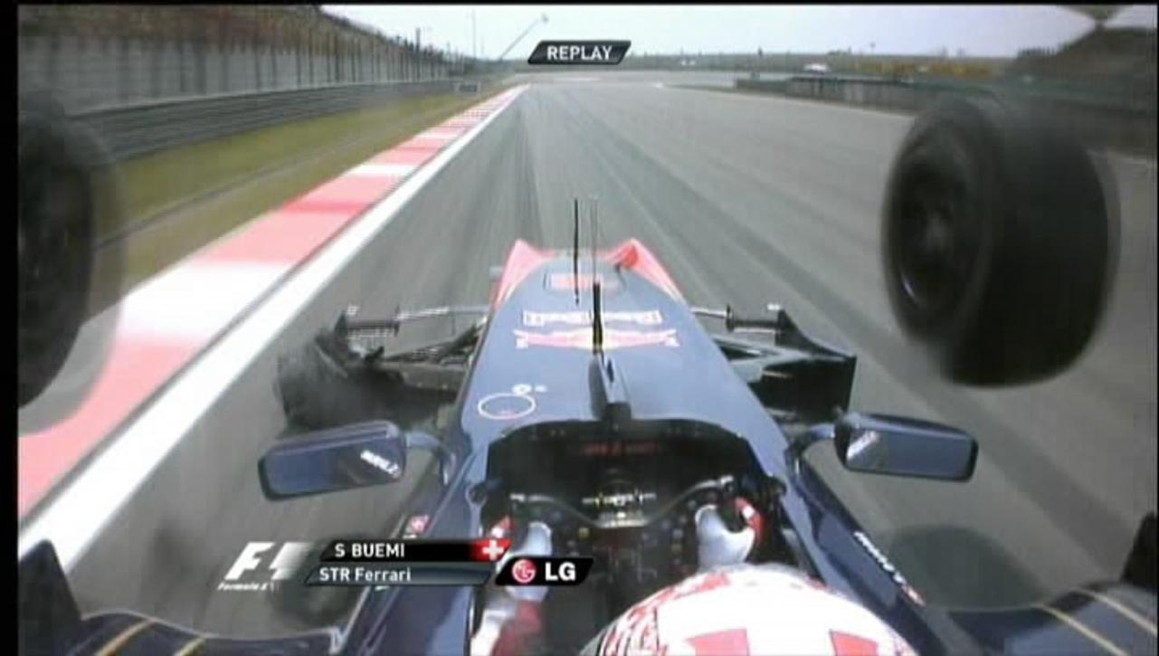

It's not the loads that cause issues with composite wheels and (uprights for that matter), rather elevated temperatures. Radial heat from the brake rotors. There is a reason F1 still run Magnesium rims and Titanium uprights. Just ask Sebastian Buemi...
And how do the uprights fit in with a carbon wheel. Better yet how does the image you linked fit in. A new proto type upright failed...
Quote "A team spokesman said: "Buemi's incident in FP1 was caused by the failure of the front-right upright. Both cars had been fitted with new uprights for this race. They had not been used previously.
"The exact cause of the failure within the component has yet to be identified."

Actually, Kyle is correct. They later confirmed (officially) that the uprights were not carbon prototypes.

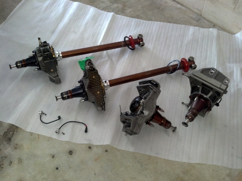

The only carbon featured on my 2006 Renault R26 uprights are for heat shielding (rears) and brake cooling aero efficiency (fronts)
