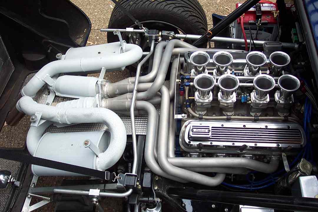

Peter Delaney
Steve, I also had to do the "emissions thing" for rego, but here in Oz (NSW) the RTA had a test setup on a dyno that involved following a pre-set drive cycle for about 3 mins. A giant sniffer at the back cought all the xhaust gases (& in my first run, all the unburnt HC that was leaking out faulty filler cap necks). Unfortunately, the RTA's standards are expressed in gm/km as measured over the test, & this does not translate into the % figures that you are looking at.
However, in relation to your questions on CATS & the exhaust system, perhaps the attached pic of my functional (ugly) initial setup will help.
I was advised early on that there was no way a carb engine would pass, CATS or no CATS, so EFI was the only choice - & CATs would be mandatory. The pic shows the CAT & muffler setup that got us through (just) - the O2 sensors are located in the collectors, just in front of the flanges, & point down/out at 45deg.
With the big loop-back exhaust system, we were able to get reliable & realistic readings from the wide-band O2 sensors - she stayed in closed loop all the time.
(It even passed the noise tests - but not without the help of half a dozen s/s pot-scrubbers up each tail-pipe) !
Conventional wisdom here in Oz said that we would never get an 8-stack to pass, but my engineer had other ideas ! He matched specs for the AFR heads, cam & injectors to get what he wanted, then told me that the injectors had to be mounted inboard (like the TWM setup) so that they pointed straight into the ports. It was a challenge, but it all worked in the end - after 5 attempts on the RTA test cell, we finally just scraped through.
BTW, the induction trumpets also had big oil-soaked filter socks on to cut out any HC from spit-backs going into the sniffer.
I started out with a real mind-set against EFI, but I was forced to go that route - I am now so glad I did ! The ease of tuning, the brilliant diagnostics, the reliability - all good stuff !
Sorry I couldn't help with the emissions levels, but maybe the exhaust setup will be useful.
Kind Regards,
Peter D.

Peter Delaney
Steve, sorry about that !
Peter Delaney
The reason that the CATs are pointing outwards is that the centres of the collectors on the DRB crossover setup were only 90mm apart. I couldn't find CATs big enough to do the emissions job & skinny enough to sit side by side on 90mm centres.
The CATs have been a big PITA - I lost ignition on 2 cyls the other week (crook connector on a coil igniter) & limped a few kms home backfiring, etc. When I opened the rear clip, the LHS CAT was bright red-hot & the muffler was almost the same ! The huge unburnt fuel load going into the CAT really got that catalytic process going !
The net result was that the rear half of the element in the CAT melted & got spat out as little (expensive) lumps, & a whole bunch of the f/glass packing in the muffler also melted into little lumps of glass which rattled around inside !
I have since "cleaned out" both the CATs (I found that a foot-long 1/2" masonry drill was most effective for this "cleaning" exercise !) & had the muffler emptied out & repacked.
All in all, CATs are a pain - even when everything is working correctly, I am willing to bet that they raise the engine bay temp quite significantly. Quite a while ago, Adam posted a huge technical treatise on how expansion chambers could effectively emulate the effect of equal length tuned headers - perhaps the new "clean" CATs will serve this purpose (apart from looking legal) !
Kind Regards,
Peter D.
D
DavidTC
Guest
Peter
Do I take it from this that your catalytic converters were ceramic monolith design ?. Performance cars, (and performance motorcycles) for that matter, always use wire wound systems which are more expensive but stand all of the bumping around.
Just thought I would ask.
Regards
David
Peter Delaney
David, I assume that mine (were) the monolith type - a cylindrical block of ceramic stuff with millions of tiny holes running from front to back - like honeycomb, but with square holes. My "cleaned" CATs should now stand any amount of bumping around !
Kind Regards,
Peter D.
