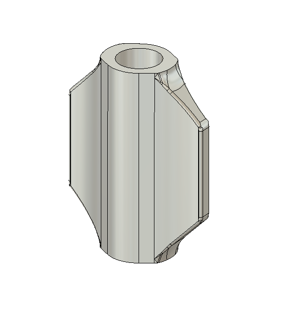

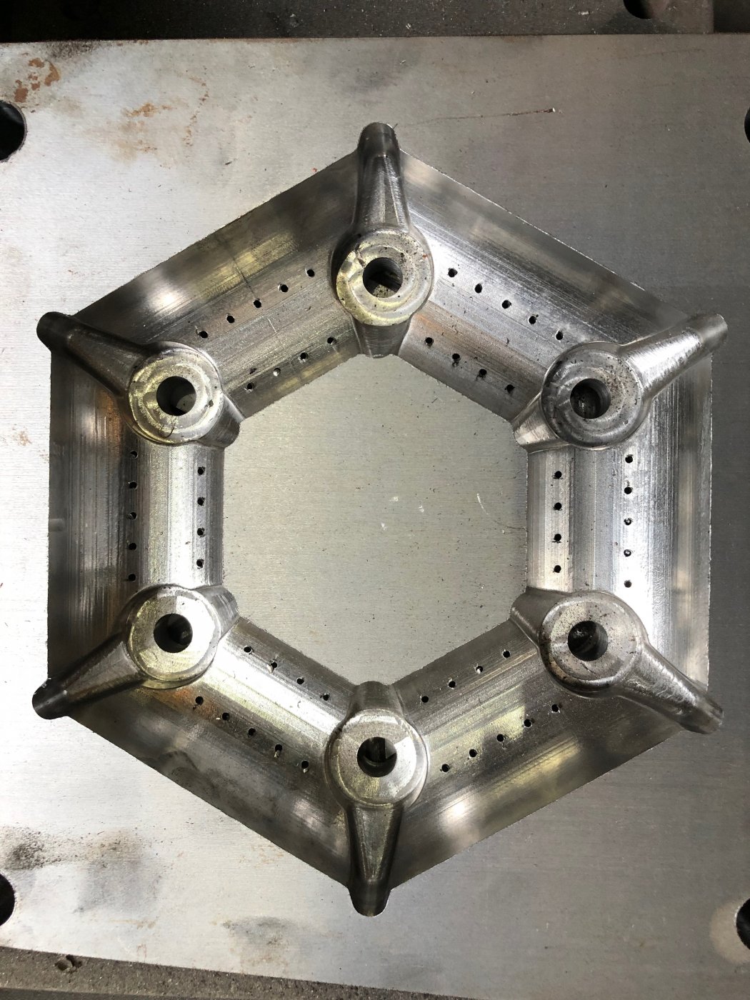

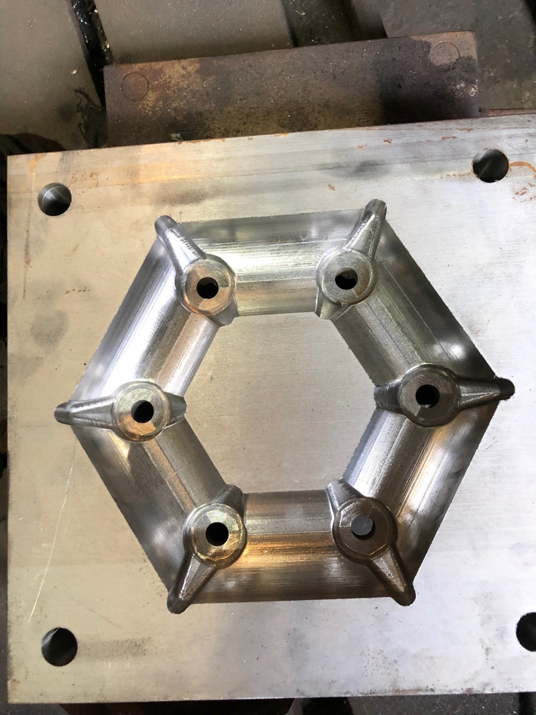

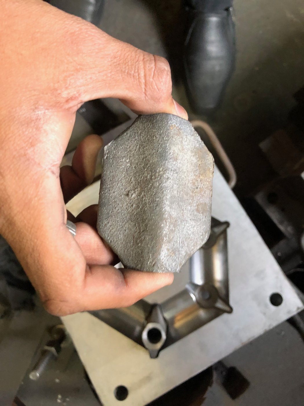

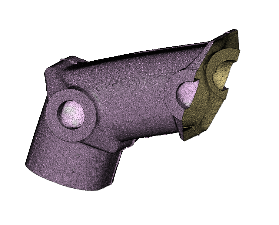

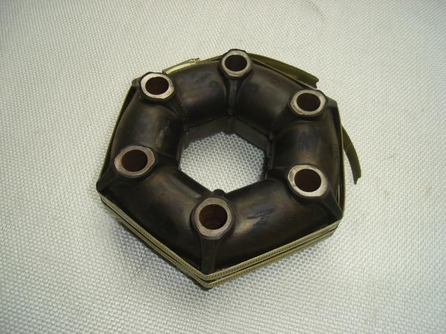

Following a conversation about the prices of reproductions of original GT40 parts, I decided to attempt to make the donuts.
I found a couple of experts in their field and between us set about the task.
The first batch turned out very well
The results in the photos below;
!st, and 2nd photo, scans, 3rd , steel insert casting, 4th and 5th, Ali Moulds, Last photo, finished Item.
Donut1.png .Steel insert.png IMG_3787.jpg mould 1.jpg mould 2.jpg coulping photo.jpg
View attachment 112326 .View attachment 112324 View attachment 112321 View attachment 112322 View attachment 112323 View attachment 112325

A donut has been tested to failure. A bolt through two adjacent holes were hydraulically stretched apart , the rubber stood up extremely well and broke. The important point is that the rubber did not detach from the steel. This test checked the adhesion and strength of the rubber, however the donut would not undergo these extremes in racing use.
To help pay for the investment in this project I am offering a few donuts for sale, £ 600 for a pair, inc postage within the UK. Will post abroad by arrangement.
