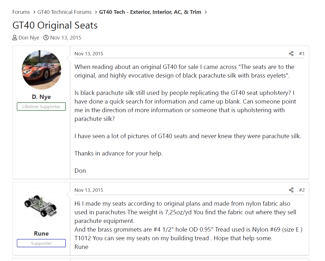

D David mono Apr 1, 2025 #3 The thread has more information. Attachments Screenshot (190).png 173 KB · Views: 67
