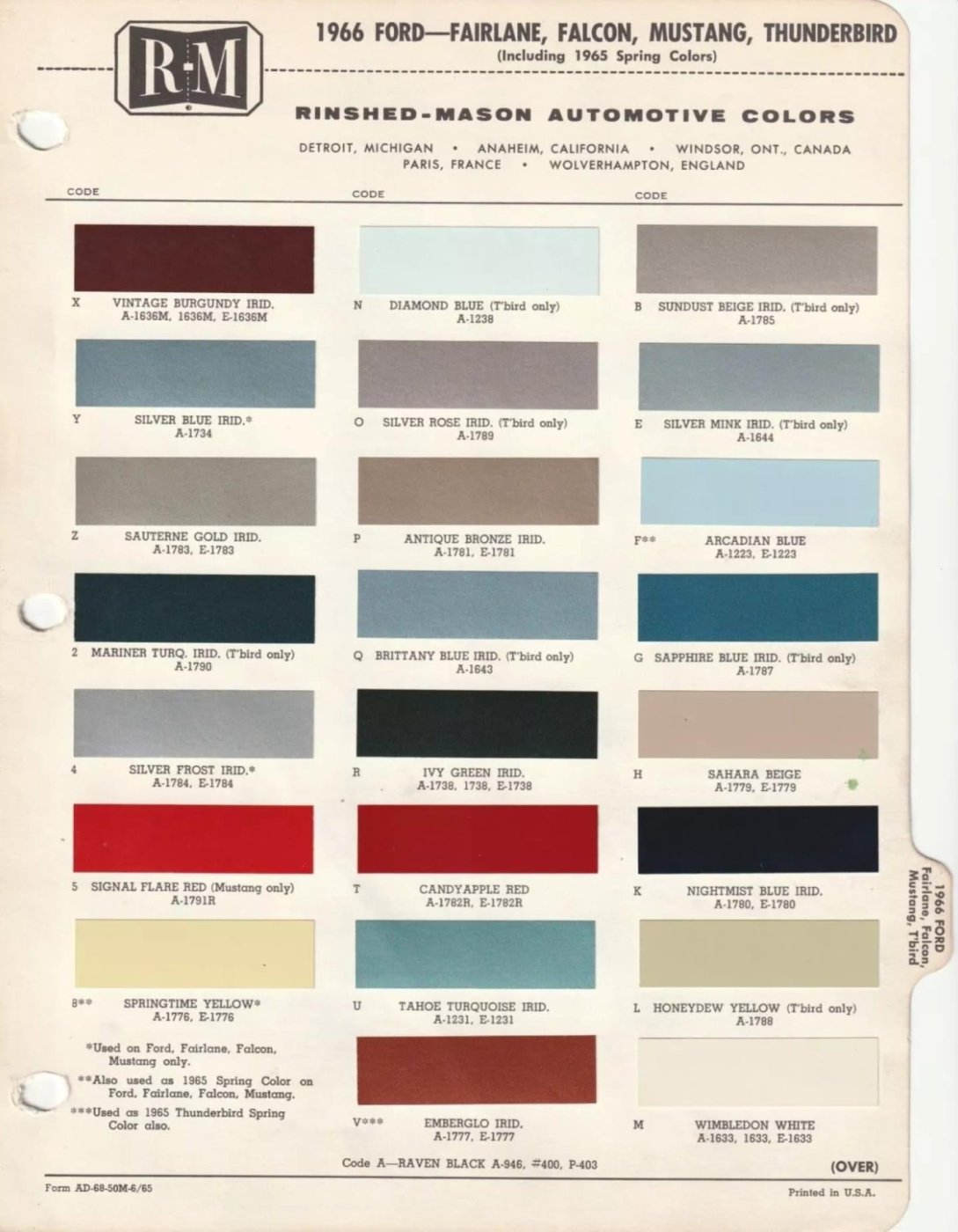

These are the Ford factory colors as of Spring 1965
Ben,
The 40s were painted in single-stage paint. My understanding is that both enamel and lacquer were used depending on the color and the end use of the car and possibly what subcontractor painted the car. The color palate was open to most any paint color used on UK cars thus cars were painted in colors other than "Ford colors". This is why the Gulf cars were painted in Standard-Triumph colors and several cars got Rover colors. The paint was "gloss" however the finish was not as bright as the clear coat used today.
Thanks, @Randy.
I know the colors, and the decision is already made.
What I'd really like to know is how the paint was applied and what type of material they used 60 years ago.
