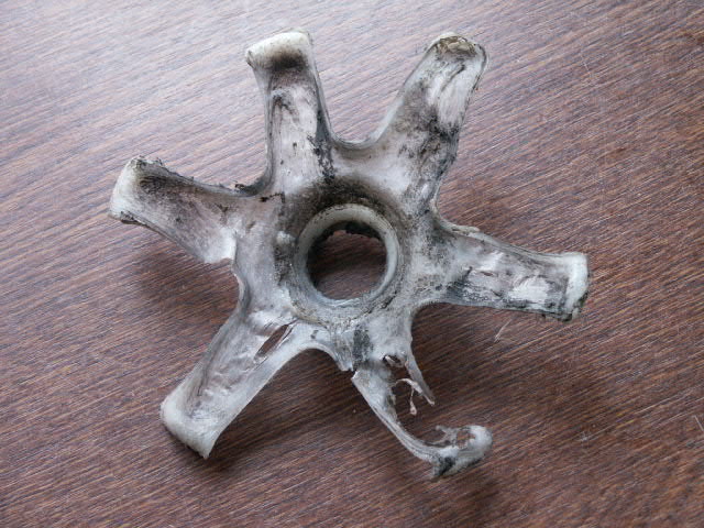

Anyone fancy hazarding a guess at what this is ? It was retrieved from my GTD shortly after I put it on the road a few years back.As a clue, I originally bought the car as "nearly complete and built by an FI technician". It gave me a new meaning to term FI (second word being idiot).In fact the build quality was so poor that I finished up stripping it down to the last rivet and started all over again.The picture aptly illustrates the mentality of the F1 builder(my version).Any guesses ? No prizes !

Here are my guesses:
- remains of an office chair base ?
- centre of a wheel ?
- plastic cooling fan that got too hot ?
Appears to be made of plastic, but not black, it has a keyway, it looks about ? inches in diameter judging from the grain in the desktop, hmmmmm ?
Hey Rich,
The old paddle clutch just didn't cut it, Huh! /ubbthreads/images/graemlins/grin.gif
I think it might be the cooling fins from an alternator.
Steering column bush that's FAILED! /ubbthreads/images/graemlins/blush.gif
/ubbthreads/images/graemlins/grin.gif /ubbthreads/images/graemlins/grin.gif /ubbthreads/images/graemlins/grin.gif
Looks like something off a 250,000.00 Ferrari sometime between it's first and second oil change.
