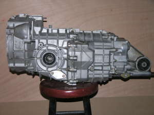

I know of a porsche 964 ('93 C2) transaxle which is rebuilt and available for a good price. The housing has "950 301 101" stamped on it. Does anybody know if this is a a) G50 b) which would work with the KEP adapter for SBF?

From what you've given, it looks like it would be a G50/03, without the LSD, and it could be from a 1990 to '94 C2 or a '95-98 911, depending on the date code.
There should be another stamping in the transmission with a letter code, and that will give you date of manufacture with K being 1989, L being 1990, etc. I don't know if the letter "O" was used or not....

Looks like a nice clean and rebuilt tranny but I think I'll hold out for a G50 with the LSD.
If anyone wants this one just pm me - the fella is asking $1,800.

This trans was on eBay not long ago. I wonder why it is for sale again....?
950 301 101 is probably part of the casting number for the center housing section. The real numbers are on the underside of this same section. They should start with G50...

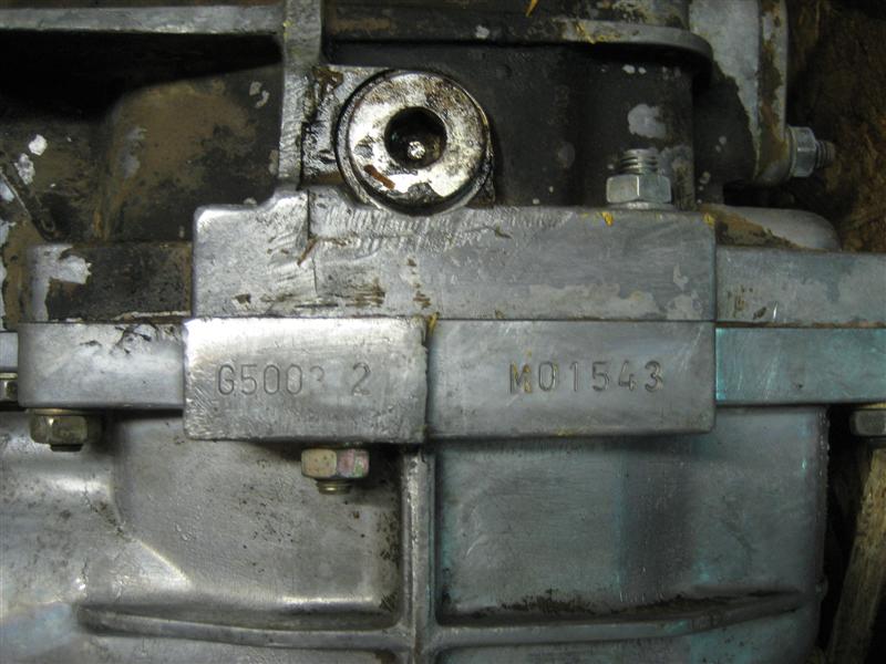

BTW, here's a pic of the code stamping from the bottom of my G50/03.
From what I had found earlier, confirmed by your decoding table, this "should" be a 1991 G50/03 with the M220 LSD, correct?

Correct. Exactly, that is what it "should" be. Select a gear & turn one output flange. If the other one spins in the same direction, it is a) still an LSD, b) still working. If they turn opposite directions, then it is either a) not an LSD, or b) not an LSD at the moment, and would need to be rebuilt with a fresh clutch pack. They do wear fairly quickly with track use or high power.
