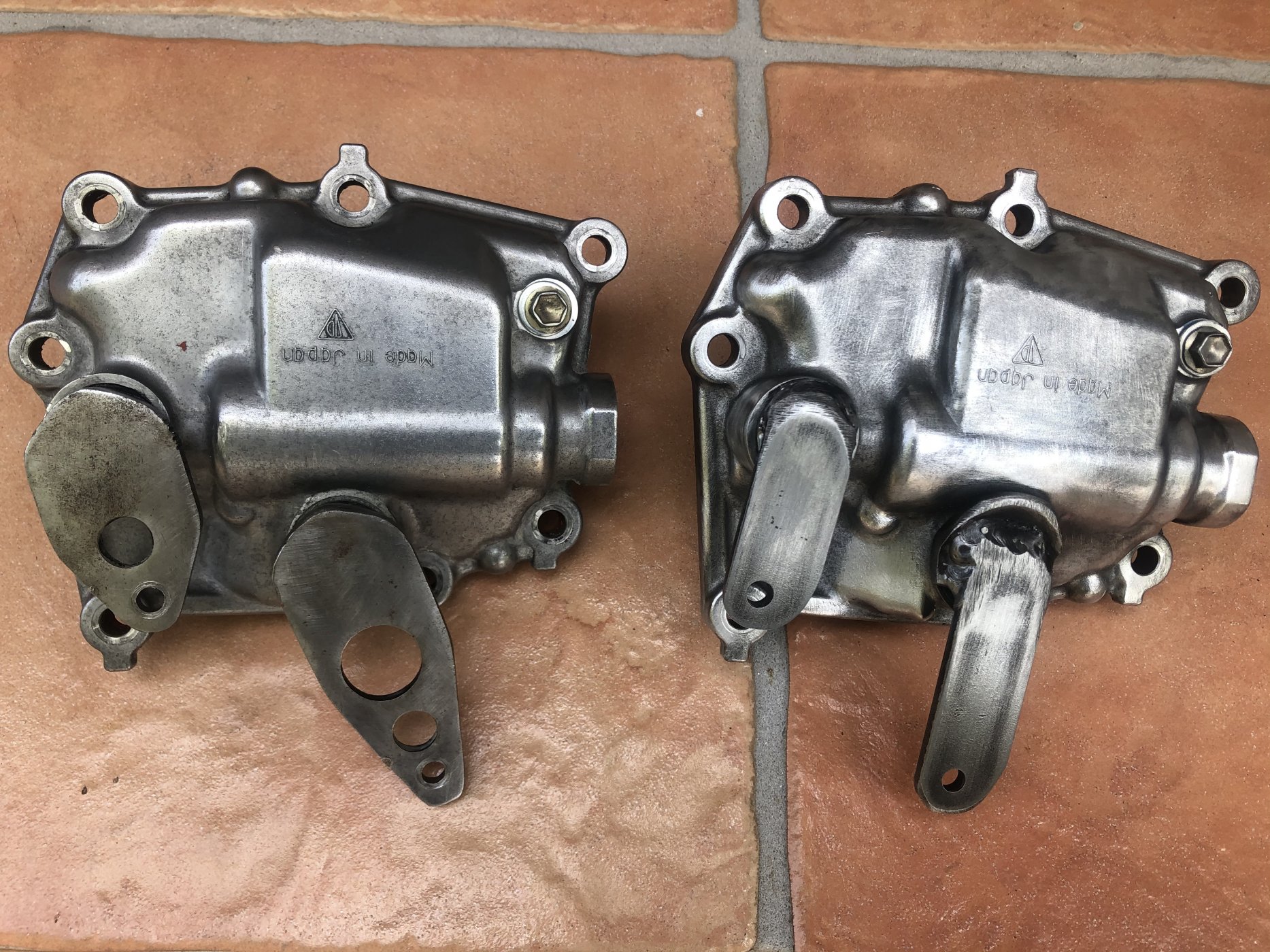

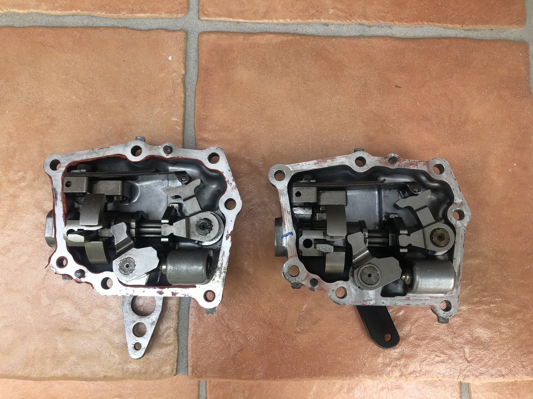

Chris from Active Power modified and sent me a new transaxle shift lever. His modification lessened the reverse spring tension and that solved the issue I was having. The modified lever on the right (picture) worked and I now get reverse.
