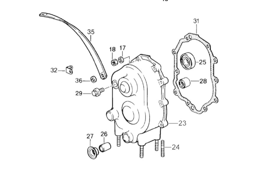

Is this an easy swap or a potential nightmare?

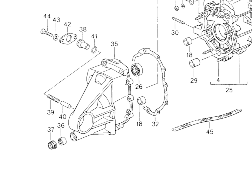

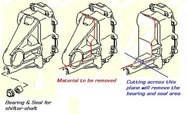

According to the Porsche online parts catalog both the long and short versions share the same part numbers for the gasket, shaft oil seal and bushing. That would "seem" to indicate they can just be easily swapped (and then the shifter shaft shortened to match).
But, in the parts diagram, the long cover has a parts assembly that the short cover does not have (see parts 39 through 44 in the diagram below). Does anyone know what function these parts have, and perhaps more importantly, does the lack of those parts in the short cover preclude swapping them?

Number 40 and 39 are shift rod detent and spring. Also might worry about end play clearance and the adjustments. There would be thin shims behind bearing races. It would be worth a trans guy swapping it out . JMO. Good luck.

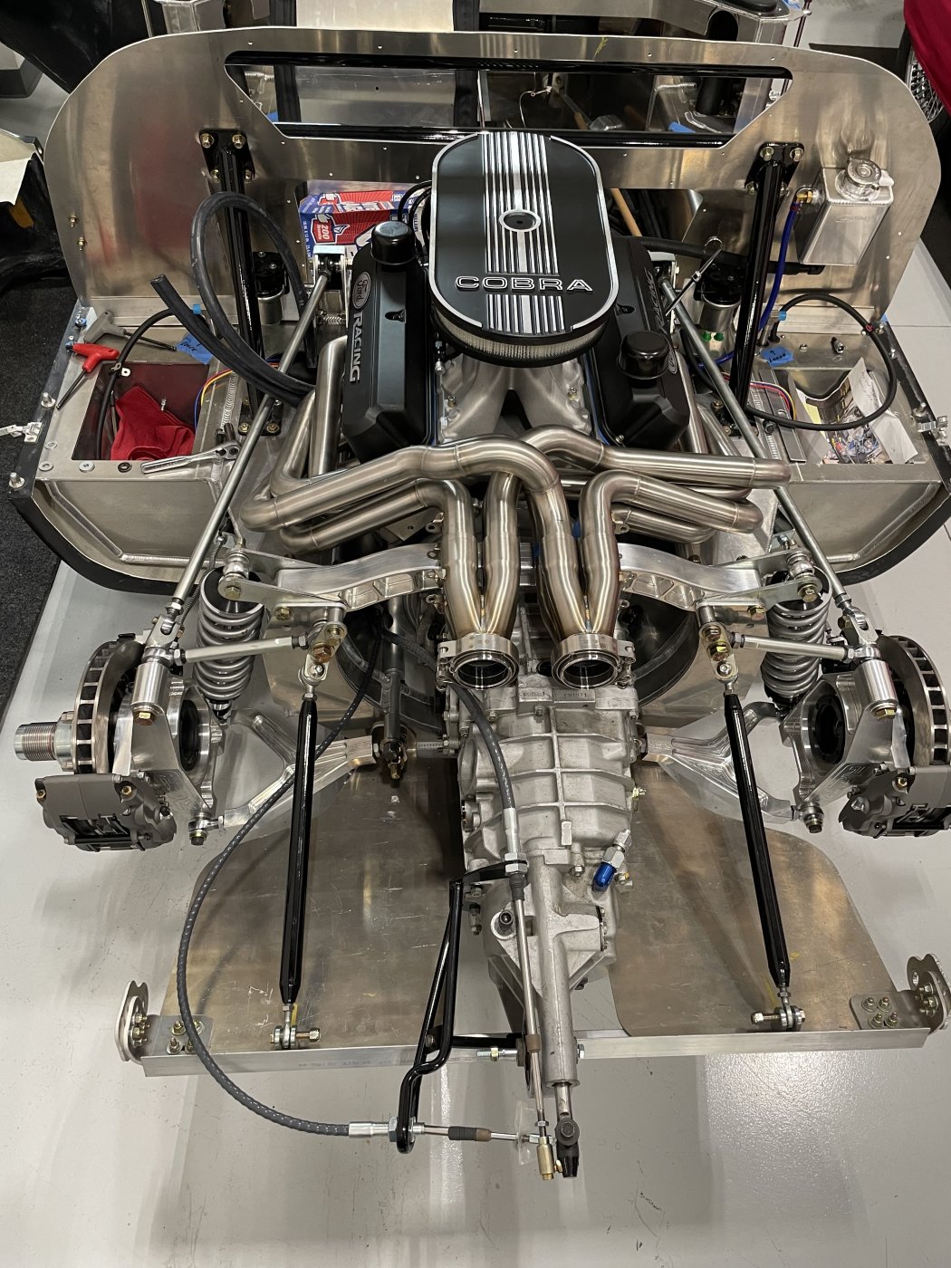

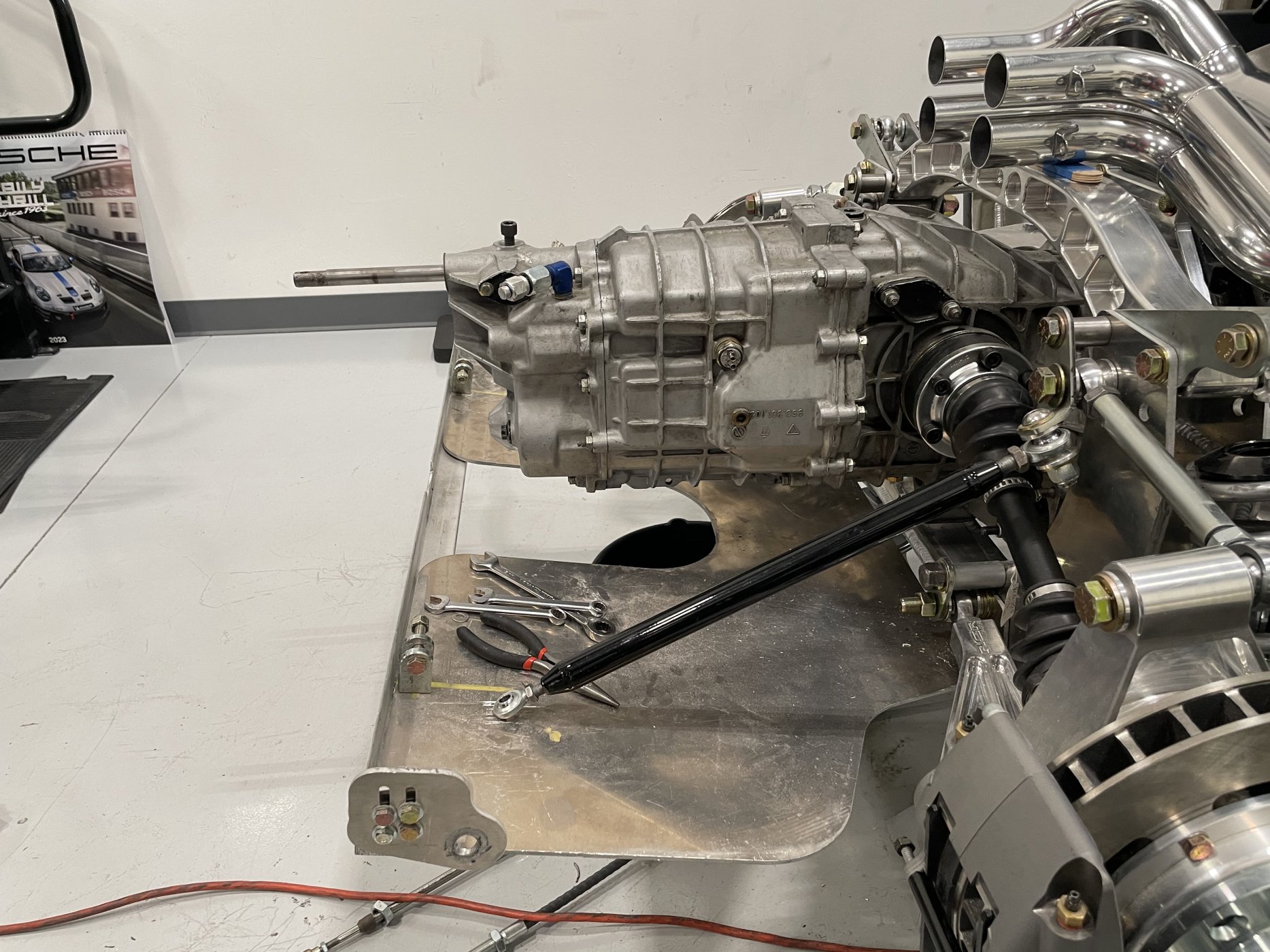

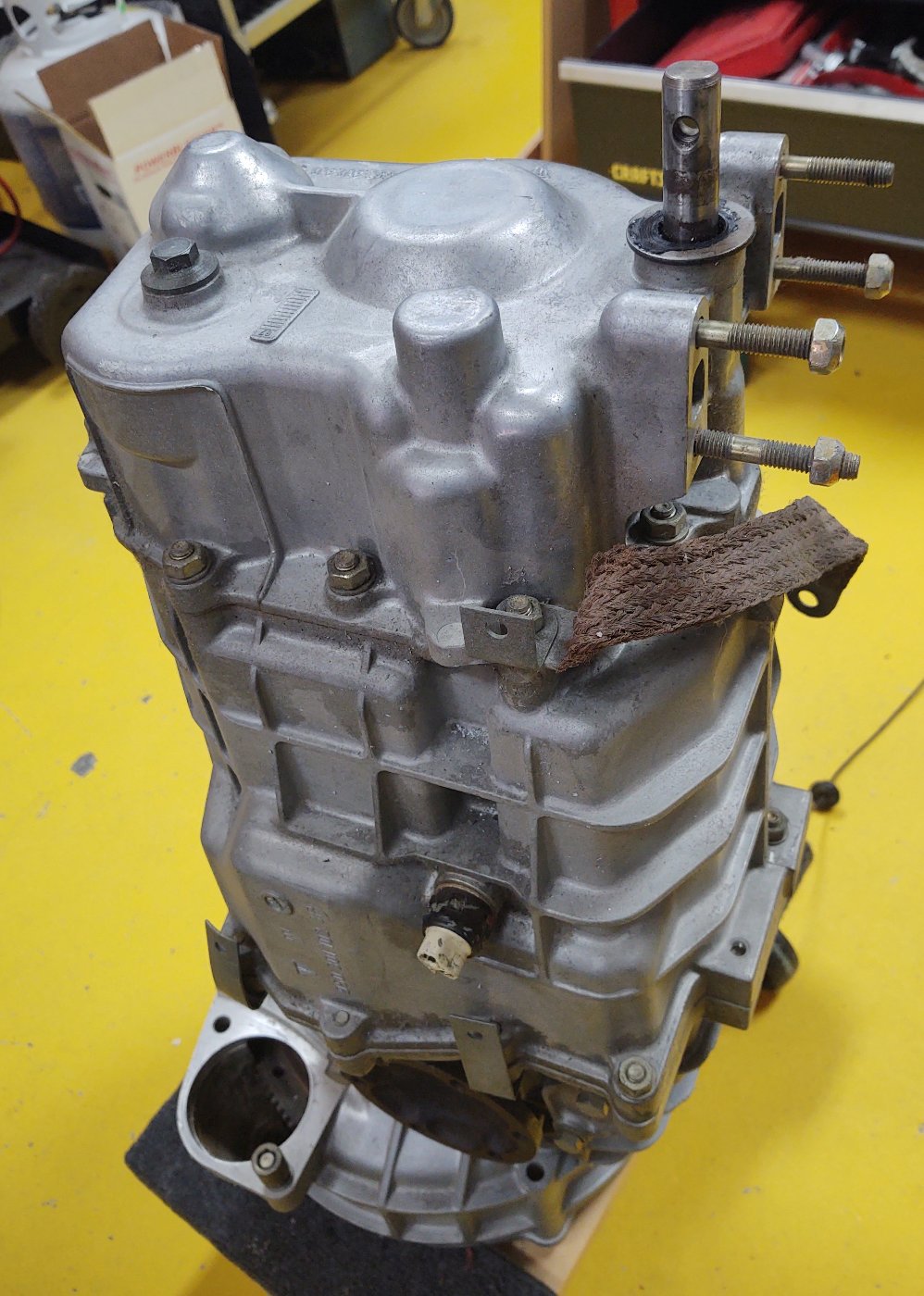

Here is what my transmission looked like at the beginning. It stuck out so far that there was no way the rear clip was going to fit over it.

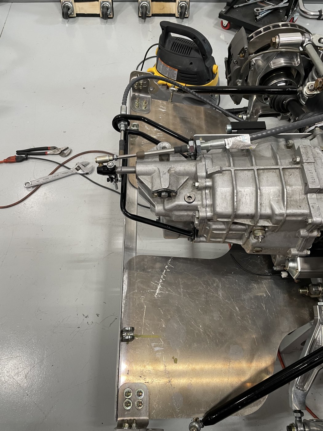

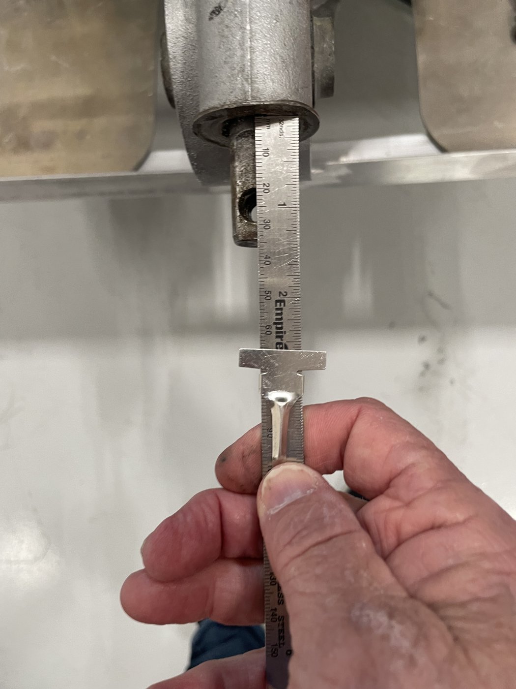

Before removing the cover, I pushed the shift rod all the way forward in the transmission (2nd gear) and measured the length of the rod from the outside of the seal. It measured 1.5" with the center of the hole used to bolt down the shift coupler right at 1". I needed these measurements when it came time to cut the length of the shift rod and drill the hole for the coupler bolt.

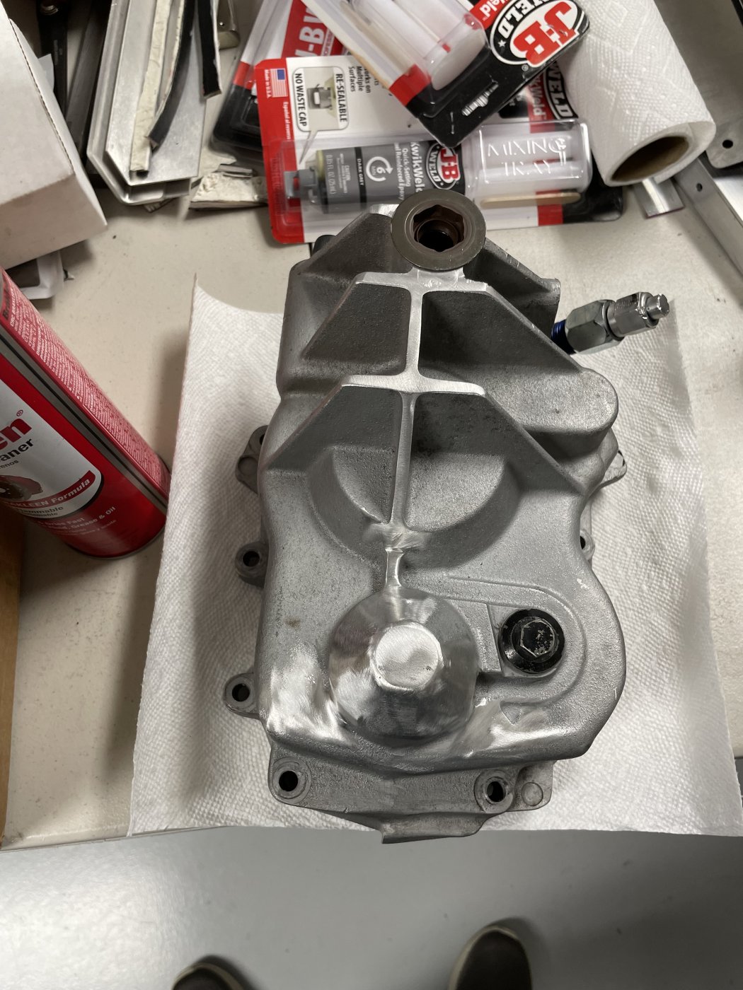

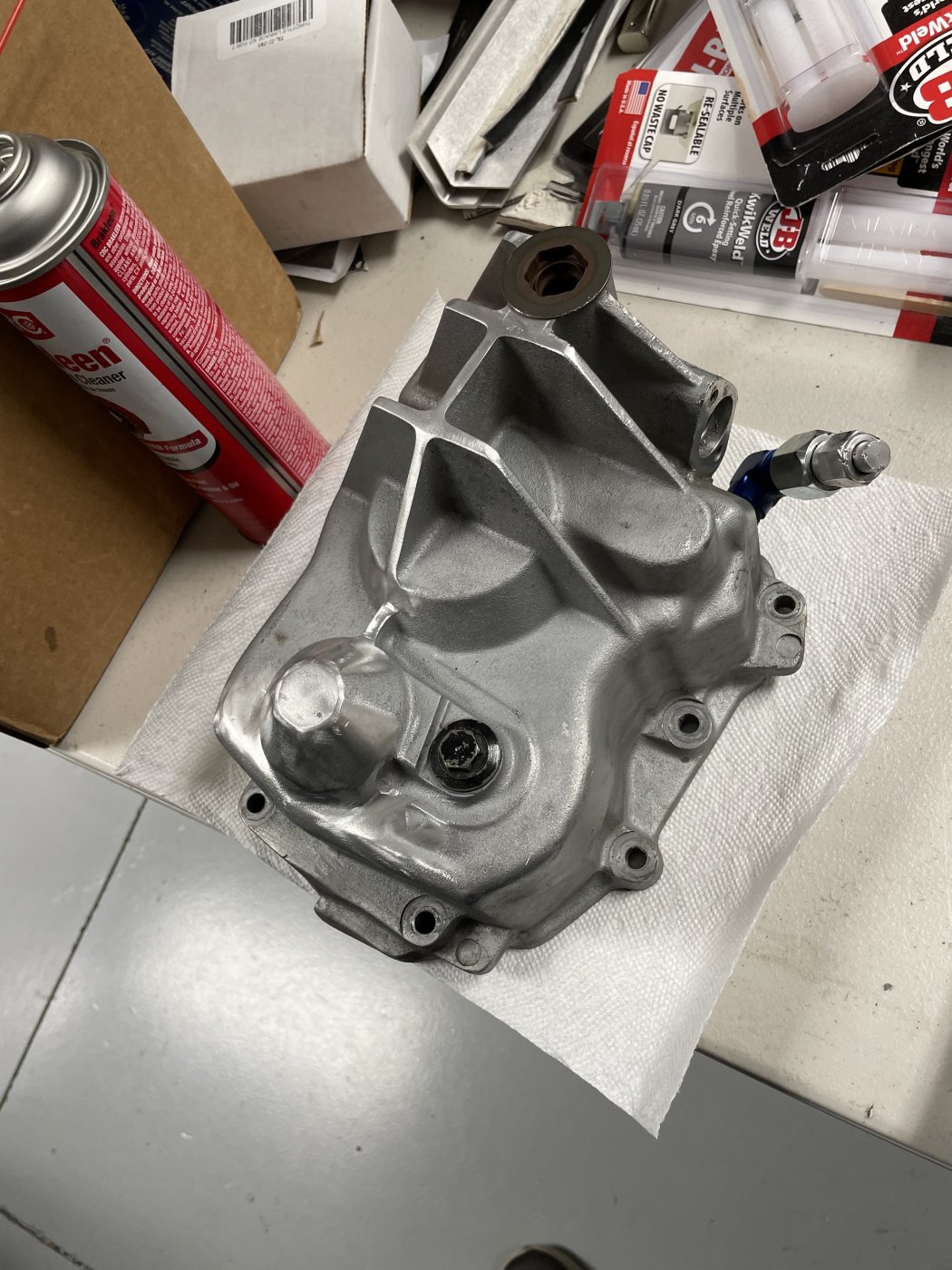

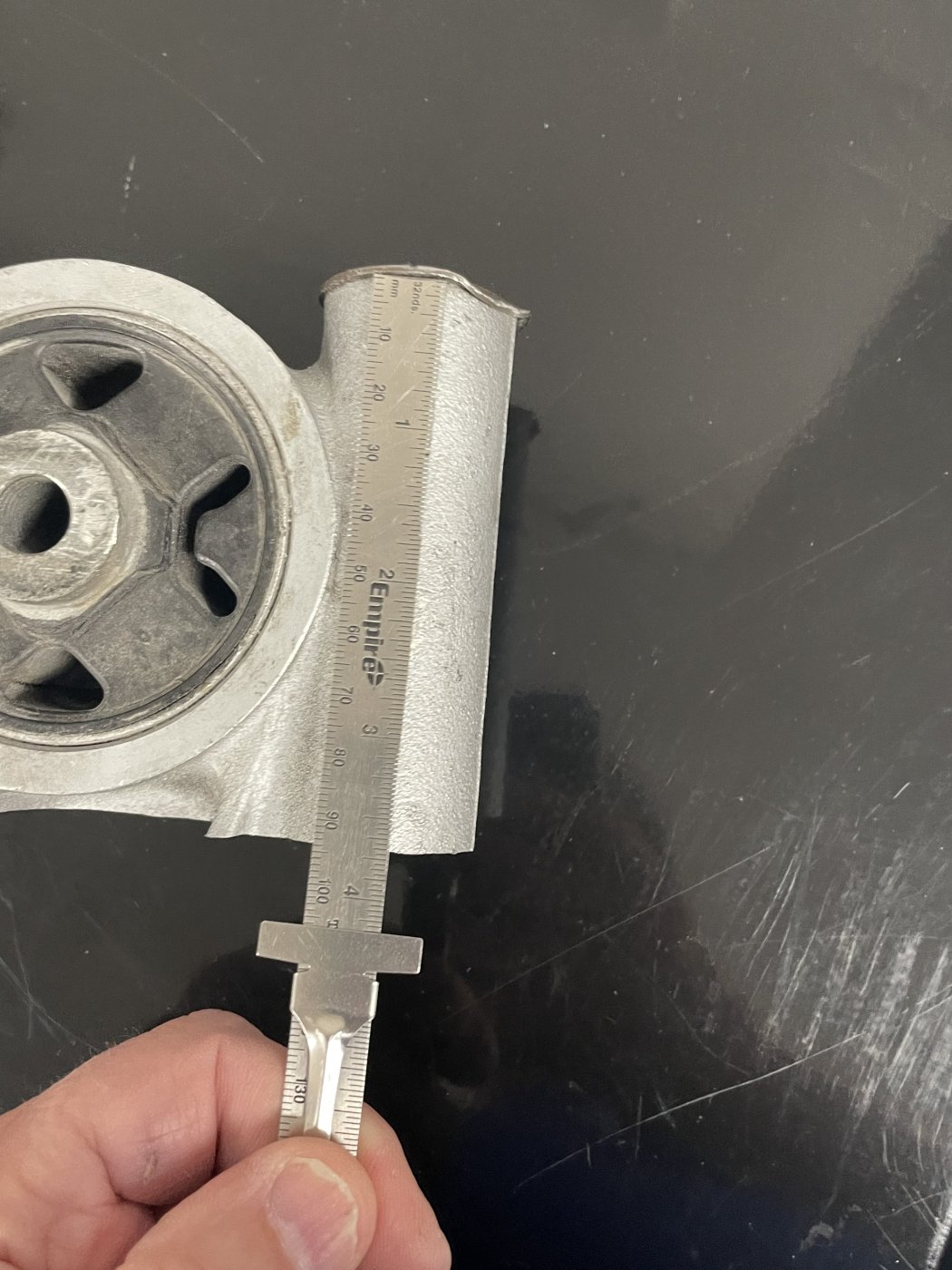

I then removed the rear cover and sent it off to a machine shop along with a new bearing and seal and instructions to cut "around 3.5-4 inches off" making sure that sufficient space existed to mount the bearing and seal as in the original (uncut) cover. Then do the machining and install the new bearing and seal.
Here's what it looked like when I got it back. He did a really great job.
He ended up cutting off approximately 3 3/4 inches:

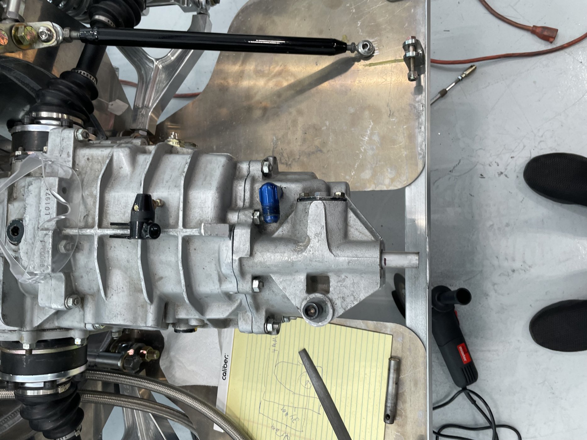

After throughly cleaning out the inside of the cover, and using the correct Porsche gasket, I mounted it back on to my transmission. You can see from the length of the shift shaft how much it's been shortened:

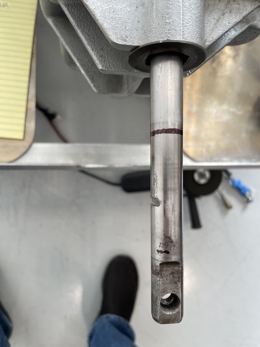

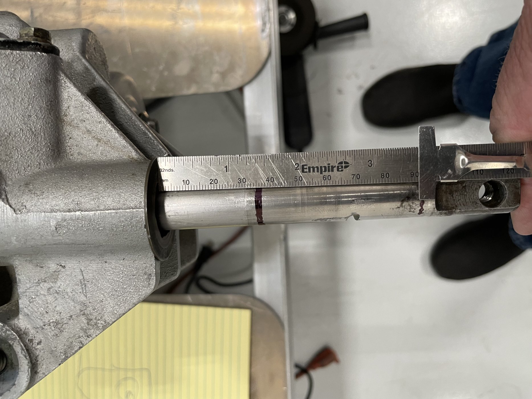

I transferred the measurements I made before removing the cover and marked the shaft for the cut. I think I checked and rechecked this measurement about 100 times!
The deed is done (whew!)....

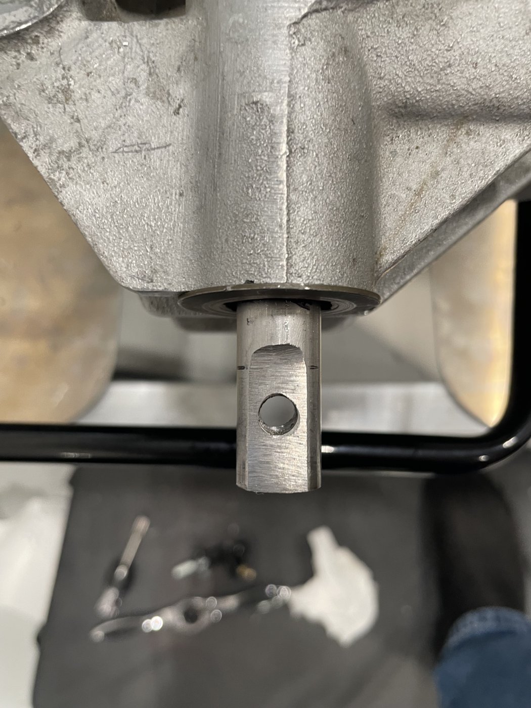

Next I ground down the flat surface needed to drill and mount the shift coupler and then drilled and tapped the hole for the bolt holding the coupler onto the shaft:

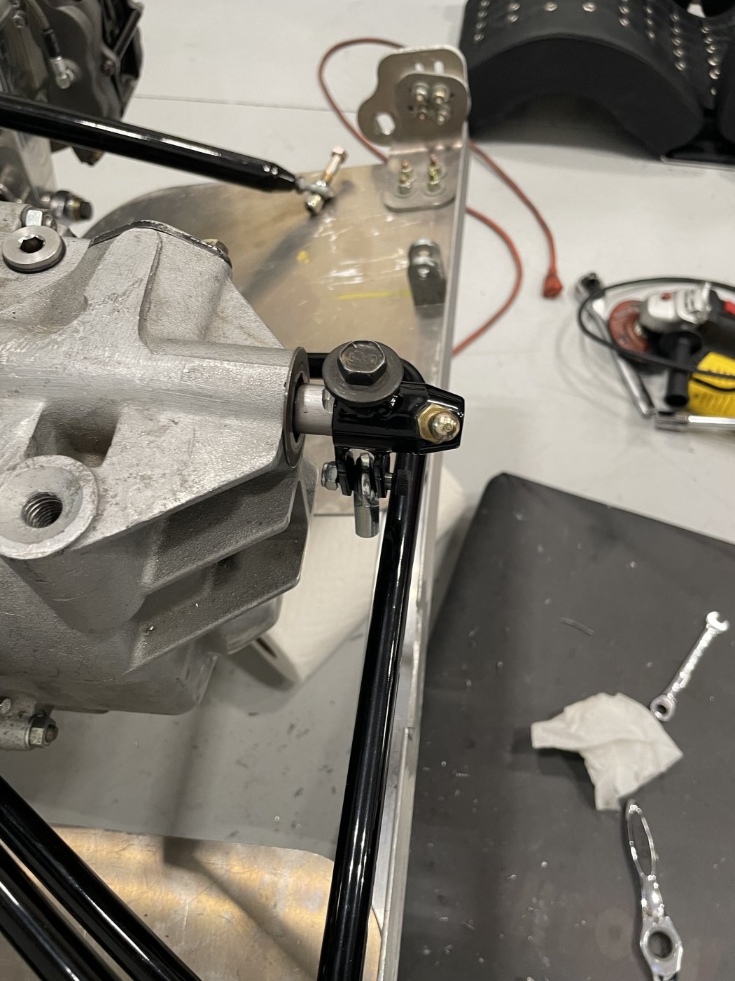

Here it is with the new coupler mounted:

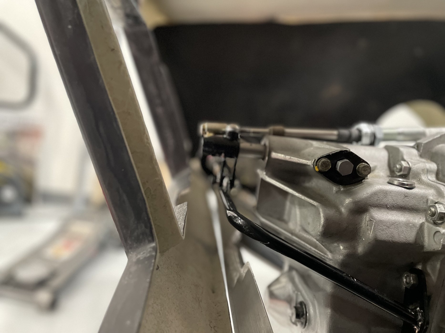

While I was doing this I was in contact with Jim Cunningham with Brandwood Cars. He is the manufacturer of the shift cable brackets that came with the shifter that was supplied with my RCR40 kit. Since the one supplied was for the longer rear cover Jim worked with me via phone, email and text over two or so weeks designing and building the correct bracket I needed for this shortened version of the G50/03. Then he made sure I could swap the cables that came with my RCR40 for the correct shorter ones I needed. I can't say enough good things about Jim, he was extremely helpful, patient and in the end produced a fantastic product. If you are intending to do this same conversion I strongly recommend you reach out to him. I also want to thank everyone on the forum that was willing to answer my questions and make excellent suggestions along the way with a special shout out to Randy, Sean and Bryan. Thanks guys!

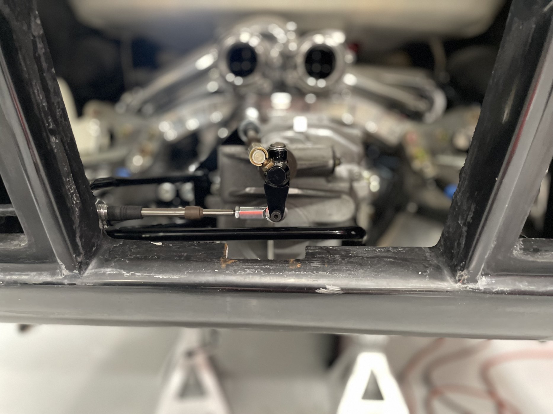

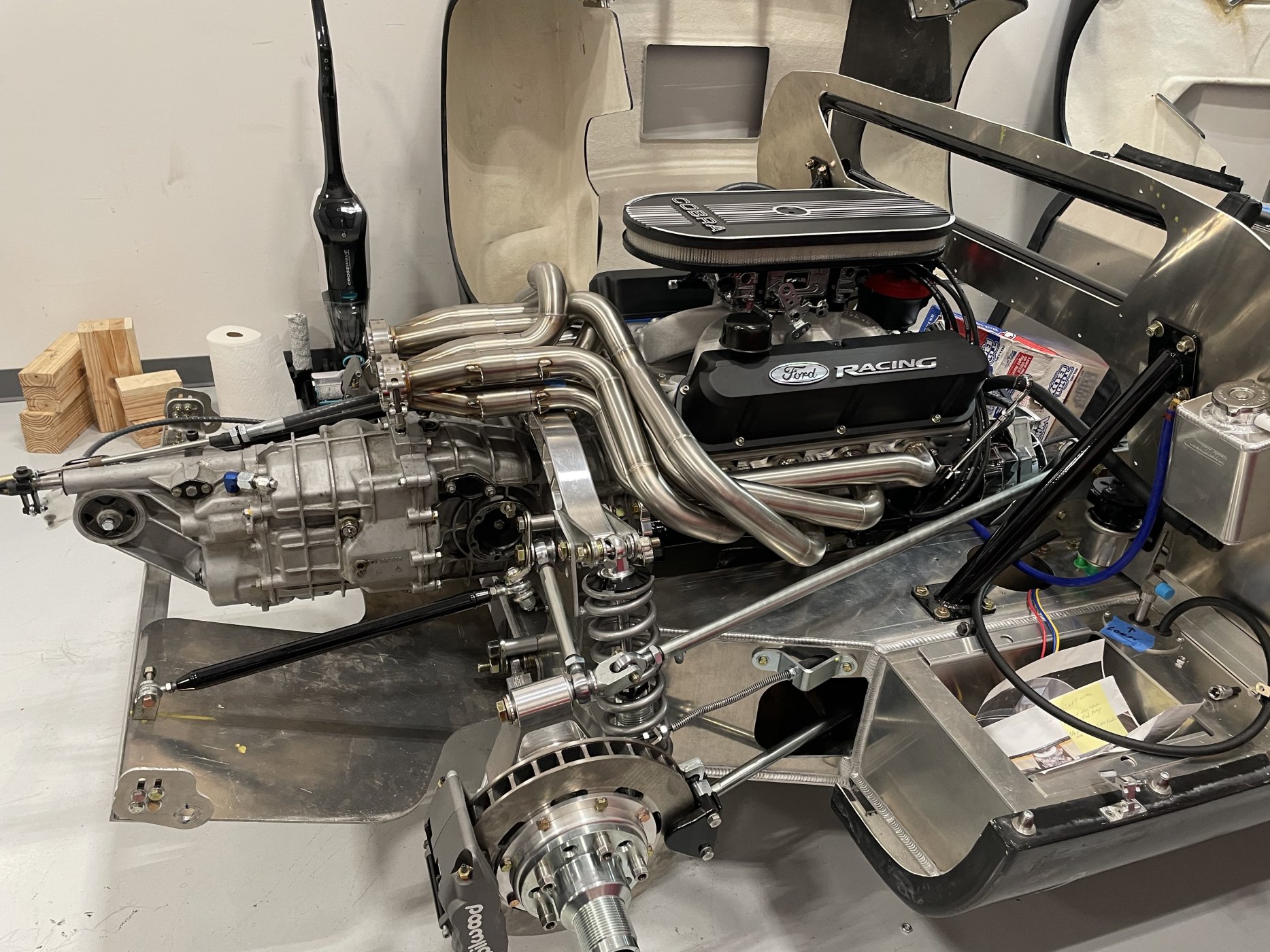

So here is the finished product installed. Everything now fits completely inside of the rear clip and I'm very happy with how everything came out.
Chet

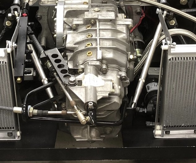

Just for reference, here is the other style G50/01
